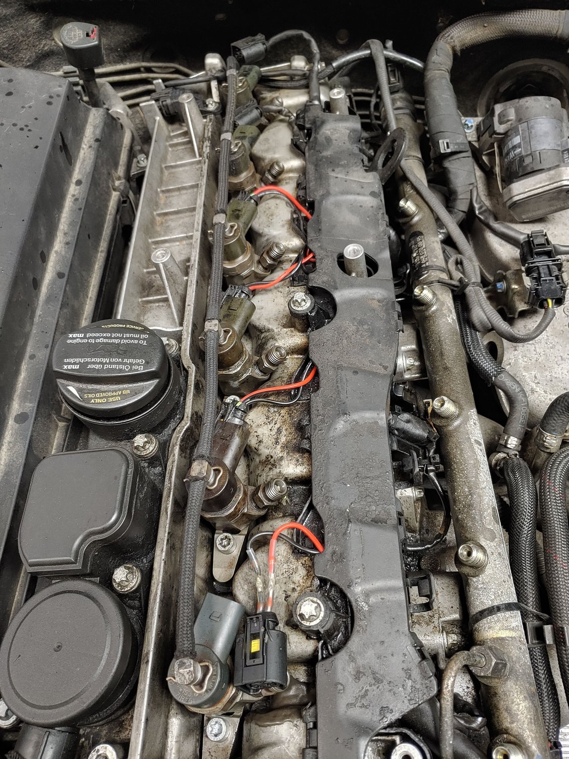

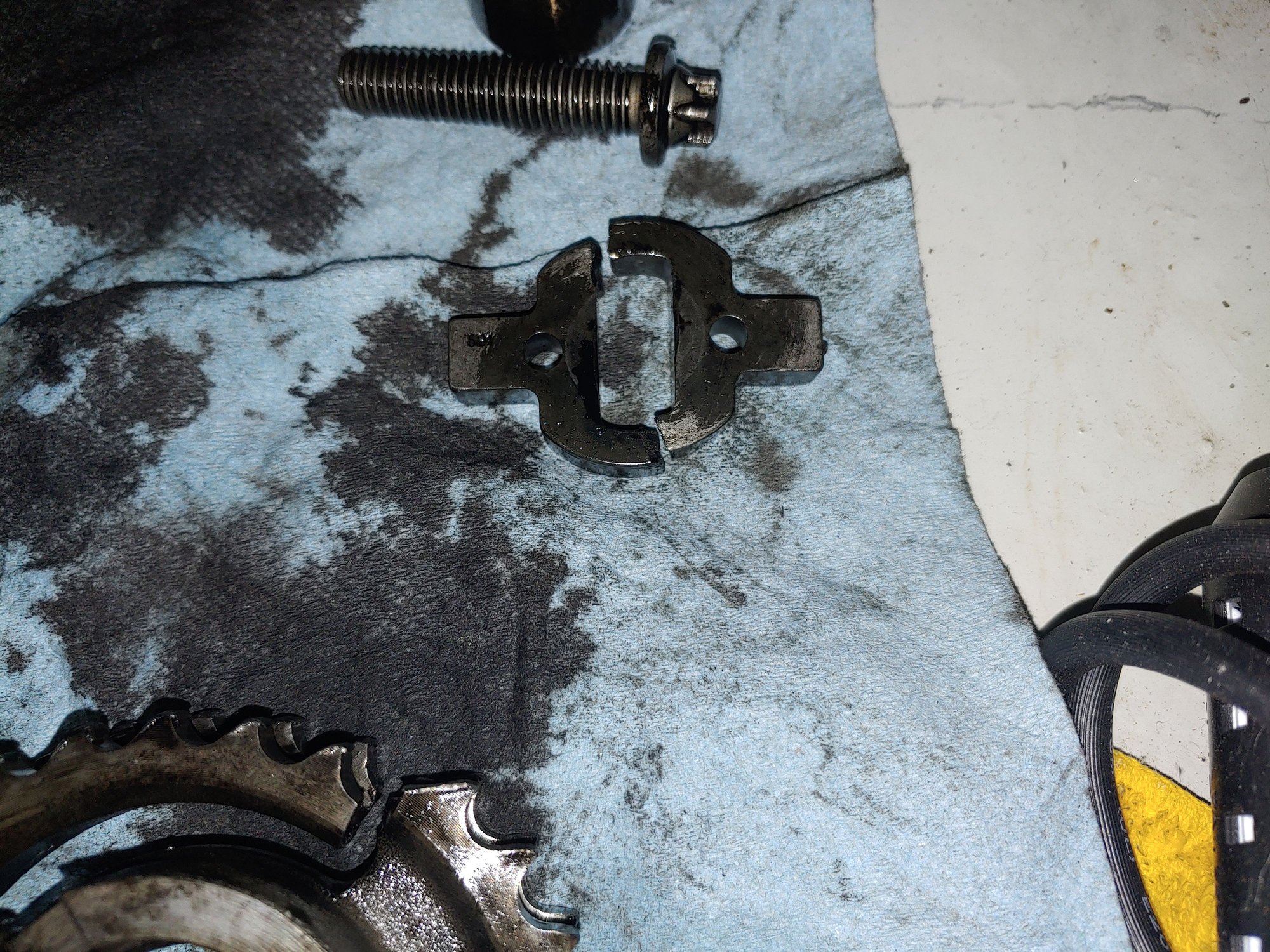

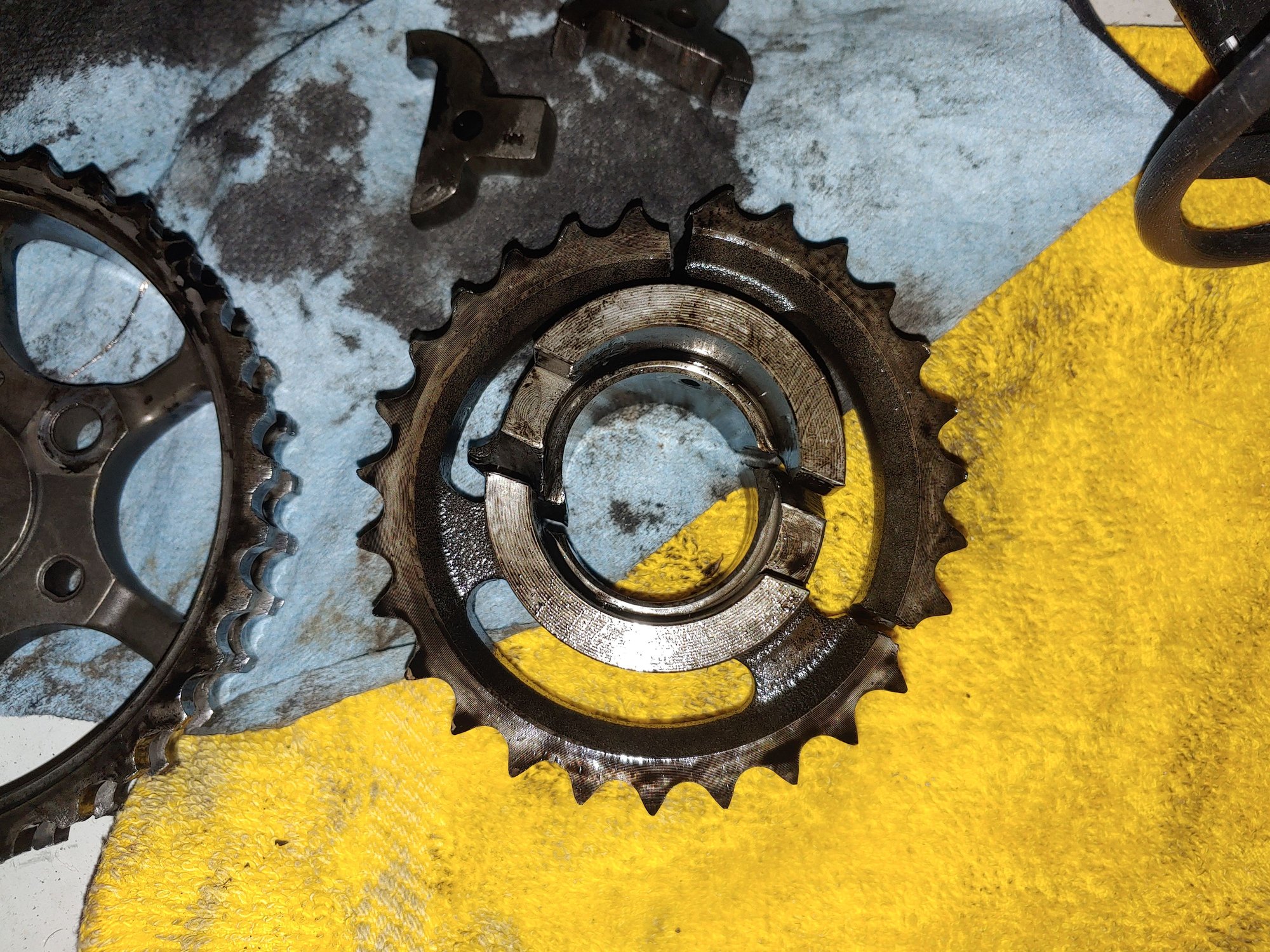

Had a no-start issue. Kept getting a low fuel pressure code took the injection pump off and here's what I found! Has anyone ever dealt with this? Looks like it cracked the drive adapter and gear.
Drive adapter
Chewed up injection pump
Drive gear.

I have seen reports of badly worn adapter and pump shaft, dim memory of one broken gear shaft end.
Lately there was on case in UK forum where bad fuel pump installation caused bent cam shaft

I brought this car (my second one) with a bad case of black death. So bad it had burnt through the injector wires on the first four injectors.
Didn't know if that could cause the pressures to spike and break the drive?

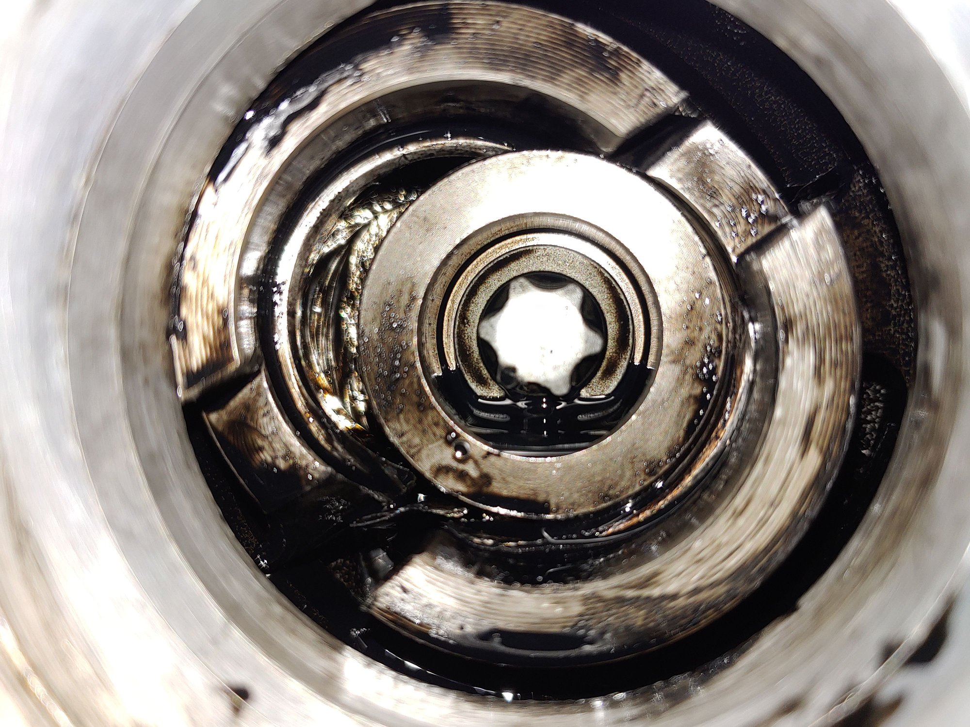

Would also love some info on how to get that gear out!

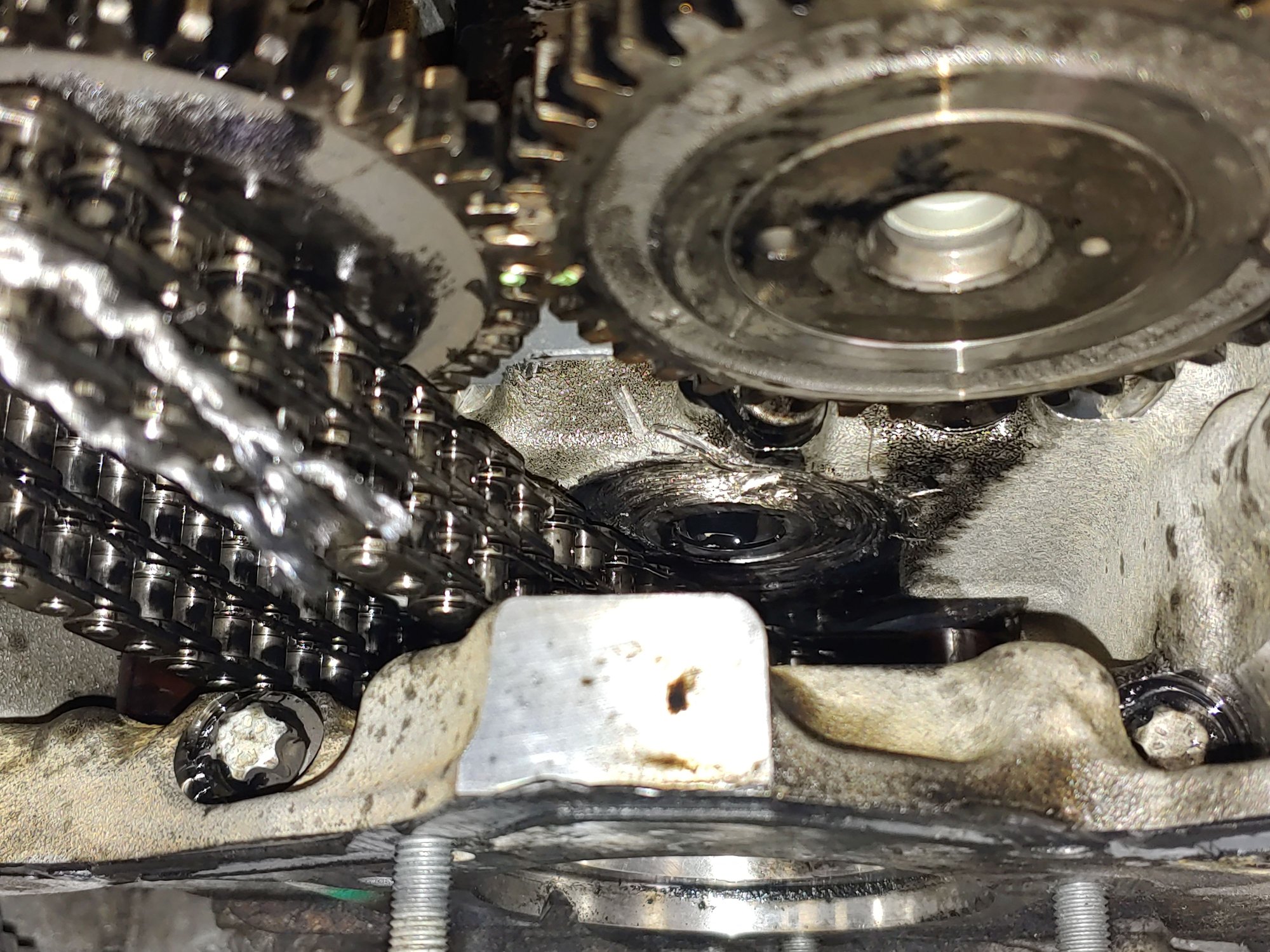

Thank you for the replies! How do you have the wis manual. Although it is a little tricky to muddle through. How to have a good Alltel scanner which is helpful most of the time but I do need to look into a clone SDS! I also found some of Rossafuss post very helpful. I pulled everything apart yesterday and got the necessary Parts ordered.
OM648 Injection pump IItermediate Gear part #646-050-03-05
OM 648 Injection pump follower part# 000-077-23-09
It did scrape at the head a bit 😠

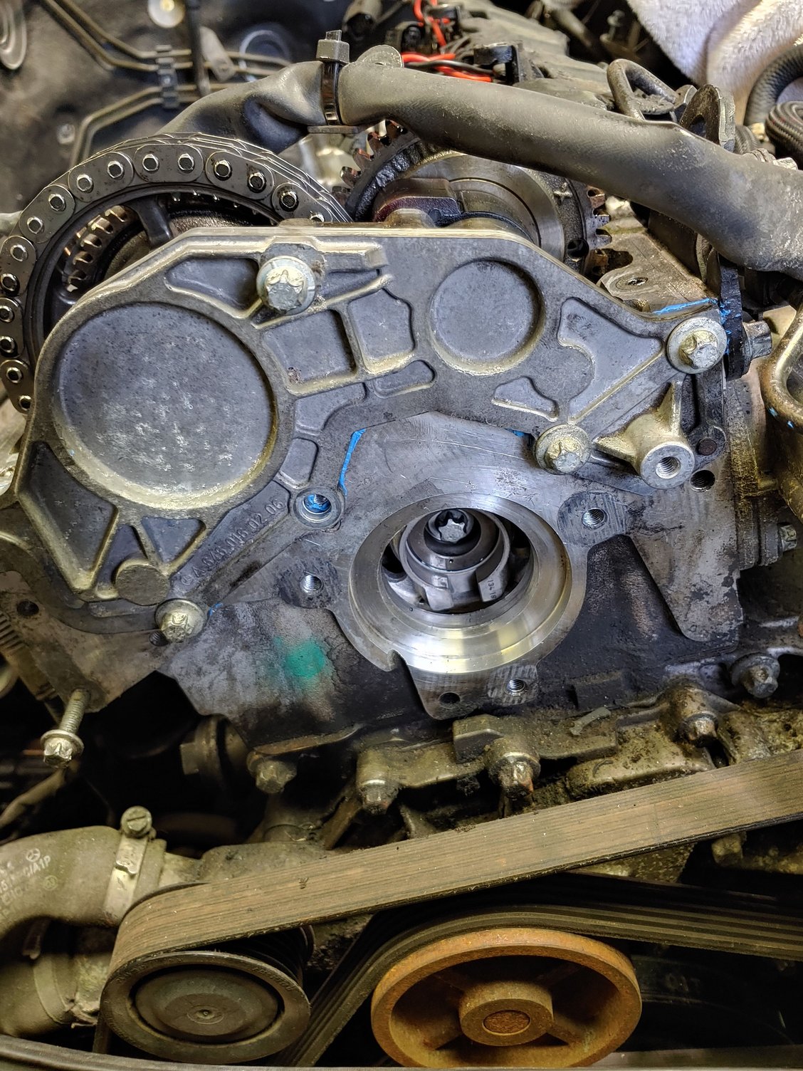

Running!
New gear installed
Back together
Installed the new gear and driver. Reassembled and it started right up! Now I just got to figure out a misfire on cylinder 1 for the first 5 minutes when the engines cold. Thanks so much for the feedback everyone!
