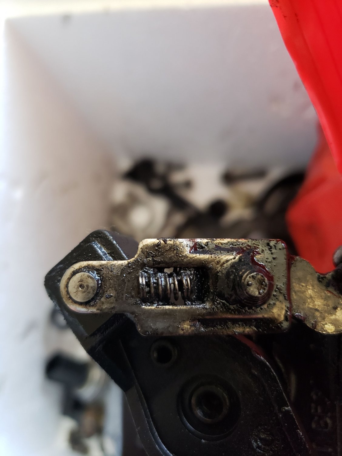

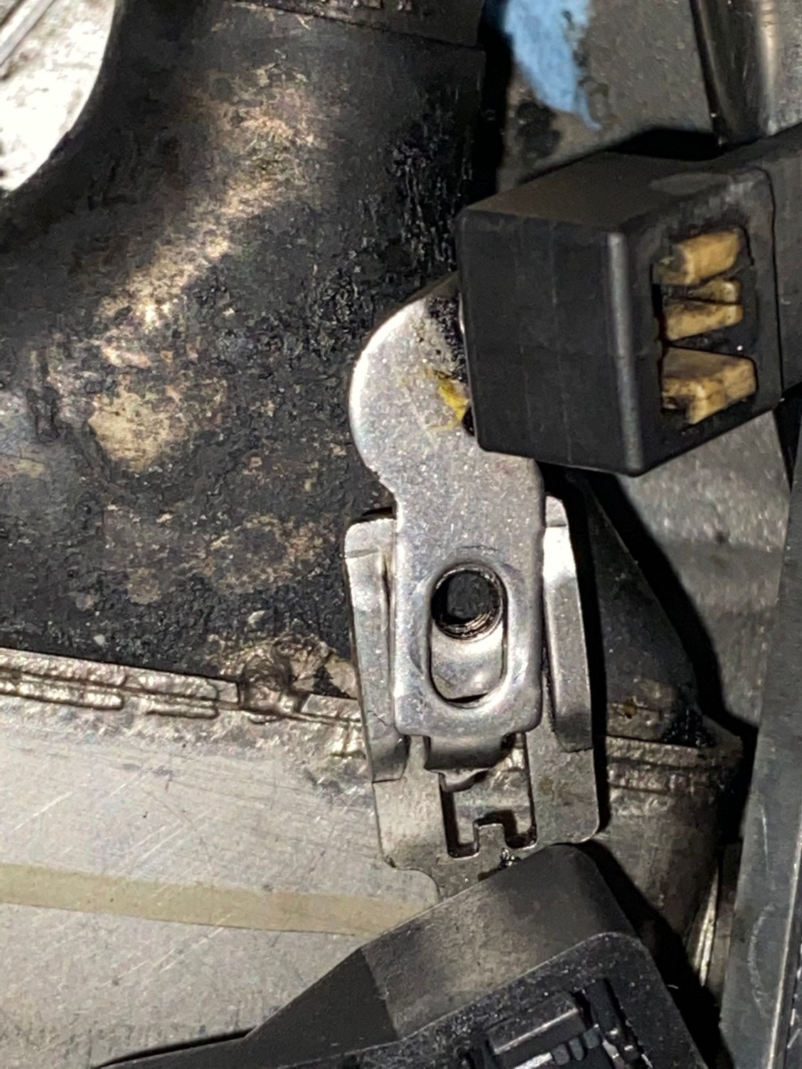

So there a tiny spring that is on the link between the swirl flap motor and the link rod.. I lost it. Can I just put the screw on without this? Or what else can I do besides deleting the swirl flap motor.
No spring example
Example with the spring

Looks to me like rattle-preventing spring. Meaning all you risk is small rattle without it.
Than do you have ballpen with spring inside?

Looks like pen spring will do. Here's a pic of what it looks like

thank you guys but I found it and got it hooked back on! Was a pain but it’s done. Any diagrams For the engine.? Biggest mistake and regret was not being organized.

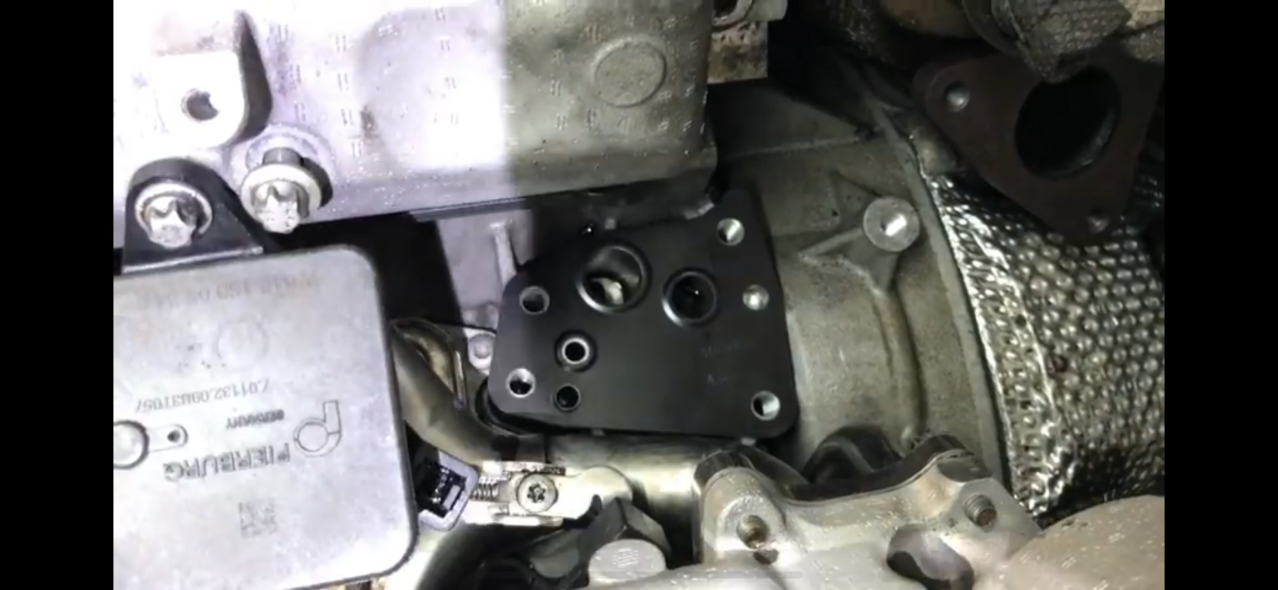

Finally got everything put back.. there a little bit of smoke coming from around my turbo and my turbo is getting really hot. Is that normal?

If the smoke stops within a minute that's nothing to worry about. Usually you will a small amount of oil or such things on the outer side of those parts during reassembly and that's the indication of it burning off. Make sure it's not leaking oil. Did you make sure you didn't touch the turbines during the operation? Also after assembly did you hand spin the turbine to make sure it spins freely with little resistance?

no I did not... I could hear and feel the turbo working though. And yeah I wasn’t sure i saw a little smoke then stopped.
