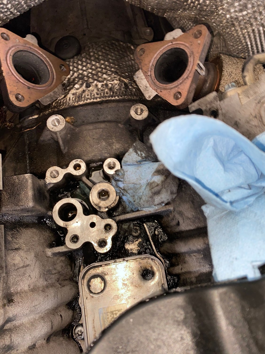

I’ve gotten to the part where I take my turbo out but the bolts connecting it to the exhaust won’t come off or move at all. I’ve sprayed pB blaster and still won’t budge. Any help on how I should take it off? I have an impact gun just won’t fix in the small space.

I used to heat up the bolts first but now I skip that and tend to make my own penetrating oil mixing trany oil with acetone in 50/50 ratio. You apply this from the end of the bolt. If the bolt sticks from the manifold, over an hour it will soak it in. If they dont stick out, I brush it into the hole.
Make sure your socket fits snugly on the head of the bolt. I tend to tap it on with a hammer before applying any torque.
You need a proper tool to do this. The bold head is E12 but most E12 sockets are 3/8" drive. I bought a long 3/8" extendable rachet from Walmart and cracking these bolts open was just so easy with it extended to the longest. When extended all the way, the length becomes about 2ft that's the same as some 1/2" breaker bar. Most 3/8 rachet sold on the market are pretty short. Be ware that those bolts are tightened to 20Nm+90 degree so the final torque is pretty huge, plus the exhaust rust.
hope this helps
Project Farm actually has one video comparing all penetrating oils including your recipe. You can take a look on youtube. The outcome was that the cheapest liquid wrench performed the best over all lol!

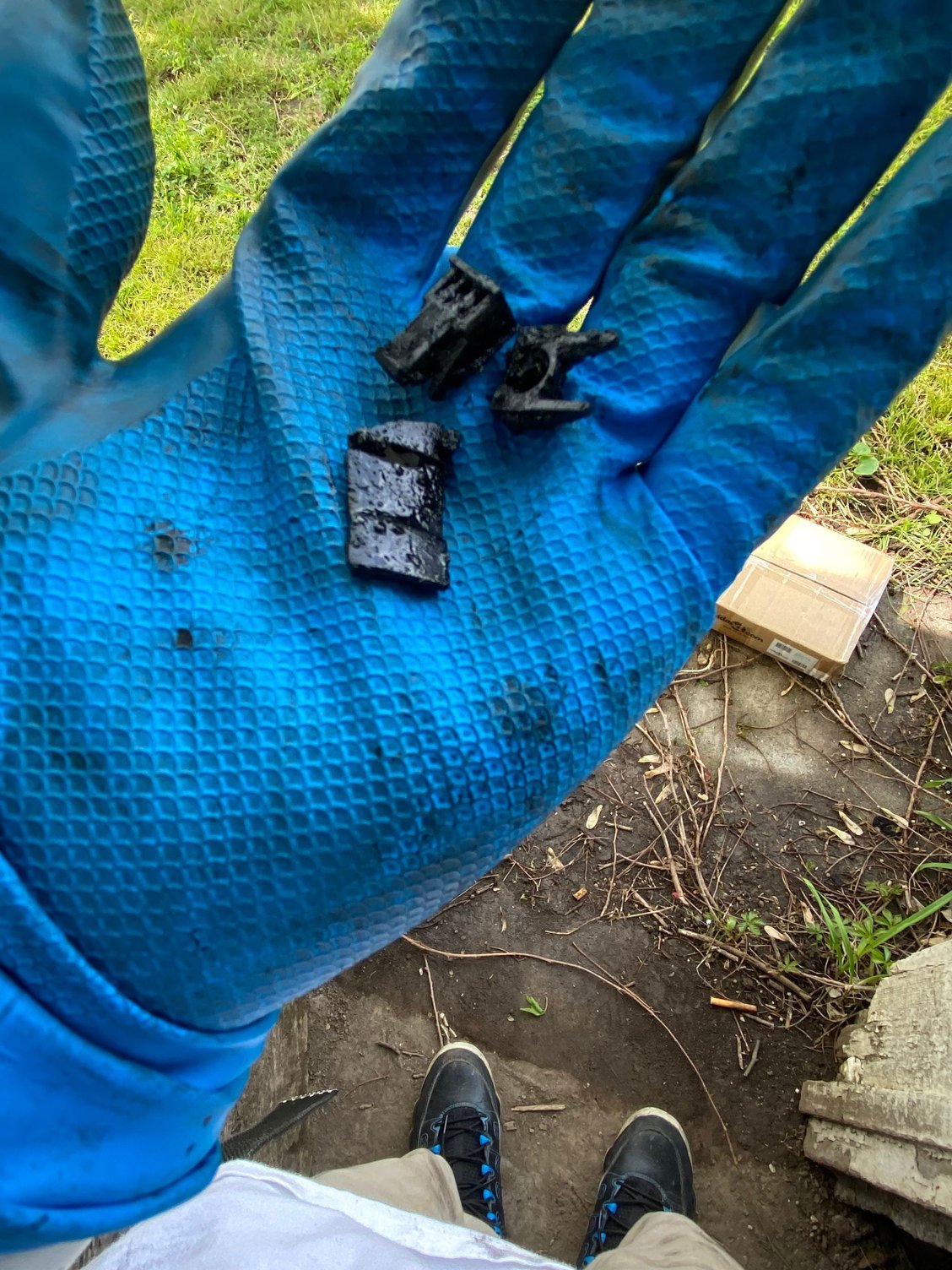

So I was doing some cleaning and I ran into this part can anybody tell me with this belongs to and what it is?
lol this is the part that connects to the flap motor to the rod. It's something you need to replace whenever you take it apart. Get it from your local dealer or an online vendor. You can also delete the swirl flaps.
what does a swirl flap delete do? And ok. I ordered and rod and links so that’s good. Thank you. I thought that’s what it was just had to make sure
Nothing just removes one thing that will cause repair cost. The swirl flaps are there for emission purpose only. The swirl flap motor is something that can fail due to the oil dripping from turbocharger if the seal goes bad, so do those plastic parts you are seeing driving the swirl flaps. As carbon deposit on the flaps it can get jammed that cause damage to those plastic parts. You will see the buildups when you remove the intake manifolds.
If you are replacing the rods, I'd recommend you get the metal rod upgrade. There are many sold on ebay. You just need to figure out if the ones you need are with sensor pickup or without. They are easily distinguishable.
