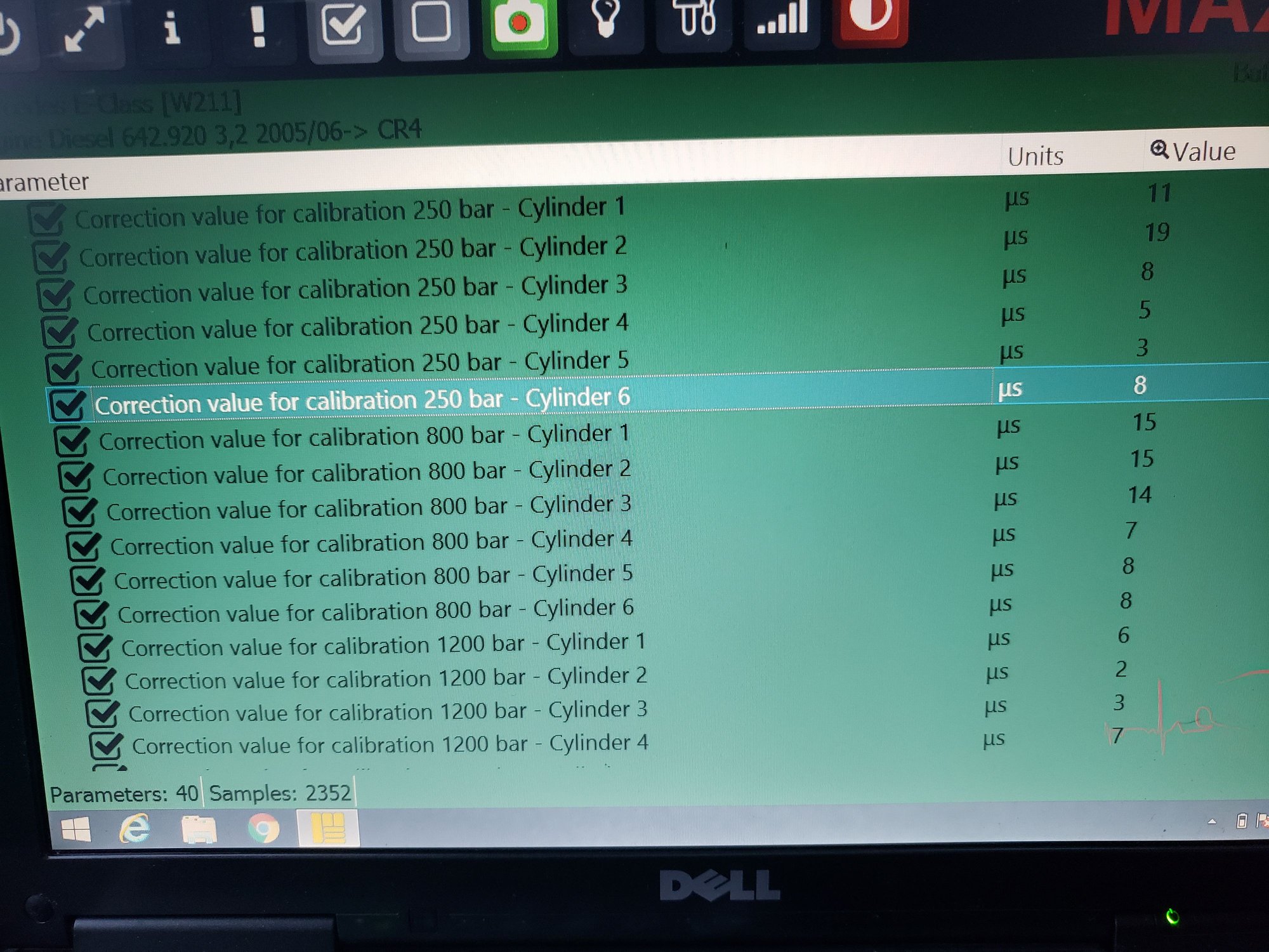

I'm yet to do leak test on my injectors but correction values alone are eye opening? Correction value for calibration Units: micro seconds (µs)
250 bar 800 bar 1200 bar
Inj 1_____11_____15_______6
Inj 2_____19_____15_______2
Inj 3______8_____14_______3
Inj 4______5______7_______7
Inj 5______3______8_______1
Inj 6______8______8_______2
Looks like injector 2 is toast. Not sure what the correction limits are. Perhaps first 3 should be changed?
Those levels are perfectly fine. Once you approach triple digits is when its time to worry.
