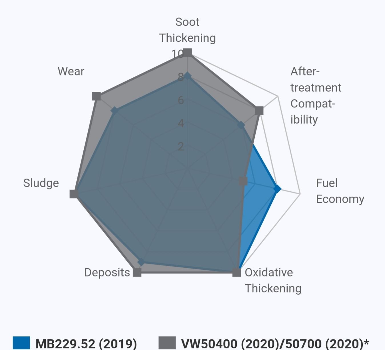

Also don't get hung up on ACEA , API or ILSAC as they are but a smaller part / sometimes tiny part of a manufacturers oil spec performance profile .
With an oil being both MB229.52 and VW 504.00 507.00 it will have a very complete profile as 229.52 is good on fuel economy and 504.00 507.00 has high anti wear because of the VAG Pumpe Duse compromise in camshaft design having narrow lobes placing high loadings on the bucket tappets .
