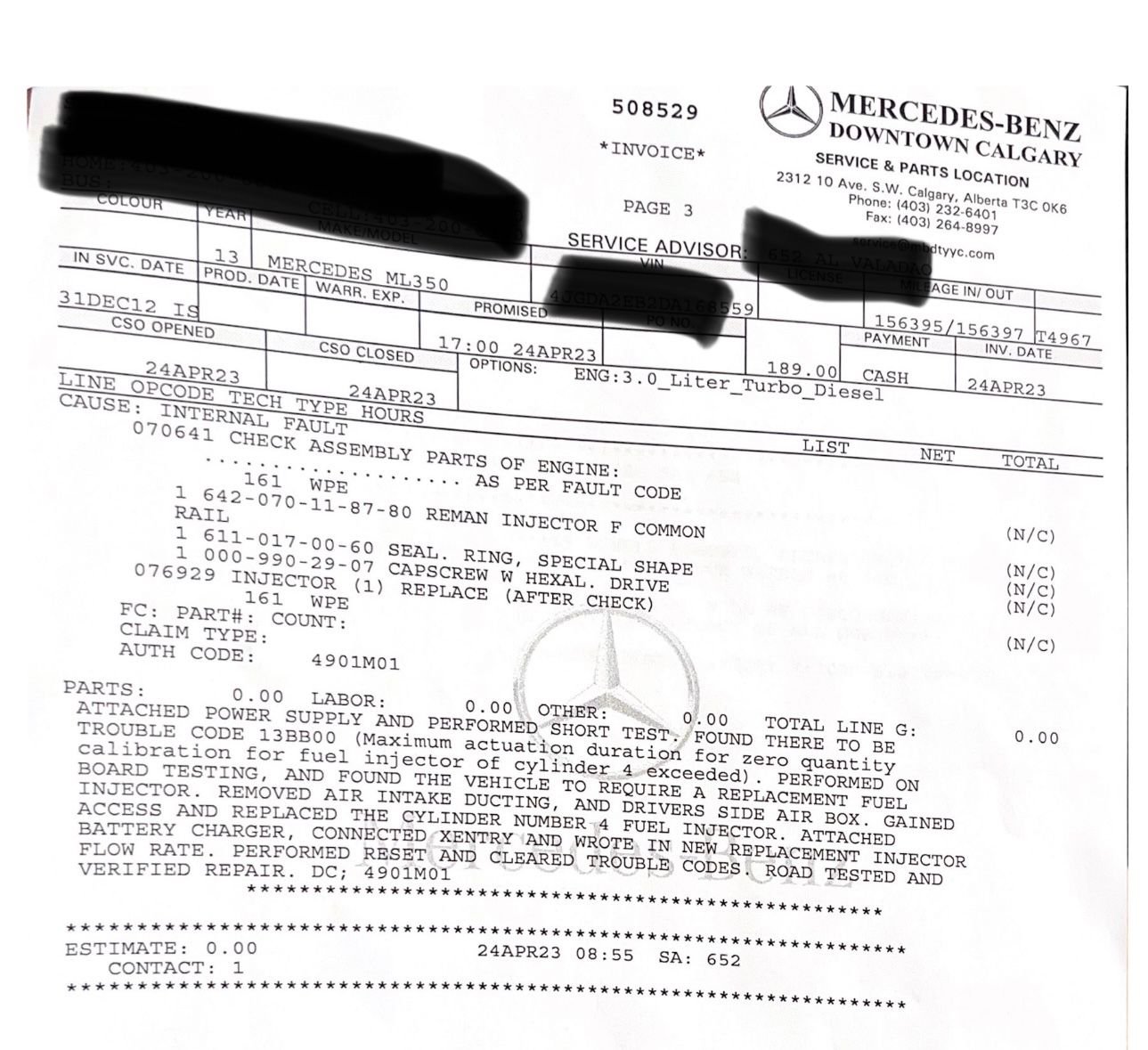

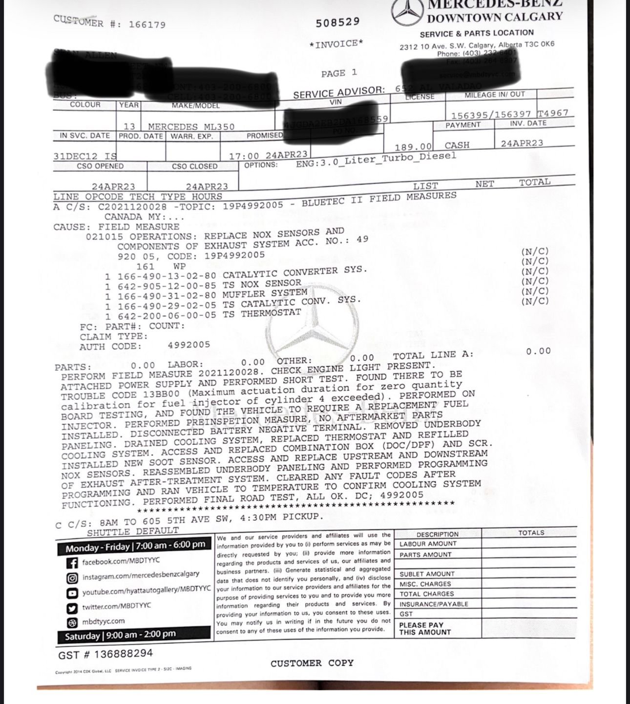

here is the full report from MB that did the field recall

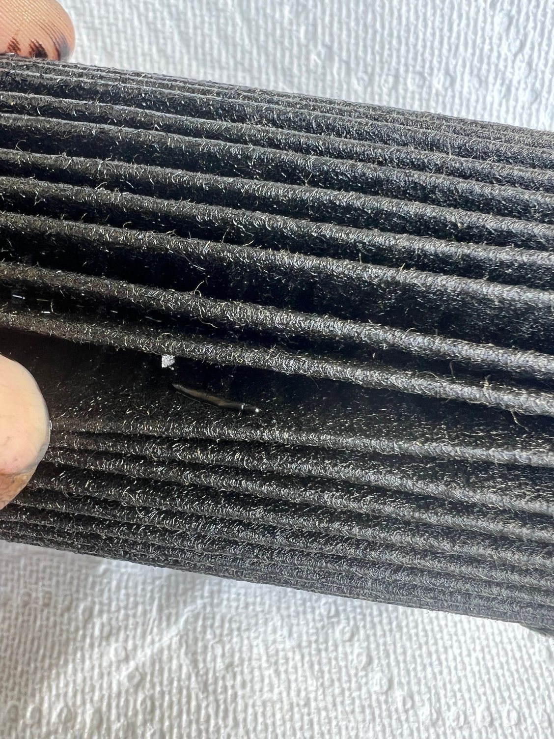

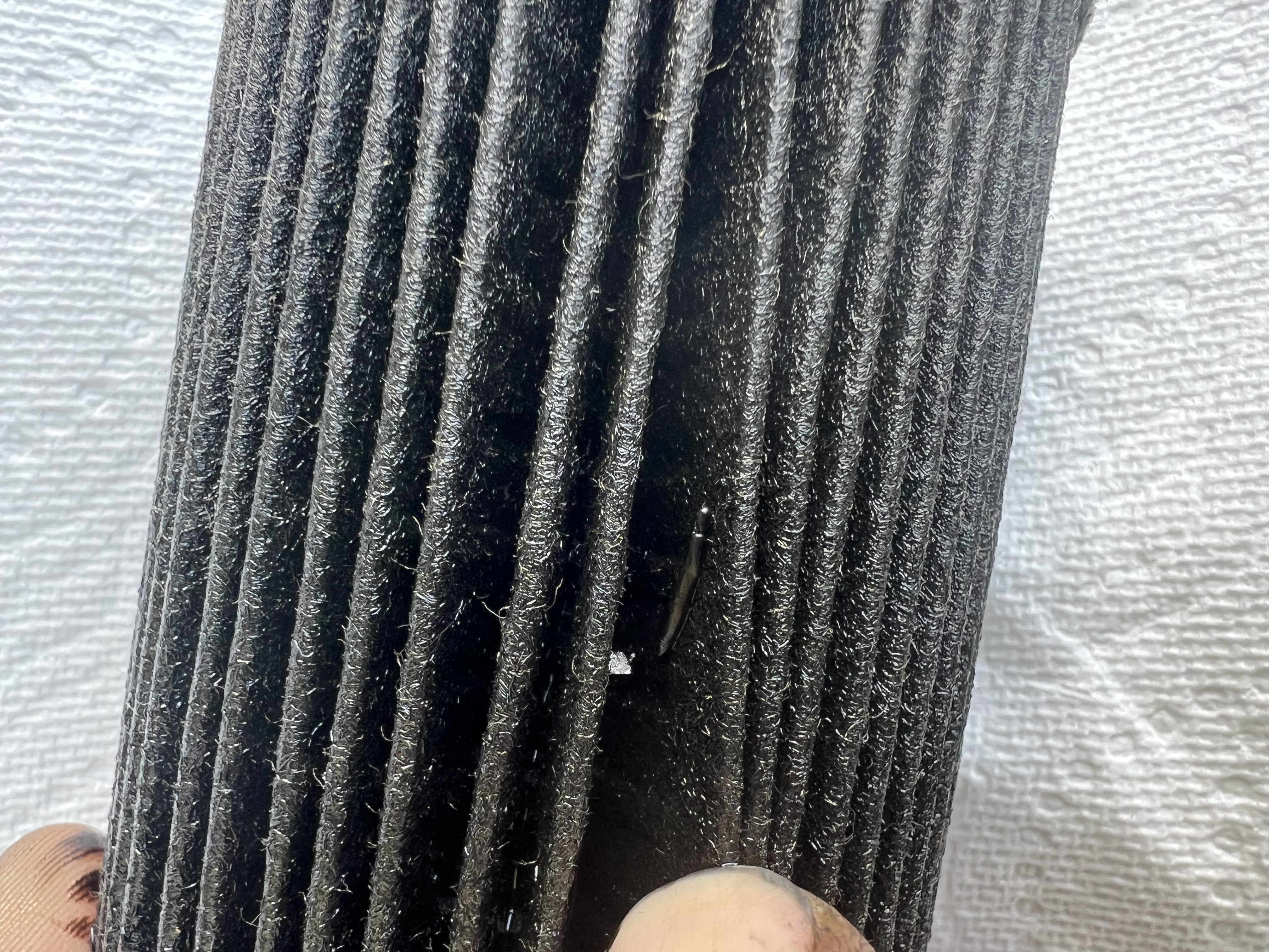

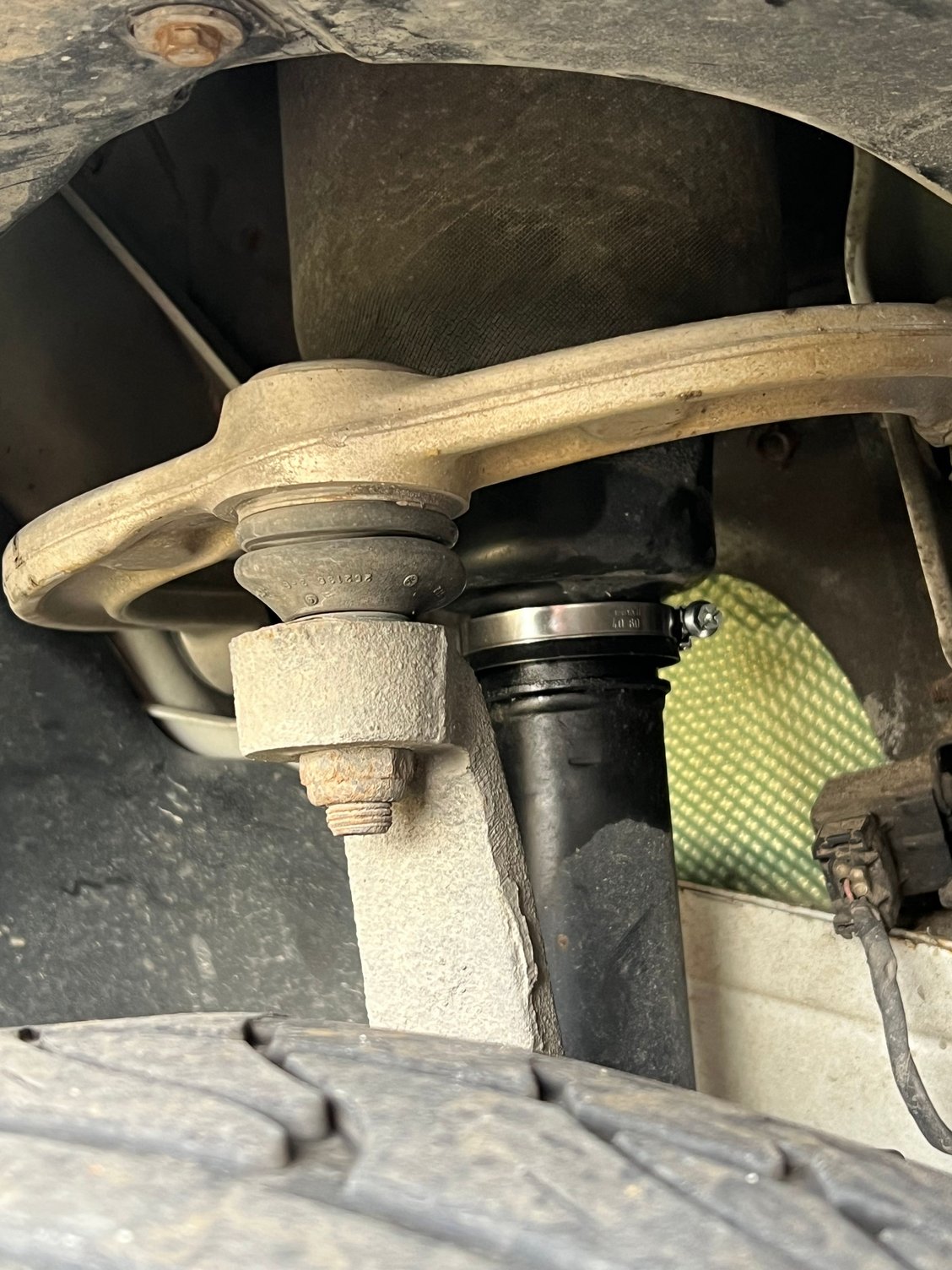

Engine Seized 137KM after Field measures & Timing Chain
Hi, I’m new to this group. Found this thread while searching on Google. Anyways Field measure and Timing chain replaced by MB dealer in Toronto area. 137km later engine Seized on 401. I pulled the oil filter and it’s full of bits of black RTV oil change was done a week before it went to the dealer. Interesting enough I noticed my vehicle now has the pink coolant as someone else here mentioned…. Previously it was blue. Very disappointing. Has anyone had luck getting MB to replace the engine?
How many km were on the engine?

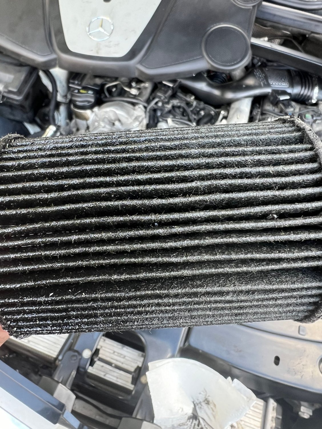

The colour of the oil filter element and the oil on your finger (where you are holding the filter) would suggest that it did a lot more than 137 kilometers from fresh. Something doesn't make sense here.
Old Nov 25, 2023 | 07:37 PM
  #120
there is in fact less than 200km on the oil since it was last changed. This is what oil looks like in a diesel. It doesn’t look brand new it goes black rather quickly. I personally changed the oil and filter a week before it went to Mercedes at the beginning of November they had the car for 3 weeks.
I am aware that it turns black considerably faster than in a gasoline engine, but not that fast. If it turned black in 137km, you very likely had other issues. And, they performed the AEM and replaced the timing chain without replacing the oil?

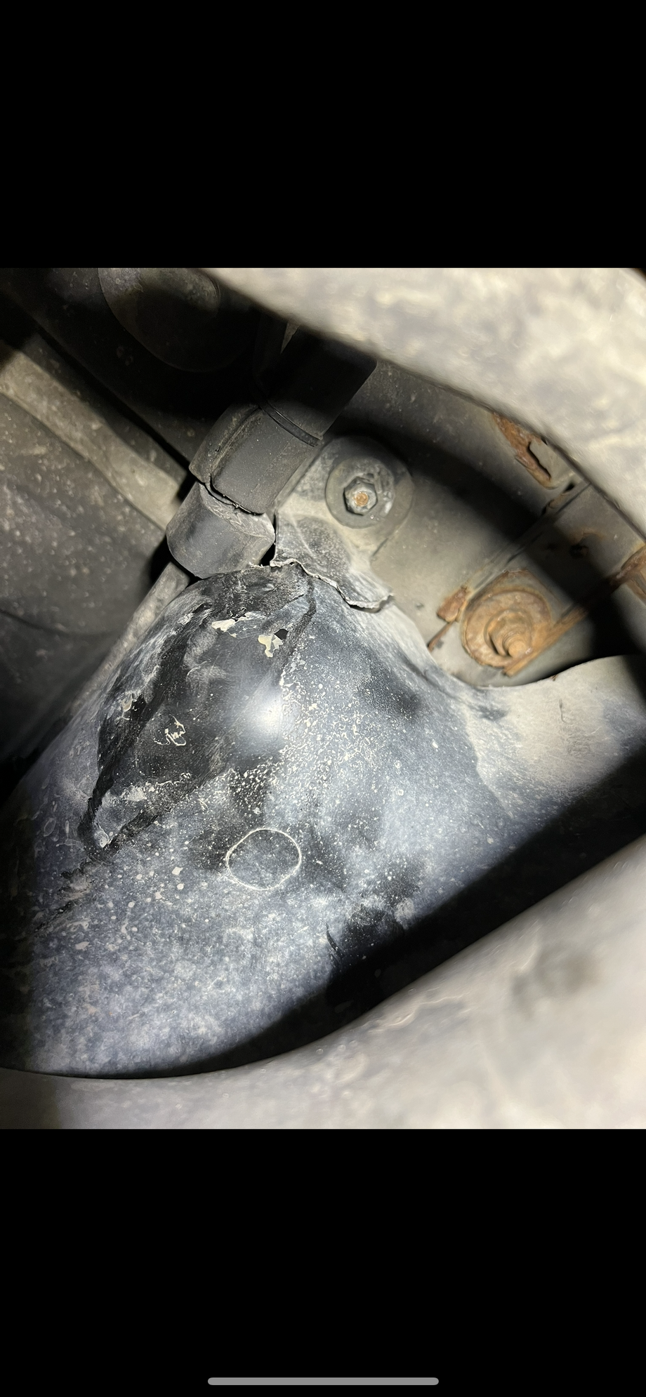

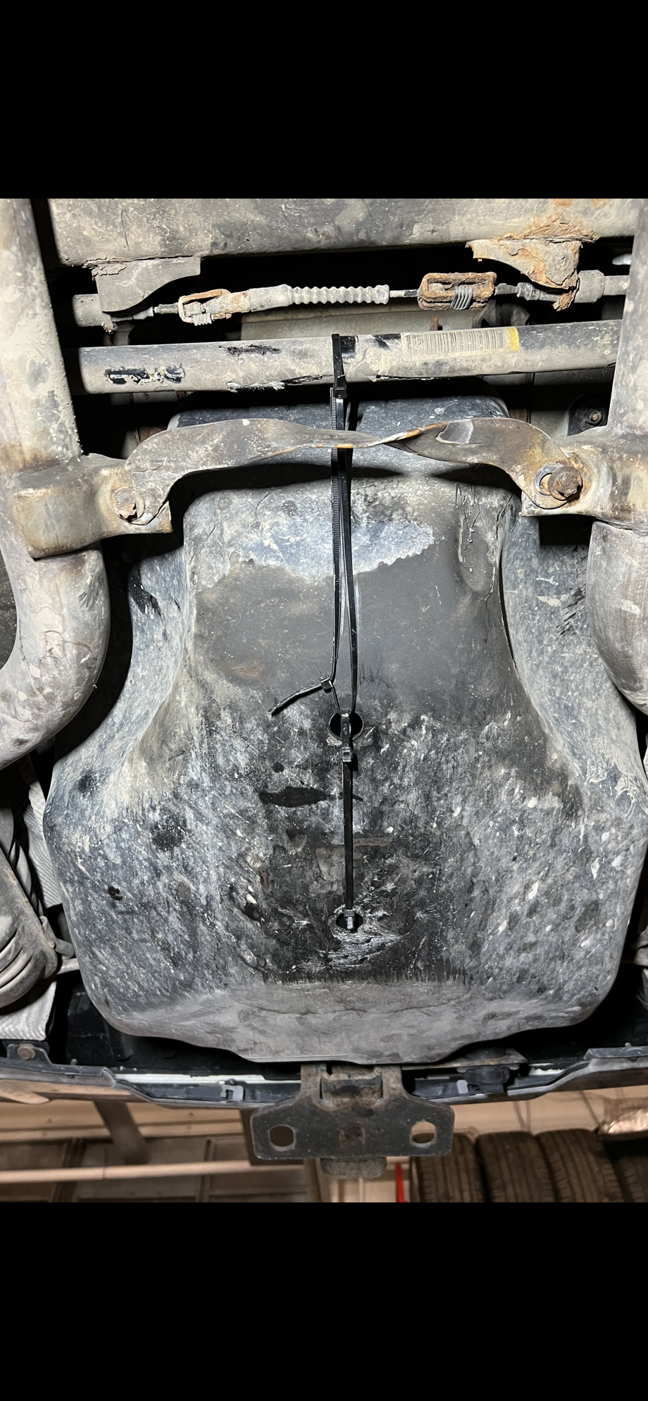

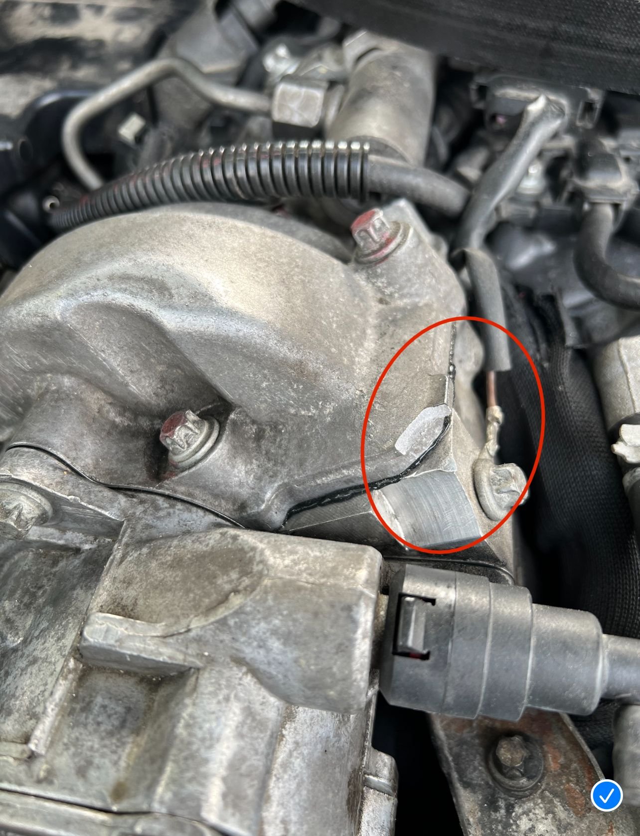

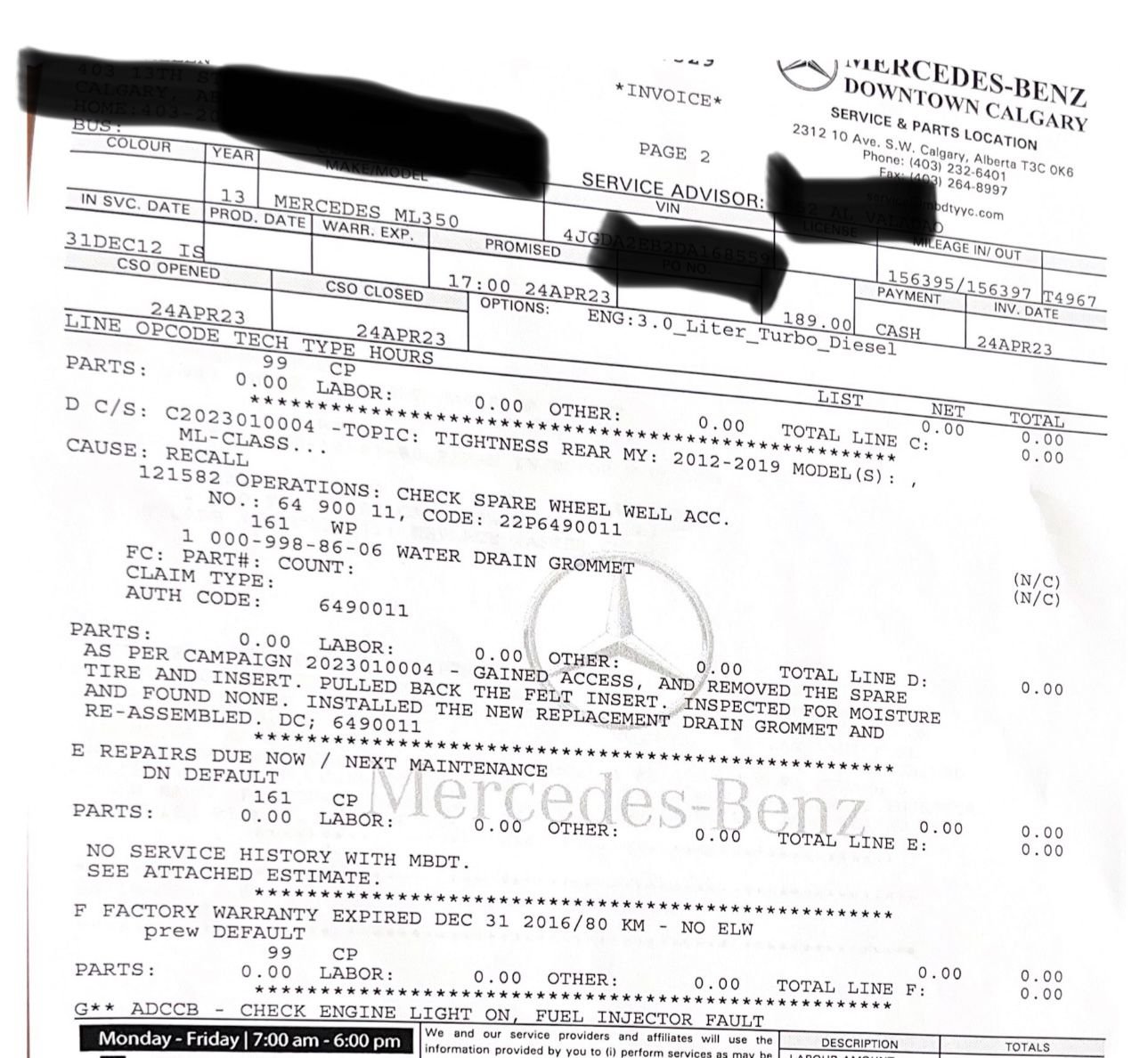

correct they performed AEM and Timing chain. No record of oil being changed. I spoke to a 15 year MB tech in the USA and he said they are suppose to change the oil. Also they damaged the valve cover damaged the adblue tank cover and zip tied it to the swaybar. The broke the rear wiper and ripped the lower rear trim off in the Carwash and promised to fix it and never did. Paperwork only says 1 qty G40 (pink) antifreeze. In order to swap blue to pink you’re required to flush the whole system. Looks like they just topped off because again no coolant flush documented. I think I got an incompetent tech on my vehicle. They also blew my air strut seal and tried to put a hose clamp around the bottom of the bag and returned my GL completely deflated on all 4 corners and said we tried everything we can’t raise you need 11k worth of suspension…I raised it In Less than 1hr after towing it back home. Yes this was a Mercedes Benz dealership…I wish I was making this up because now I’m stuck dealing with this bull****.
Old Nov 25, 2023 | 10:36 PM
More photos to back up what I mentioned above. This MB dealer has been an absolute nightmare. I have a case opened with MB Canada with no response for past 2 weeks. On Friday after I learned she was locked up I emailed the CEO hoping an assistant could escalate and sure enough the executive assistant replied and she is escalating this for me.
