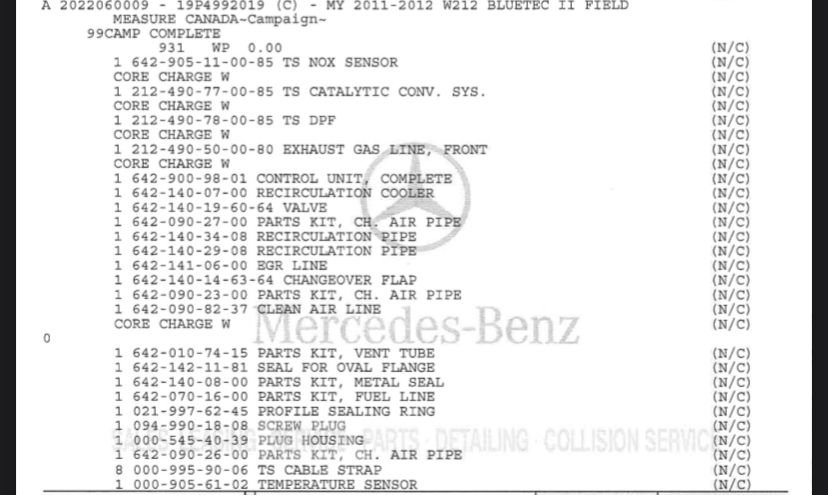

Has anyone here done AEM on an E350 in Canada? I'm curious if your intakes were replaced or they just cleaned them and installed a repair kit.
I just had it done, and yes brand new intakes on 12 E350. Oakville Benz did it.
The car runs great, no regrets (its been about 1500km) since.
Can take a photo of the parts list that were replaced? I'm curious if it matches to mine. I posted it here
https://mbworld.org/forums/diesel-fo...ml#post8700682
Also, were you able to submit a claim. Seems like their website is broken and doesn't accept dates in 2023. Sent them an email, hopefully it gets fixed.
Yes it matches, the kit is replacement intakes.
same with Nox sensors, shows one but the kit has 2 sensors.
I submitted a claim right before new years.
Its funny, I removed intakes myself and had them cleaned this past summer, it was ALOT of work.. Few months later they do it all over again.
IIRC it depends on the year. A 2012 gets tons of new stuff including intakes. Later years do not.
