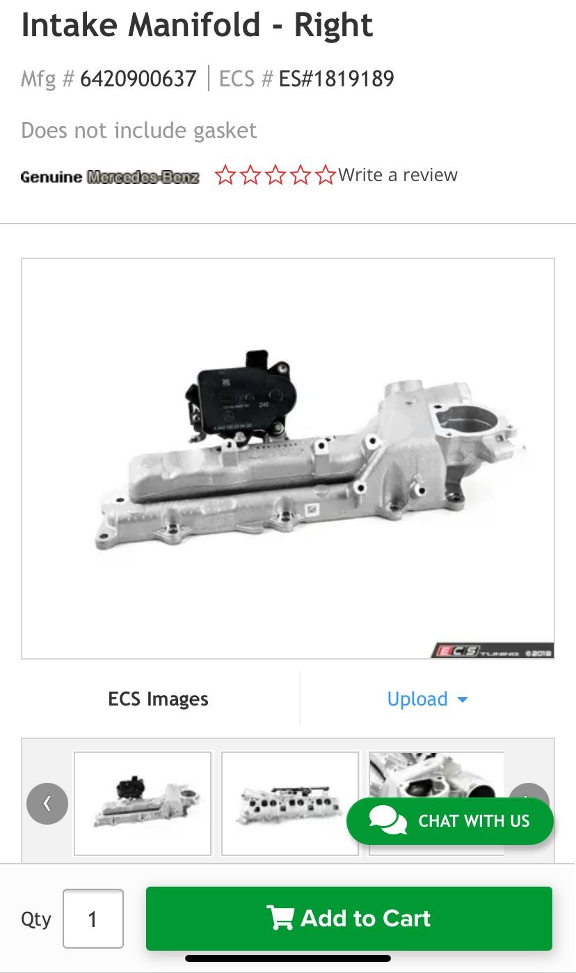

The swirl flap motor is part of the left? Intake... So if they replaced intakes the motor would be replaced.
Cant you check if the pcv valve was replaced? Its on left head by firewall.
The $8.5k is cost of parts, not retail. Retail of all those parts is pushing $20k
Wow - I just looked up the more expensive parts online to see what the cost was, and approximated the exchange rate to get my CAD estimate.
The swirl flap motor isn't part of the intake, but sits just under it. It's a known failure point, and sends the car into limp mode when it's not working properly. I bypassed ours with a resistor to keep it open (usually it closes at lower RPMs and opens at higher ones to improve fuel efficiency) so it wouldn't go into limp mode anymore, but did give me a permanent CEL to warn me that the flaps are stuck open. Just picked up the car yesterday, but no CEL so far, so either they left my resistor in place and it just hasn't triggered the CEL yet (but likely will in the next day or two), or they removed the resistor and connected my old, busted swirl flap actuator (in which case it will trigger a CEL and go into limp mode, but may not show up for a while). I guess either way I can get it taken care of under warranty now, but it will be a real pain if I have to wait until I'm towing the trailer and out in the middle of nowhere when it decides to stop working...

Sorry I meant when you buy the intake, it comes with the motor..
I did this job myself (replacing intakes) 6 months before I found out about the warranty..
Anyway, my car had the measure completed end of Dec, and I received an email that payment should be sometime in May.
