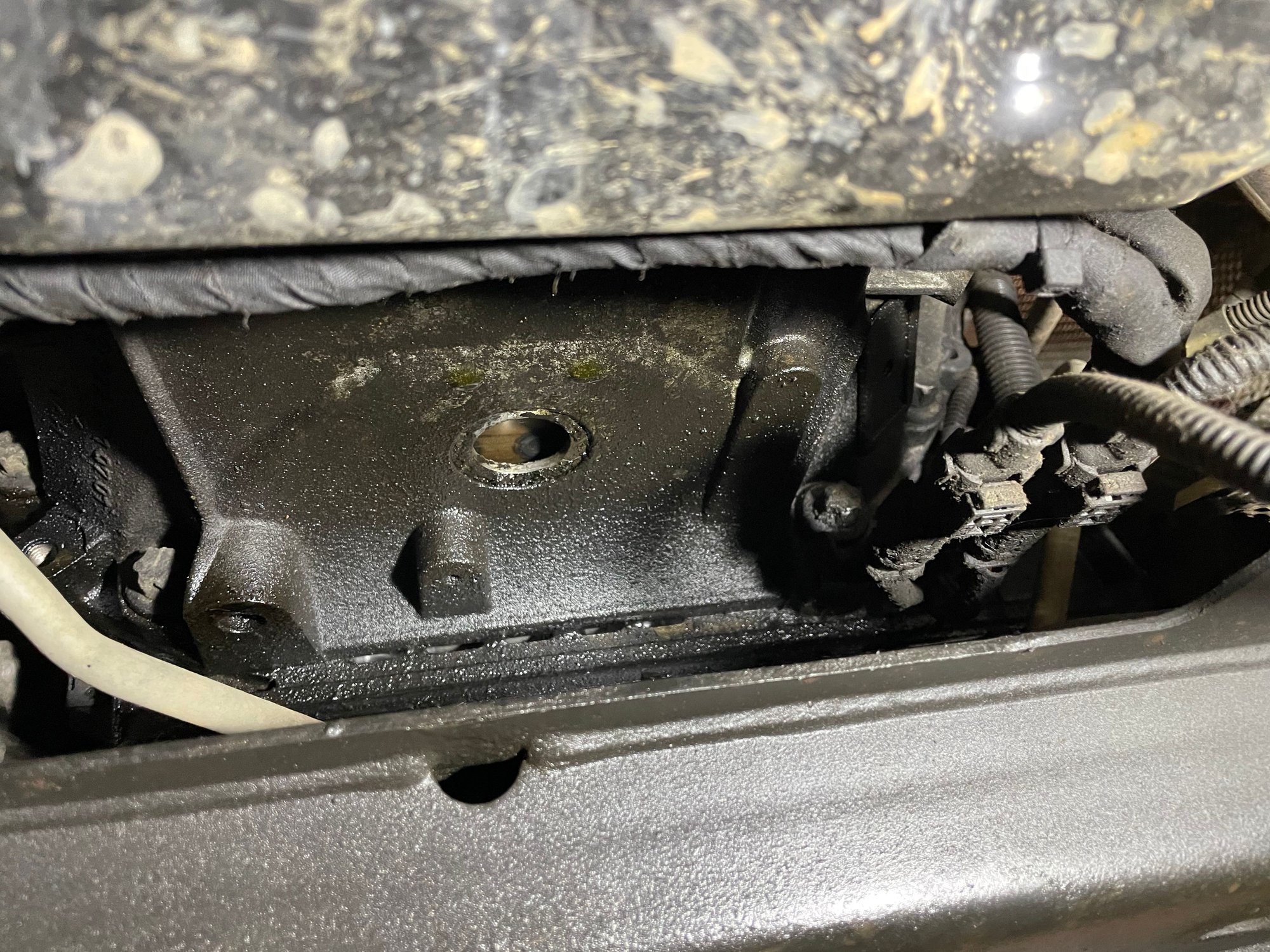

This is a picture looking forward at the bell housing. There is a small (1.25”) hole but no rubber cover like the picture shows in WIS. Is that image for a 2012 or 2013? I have ordered a drive with WIS but won’t get it for a week.

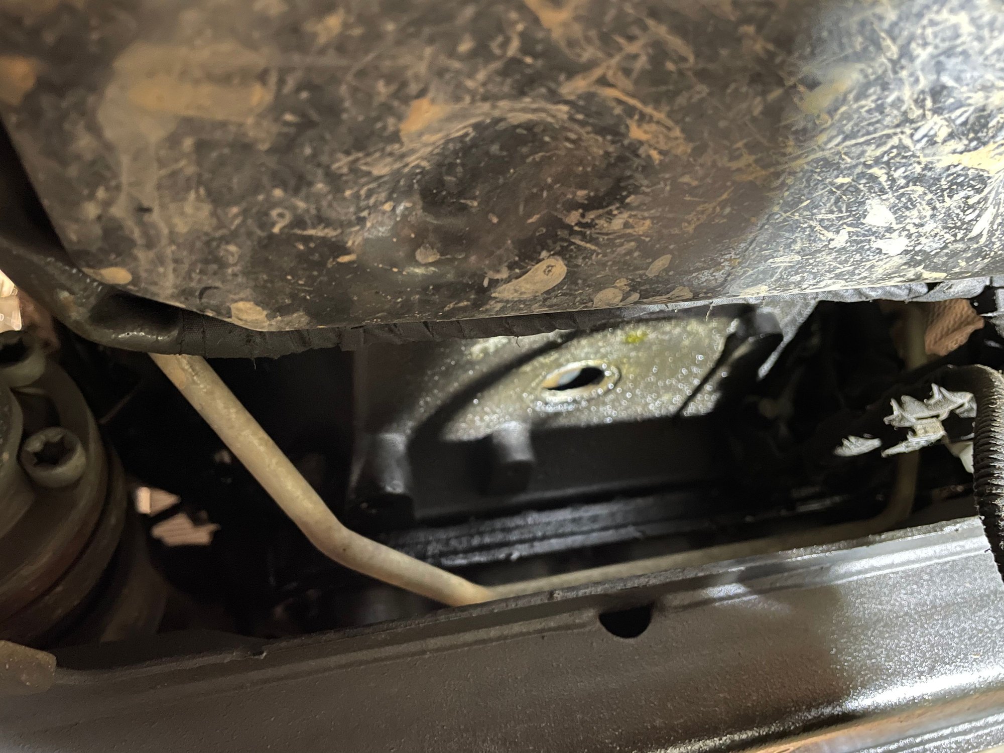

Another picture looking towards the front with a wider perspective.

Hmm. I had just skipped down to getting the engine and transmission separated. Going back and reading through all the steps, though, step 50 is "Lower engine transmission unit with front axle carrier". I haven't seen an x166 to know why they want it to come out the bottom instead of pulling it from the top, but I can tell you that WIS has two different chapters for the x164 engine removal - one out the top and one with the axle carrier out the bottom.
That inspection hole looks like what they're talking about, but you're right: it looks too far back to be able to get to the torque converter bolts. If you're taking the motor apart anyway, I wouldn't worry too much about turning it backwards. There's an outside chance that it would jump time, but you'll be re-timing it anyway.

Yes that cover is to access the hex drain plug for the torque converter, for those fastidious people who believe in draining ALL the ATF when do the trans service.
