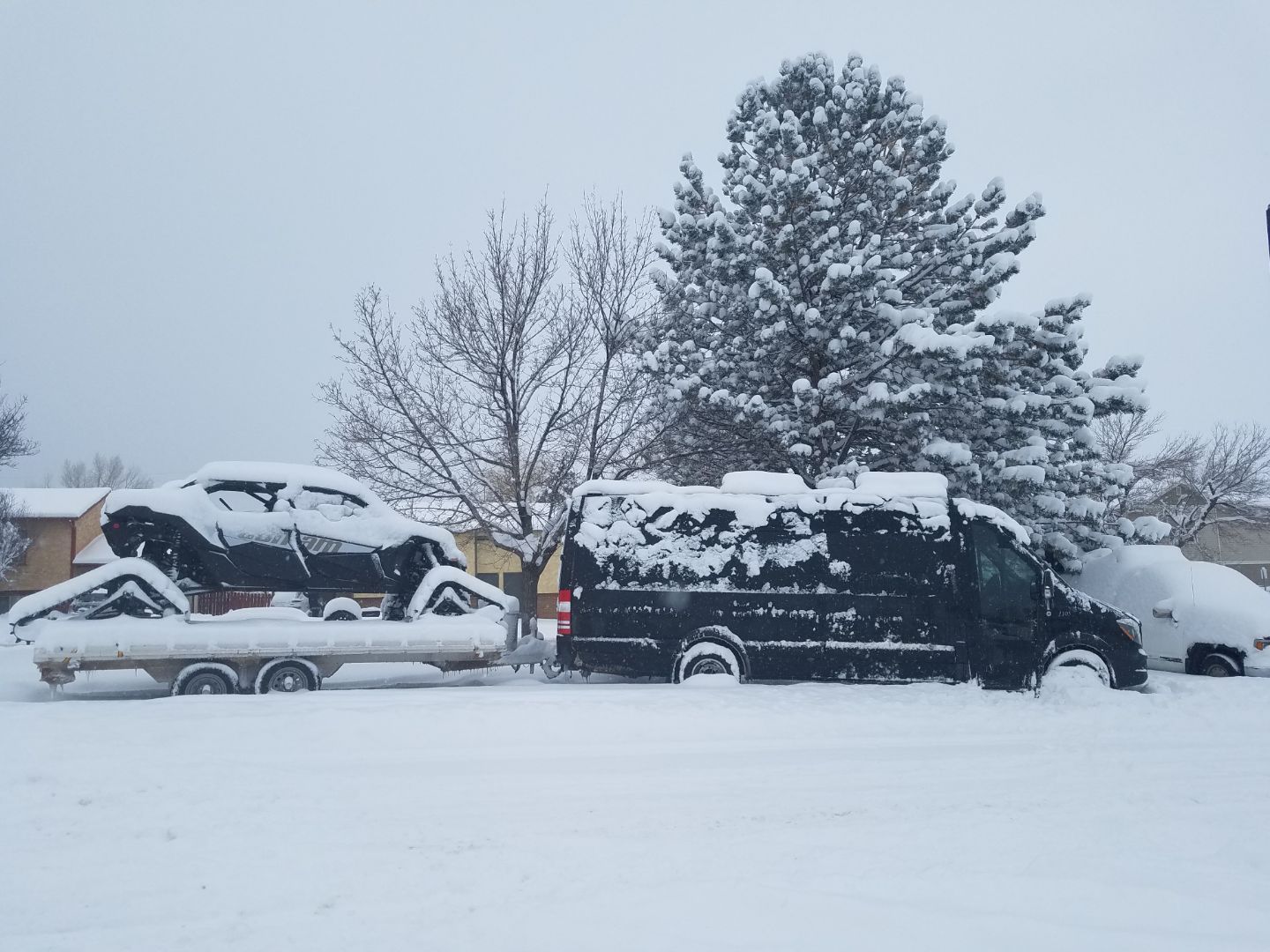

This is OM642 hauling 12,000 lb (not counting the snow) over 10,0000 ' elevation.
The engine will be your last worry.
In US E class sedans do have derated towing, so finding right hitch might be biggest issue.

Sheesh! Looks like they have way too high center of gravity with that type of bed, the car is sitting well above the one pulling it. I don’t think a lowered wagon is meant to pull that smh.
