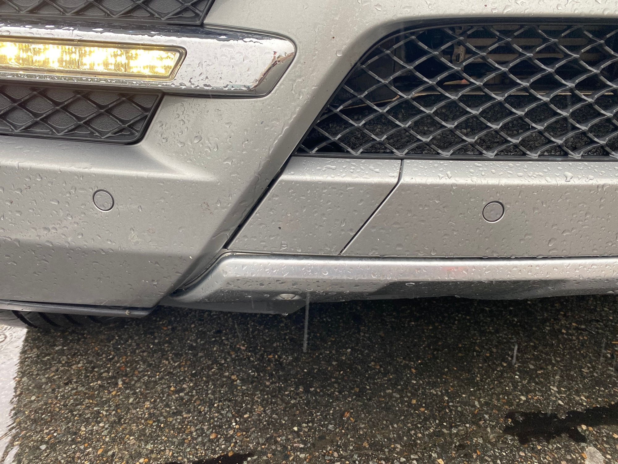

Newb question
Because I have this little trap door below the passenger side grill, does that mean I have a block heater installed? (See image)

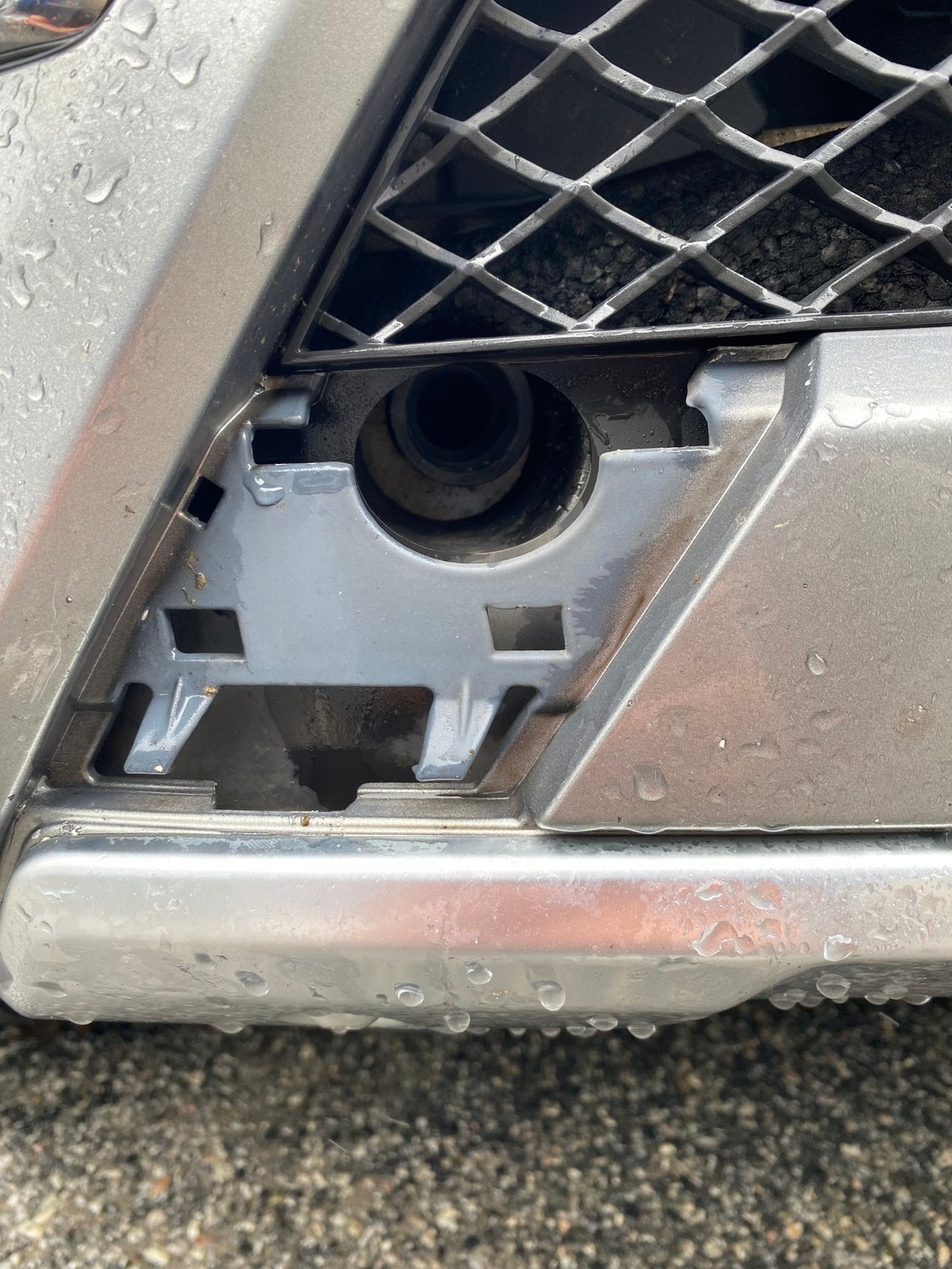

Popped cover off
Here’s what I see:

Old Sep 25, 2023 | 02:03 PM
John CC's Avatar
Joined: Jun 2021
Posts: 1,919
Likes: 521
From: New Hampsha
'17 GLS450, '14 GLK250, Grandpa's Roadster
In the back with the tool kit there should be a big eye-bolt that screws in there. There's a similar fitting in the back, too.

Originally Posted by pjhiggins
Here’s what I see:
Yupp, towing point.
Get the towing eye from the trunk and check it screwing in as threads like to accumulate dirt and corrosion.
