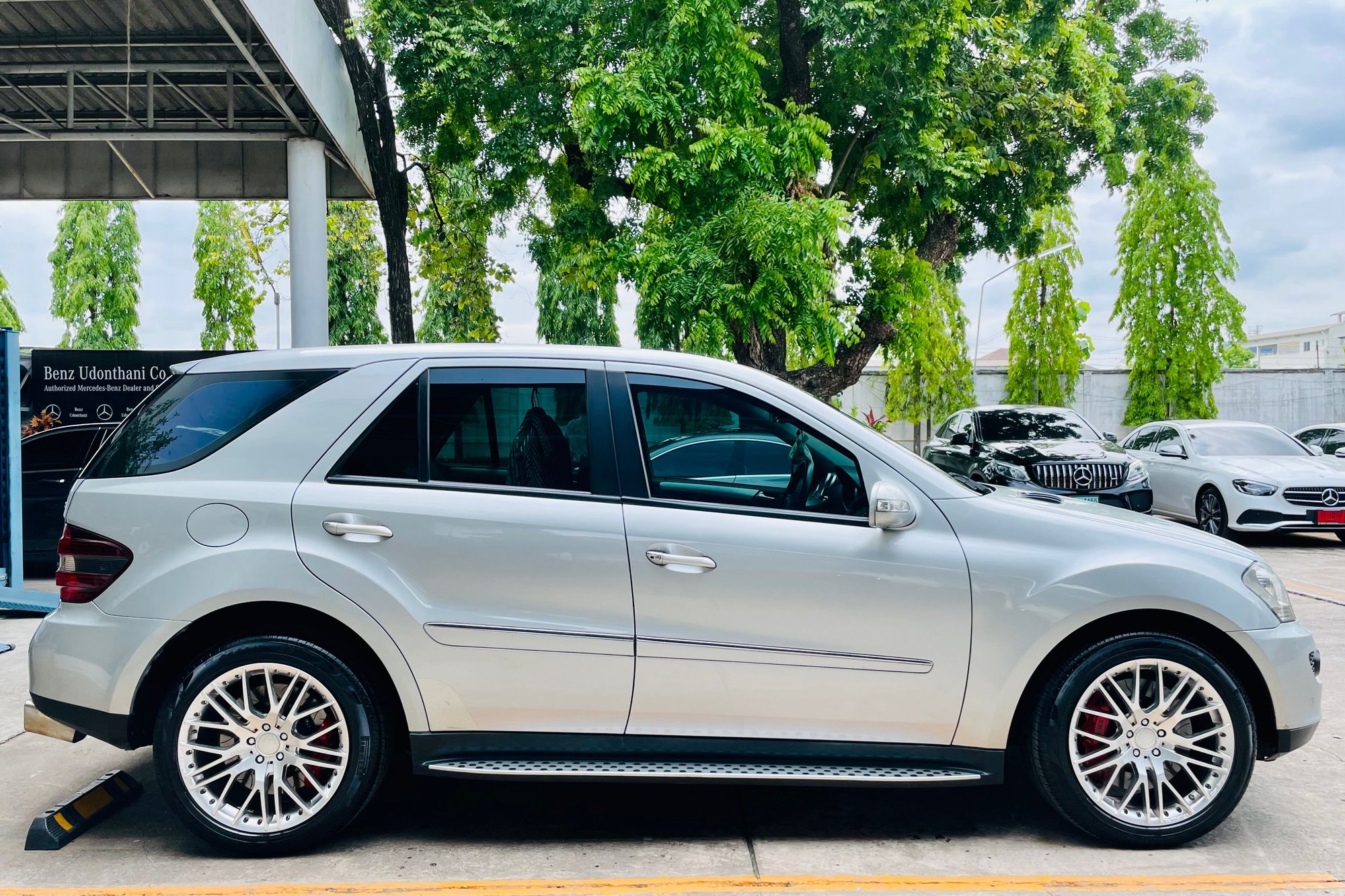

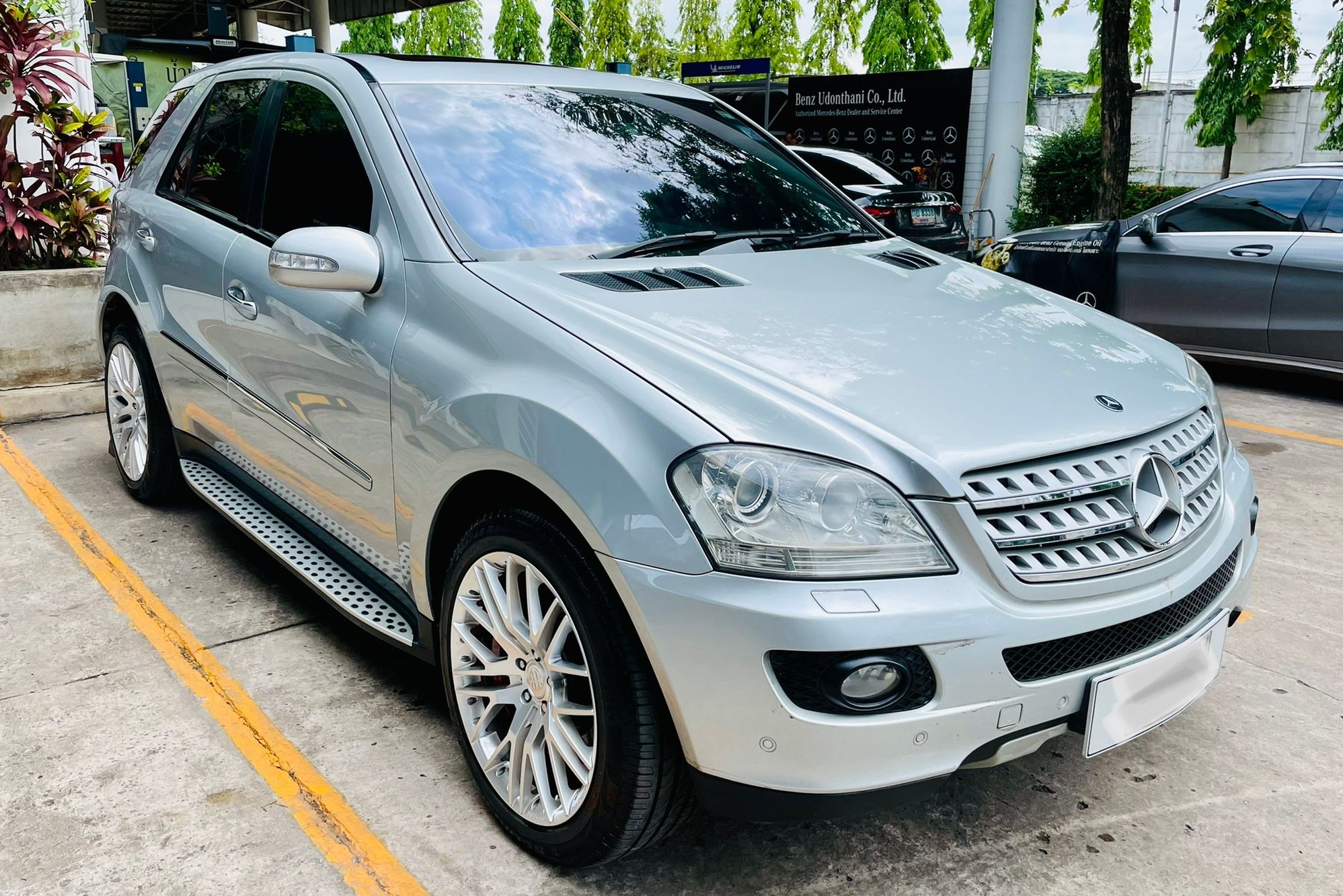

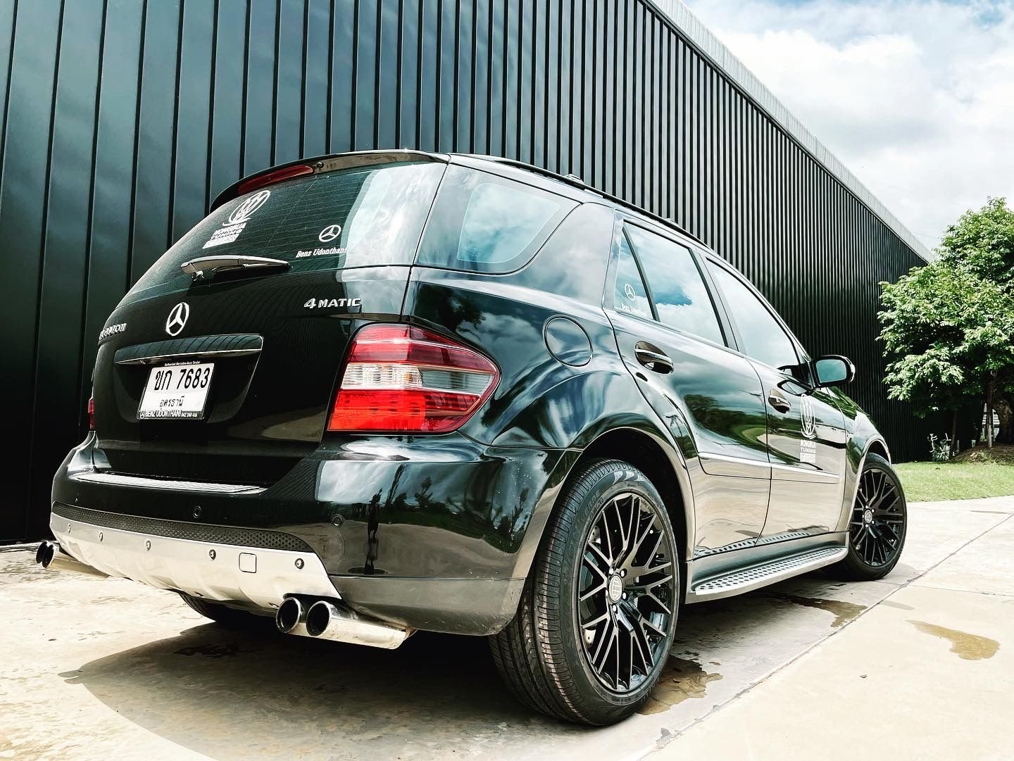

Hello, I have done Stage 1 and 3 ecu tune on many Mercedes. Particularly my W164 ML 280 cdi is a detuned version of ML 320 cdi. In fact I have done Stage 1 (software tune only) on my W164 ML 320 cdi in the USA and Stage 3 (hardware upgrade + software tune) on three W164 ML 280 cdi in Thailand. I would suggest you find a ‘good reputable’ local ecu tuner to get you a Stage 1 tune, which will get you to around 290hp with no other hardware upgrades required. If done right it will have no effects to your ML’s long term reliability—just drive and get your regular maintenance. I can say that because I have tested all my tuned Mercedes quite heavily in the past five years, over 100K miles all combined
. By the way, I represent Celtic Tuning the UK in Thailand. You may want to check my Google profile: Nongbua Tuning LP in Thailand and IG: NongbuaTuning. Cheers!
