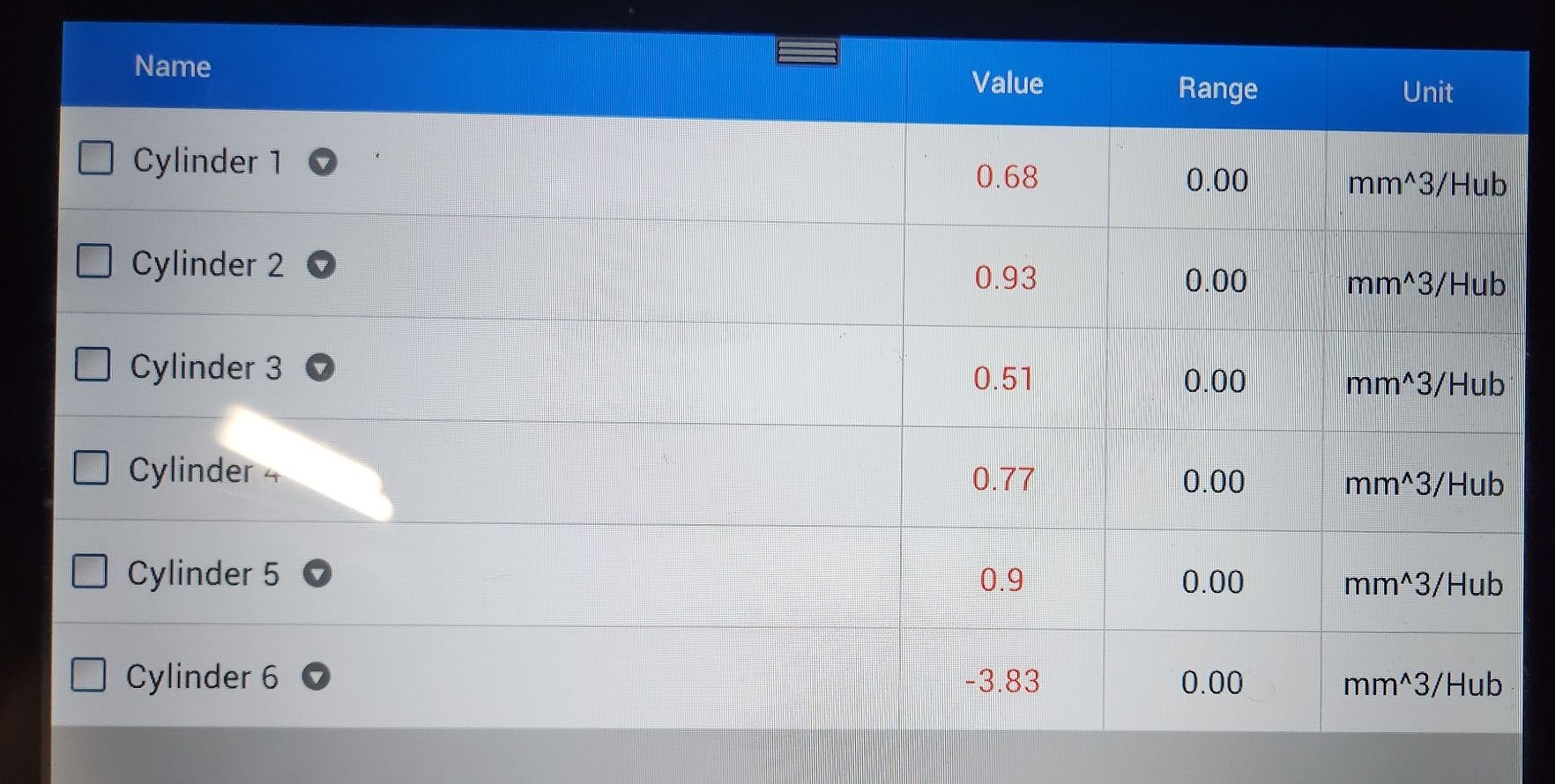

Update.
1. Replaced temporarily with another injector from a 2010 ML, different code, but coding updated on the PCM, no change, same knock. (but looking at the parts catalog today, it seems that 2010 injector doesn't work on the 2012 so that might be the issue).
2. I scanned the fuel flow/adjustment after installing the used injector, got the screen below, looks like the 6th cylinder is way off.
3. I took the original injector to an injector shop. They claim injector is electronically bad.
Next I will see if I can refurb the injector, apparently you might be able to. I'm debating if I should try other injectors from that ML 2010 (I have 6) in case that one happened to be off as well.
