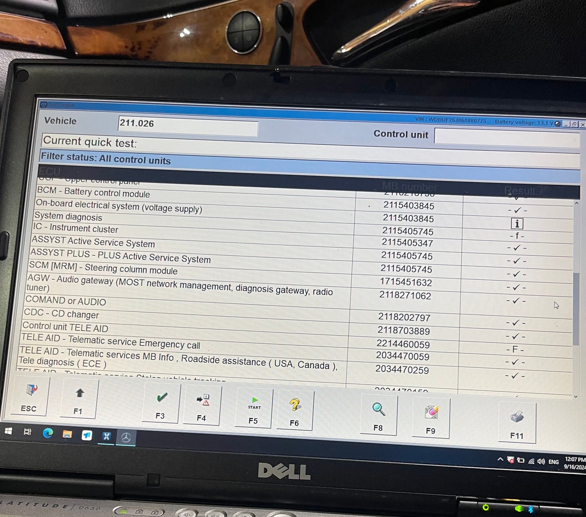

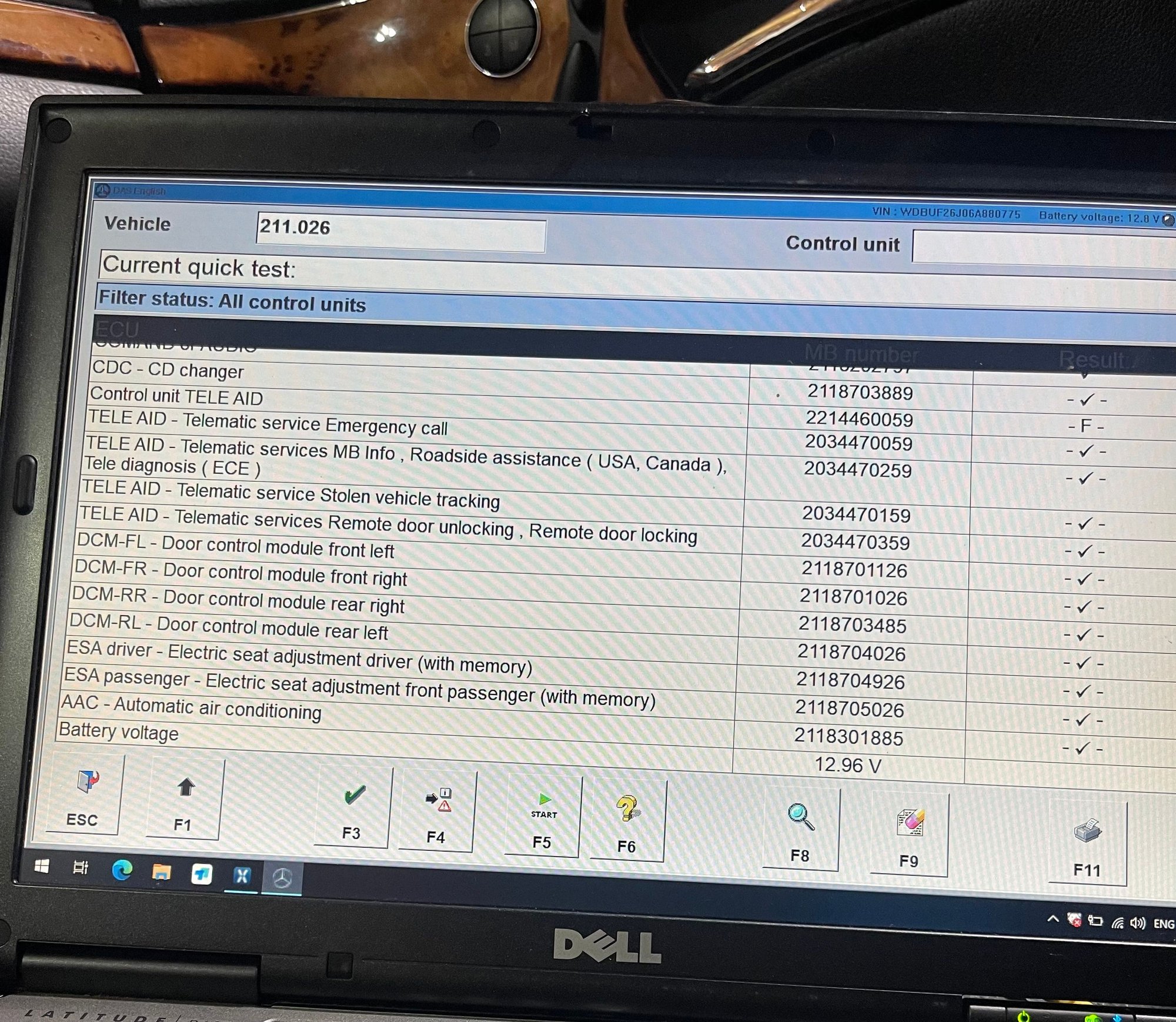

Old Feb 1, 2025 | 06:38 PM
Oldskool36's Avatar
Joined: Jul 2012
Posts: 18
From: Sanger, TX
2006 e320cdi, 2007 CLS550, 2000 S430
Originally Posted by Plutoe
are you serious and you want to change glow plugs-----just do a quick test and post the screen shot

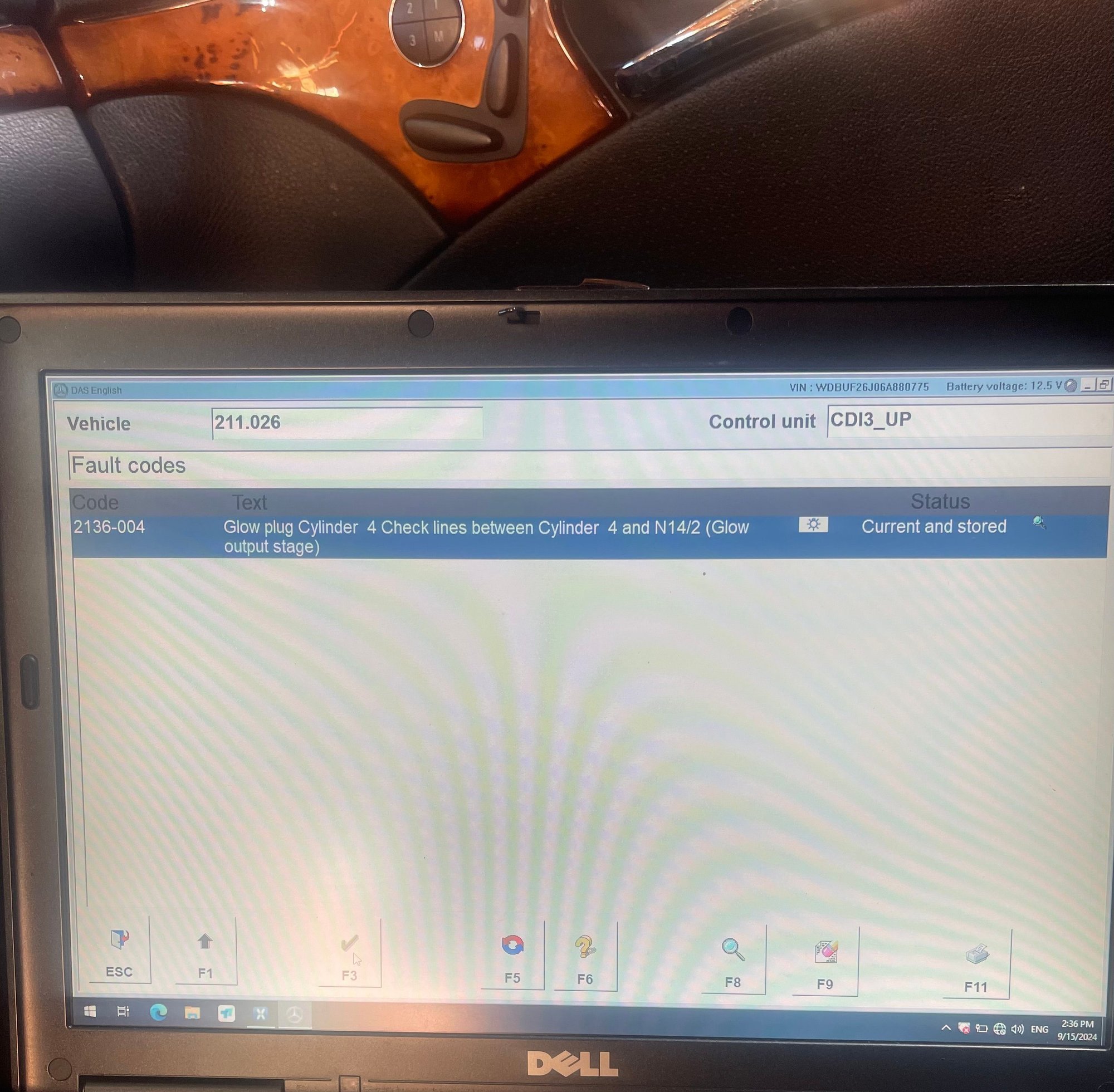

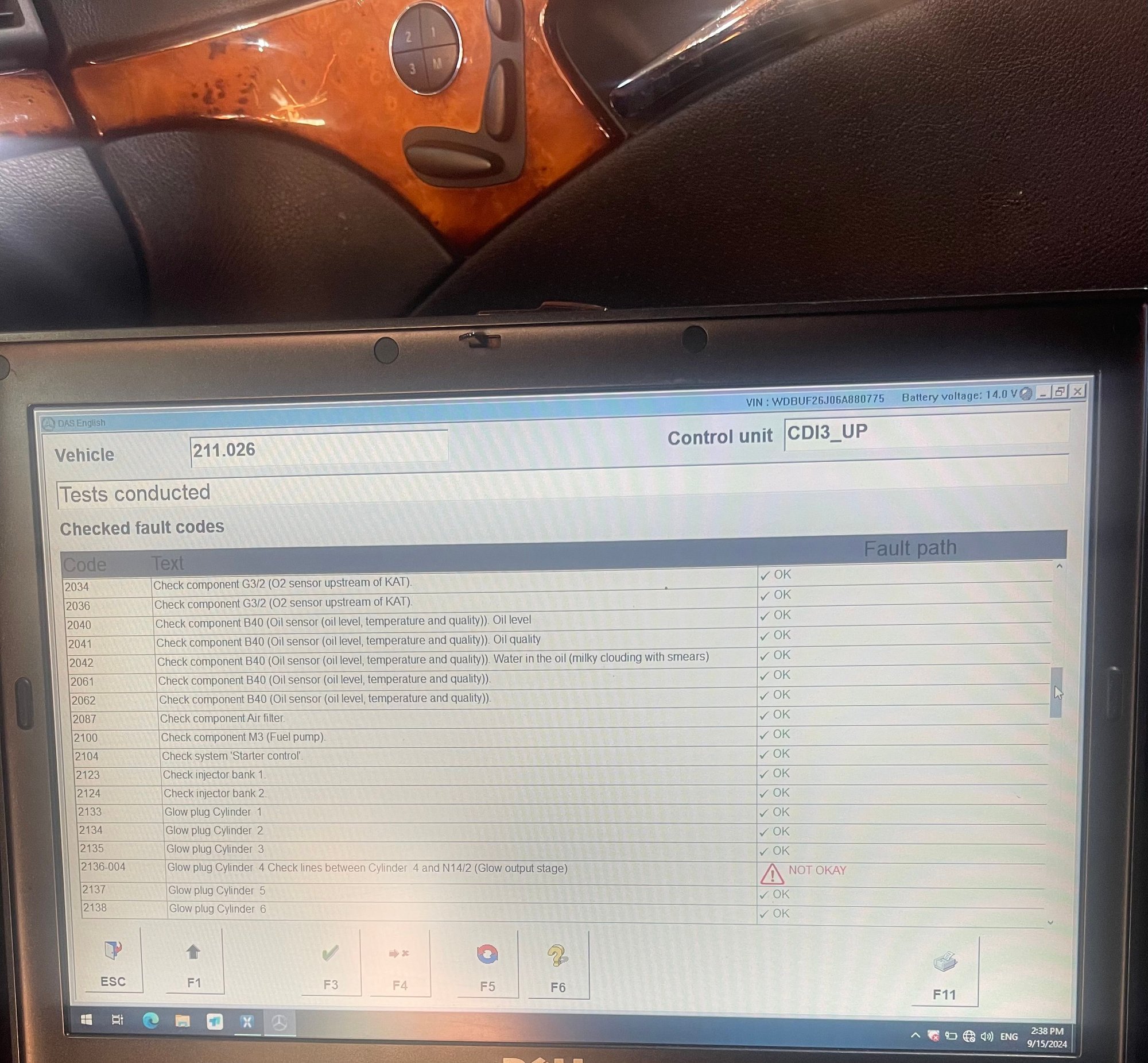

So, here are the results that came up on the Xentry DAS scan of my '06 E320 cdi. This is of no help to me in figuring out why the car will crank, but not start. Obviously, I'm missing something, somewhere as Xentry should be telling me where the problem lies. At least, that is what I've been told about the tool.
I also ran a test of the vehicle's key, and the key passed all of the tests that I can find for it in the Xentry system.
The only things that I have found in the Xentry DAS tool related to theft deterrent, or lockout require access that I do not have on this borrowed system.
Any clues as to if I'm missing something? Today is the first day that I have ever tried to use an Xentry DAS system.
Xentry Quick Test Results
The only
The only "Engine Related" Fault Code that showed up from Xentry scan.
The tGlow Plug Fault Code is the only code that showed up in the scan.

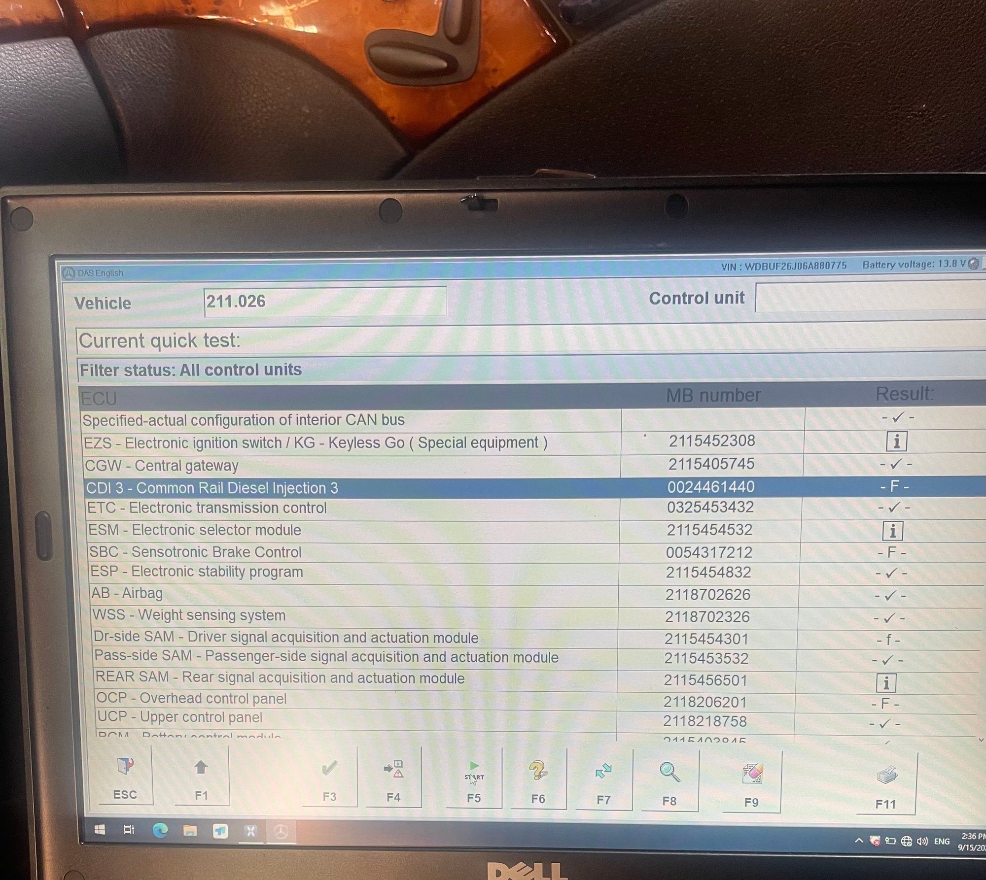

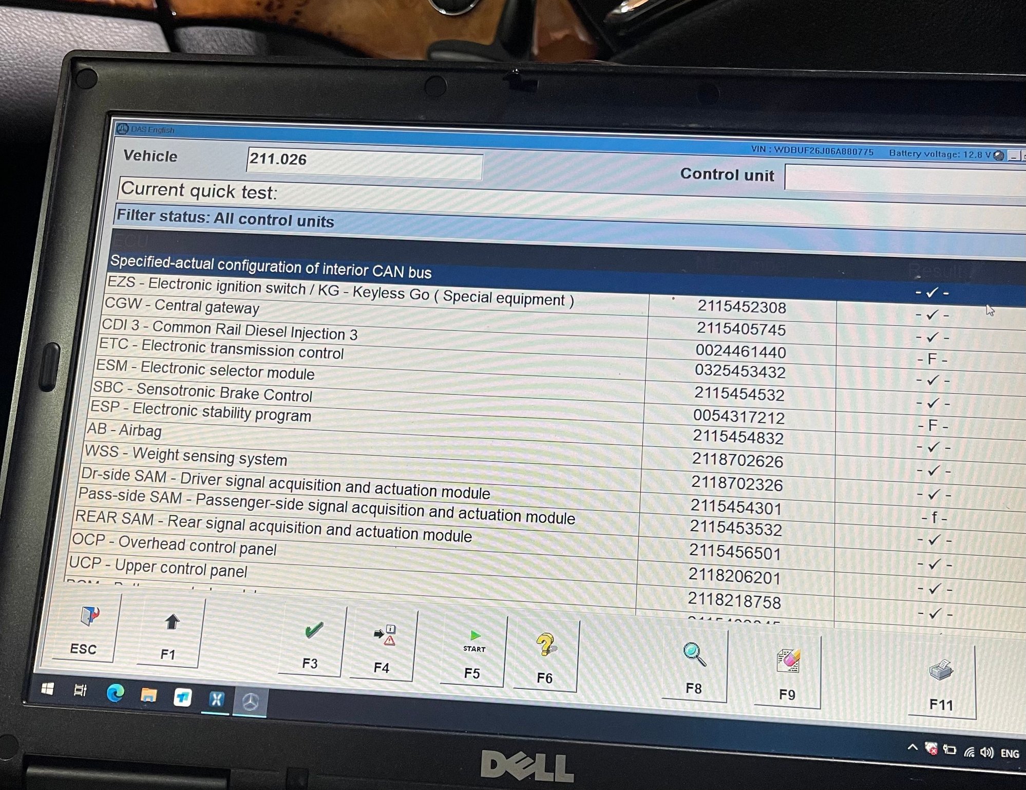

based on the quick test, i think you are being told what the problem is-----once again just follow my instructions with DAS Xentry---run a quick test----then on the lower right side of the screen you will see an eraser-----that is where you erase all the faults------do that-----then close out and run a second quick test and post the screen shots of the quick test only and forget all the faults we will be working with the quick test screens and that is all i want to see if you want my help
Then I will give you another set of instructions
Thank you for your kind response!
I followed your directions, as specified. Here are the results of the Quick Test after clearing the codes, closing out and running a new Quick Test...

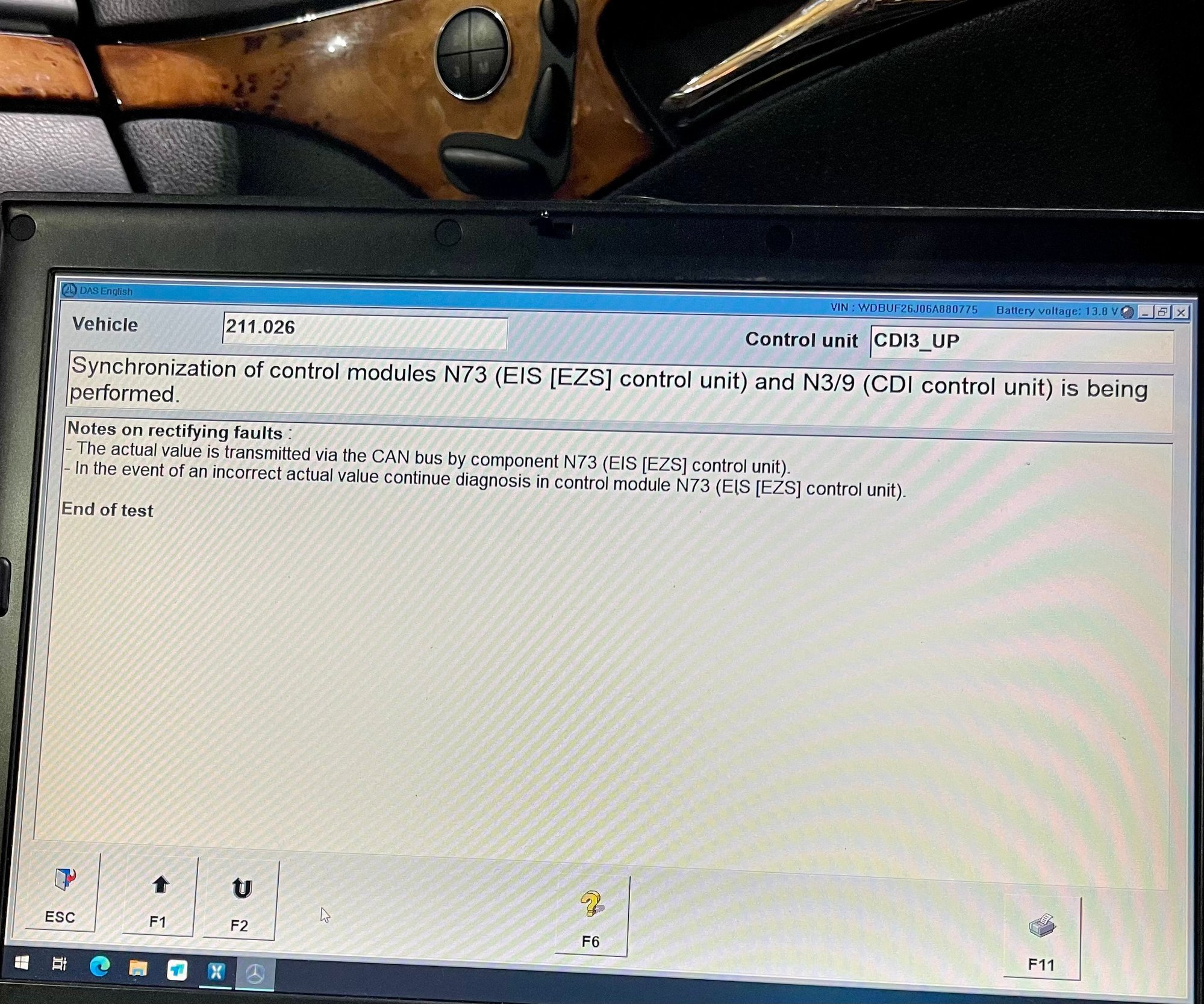

Old Feb 2, 2025 | 05:29 PM
Oldskool36's Avatar
Joined: Jul 2012
Posts: 18
From: Sanger, TX

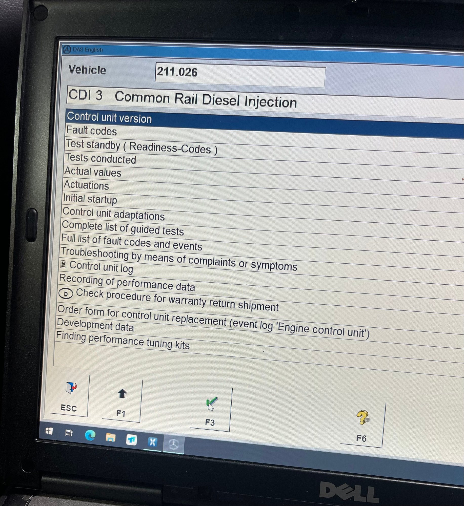

double click on the CDI-3-------what does it show
FYI you can do the same later with all the other F and f modules
It shows this when I double click on it …
Old Feb 2, 2025 | 10:29 PM
Oldskool36's Avatar
Joined: Jul 2012
Posts: 18
From: Sanger, TX

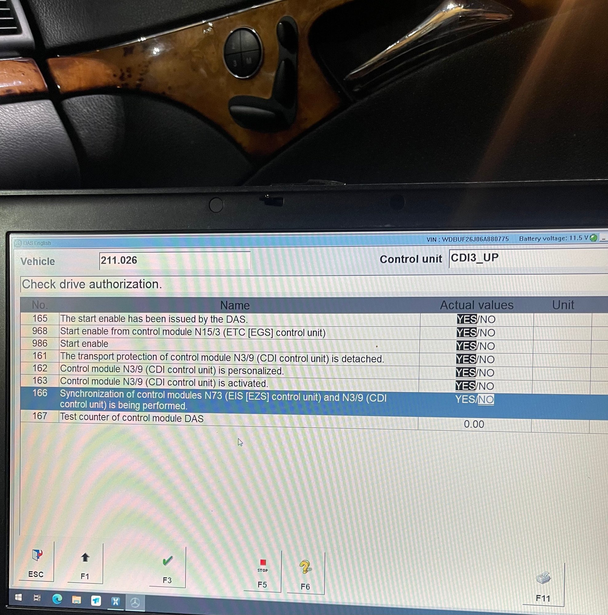

double click on fault codes what does it show and remember all the information that is available to you to test bla bla
When double clicking on fault codes, I came up on this...
Then, I double clicked on the highlighted area (No. 166) and I got this...
However, trying to get into Control Module N73 put me into an endless loop where I couldn't get any further. I don't know if possibly this version of Xentry is limited (and that's why it's available), or if I need to do something else that I'm not aware of.
It looks to me like I need to resolve the synchronization of N73 and N3/9. Any idea on how I do that?
