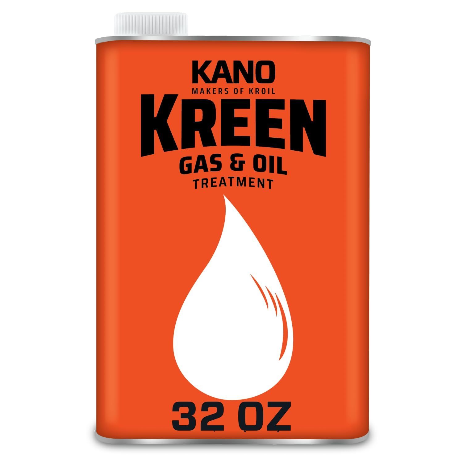

I would suspect that there may be something up with the turbo since it was just rebuilt, however that oil could have been in the turbo and just got spun out from revving, not necessarily from the turbo. However if your issue is a stuck oil control ring (fairly common on the OM642) then I can share with you the fix that worked for me.
Half a can of this stuff in the oil. I drove a little (very carefully) with it in my crankcase but the safer procedure is to get the engine up to operating temps, add half a can, let it idle in park for 30 minutes to 1 hour, then do an oil change. If it doesn't solve your oil consumption, repeat using the other half of the can, and then if that still doesn't work maybe that's not your issue but you'll at least know your engine is squeaky clean inside!

"your engine is squeaky clean inside"...
Hmm. Poor choice of phrasing?
