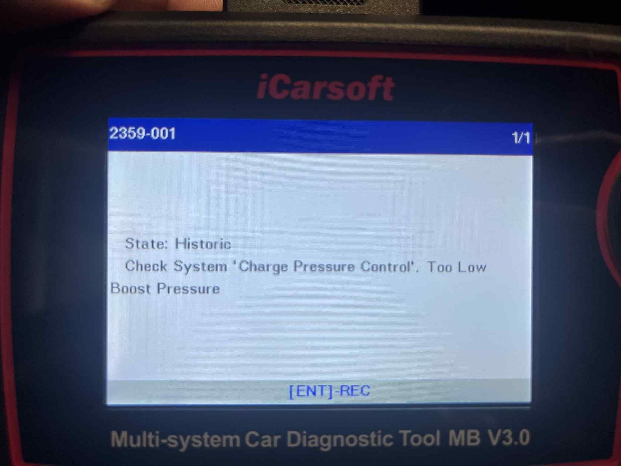

I've got a brand new intercooler and one new charge air pipe. The other new one kept popping off (it's aftermarket, sadly FCPEuro doesn't have an OEM one for that side) so I went back to using the old one, which seems to have a small crack in it so I bet that's the issue. Hooked up my scan tool earlier to confirm:
Thanks all for your quick replies! I'm going to try fiddling with the clips on that new aftermarket charge air pipe and see if I can get it to stay on, I bet the old one is leaking thru the crack. It's a bit oily in that area.

Got my new charge air pipe and it was definitely that. The old one had multiple cracks, I'm surprised I was getting any boost at all. Much less turbo noise (sadly, I like turbo noises) but WAY more power! Almost no hesitation off the line either, very nice!
