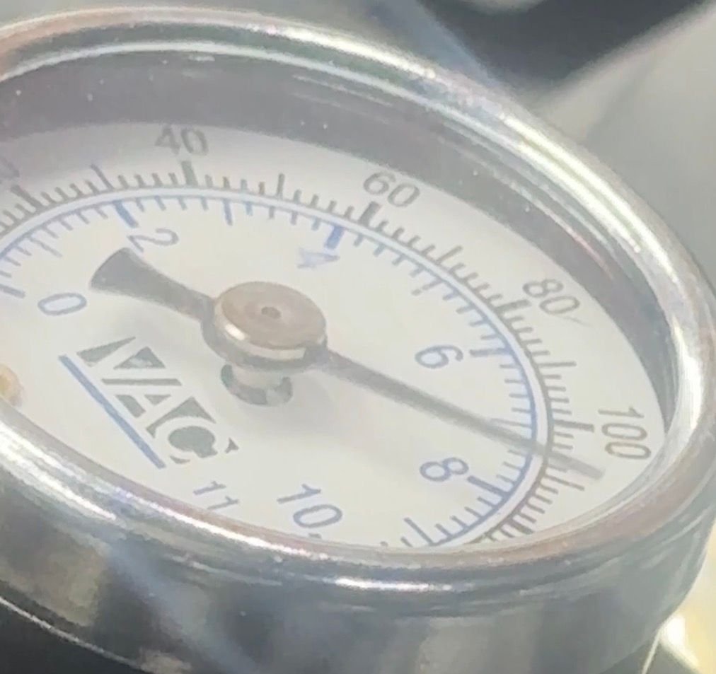

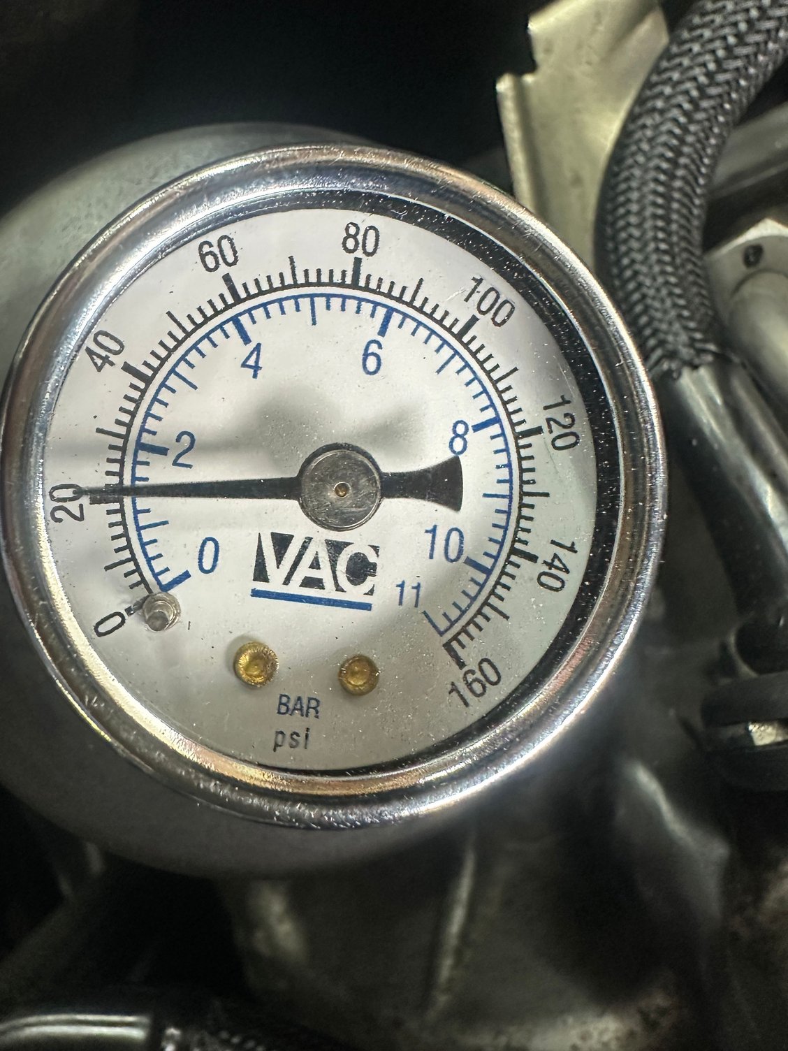

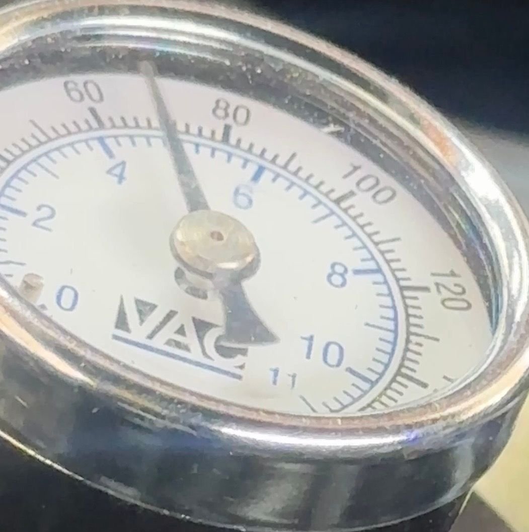

Just thought I’d share a few pics. I bought an oil filter cap off of Amazon, drilled a hole in it and screwed an inexpensive 1/8” gauge in it. Glad to say no leaks. I have a 2013 with 300k plus and a 2015 with 135k. Both SUV’s oil pressure readings were the same. I took the reading with an oil temp at 195F (for the idle & 2k rpm) give or take a few degrees. For the neutral WOT the oil temp
was a little low like, 165F.
Hit idle - 21 psi
2,000 - ~70 psi
2,900 - around 110 psi (not quite up to temp yet)
2,000
2,000
Hot oil pressures:
700.R - ~21 psi
2,000.R - ~70 psi
2,900.R - ~ 110 psi
These are nice available pump pressure that can help spray cool the pistons.
Particularly important at driving Rpm (1500 to 2500R).
110Psi is a high pressure... is this pump Max ??

Seems high.

higher than spec
Above specs in Bars translated into Psi as...:
  • 700Rpm ~ 4.5Psi
  • 3000Rpm ~ 45Psi
What oil viscosity was used... W30 /W40 / W50 ??
The Max pump pressure relief should not be affected by anything... 110Psi really??
