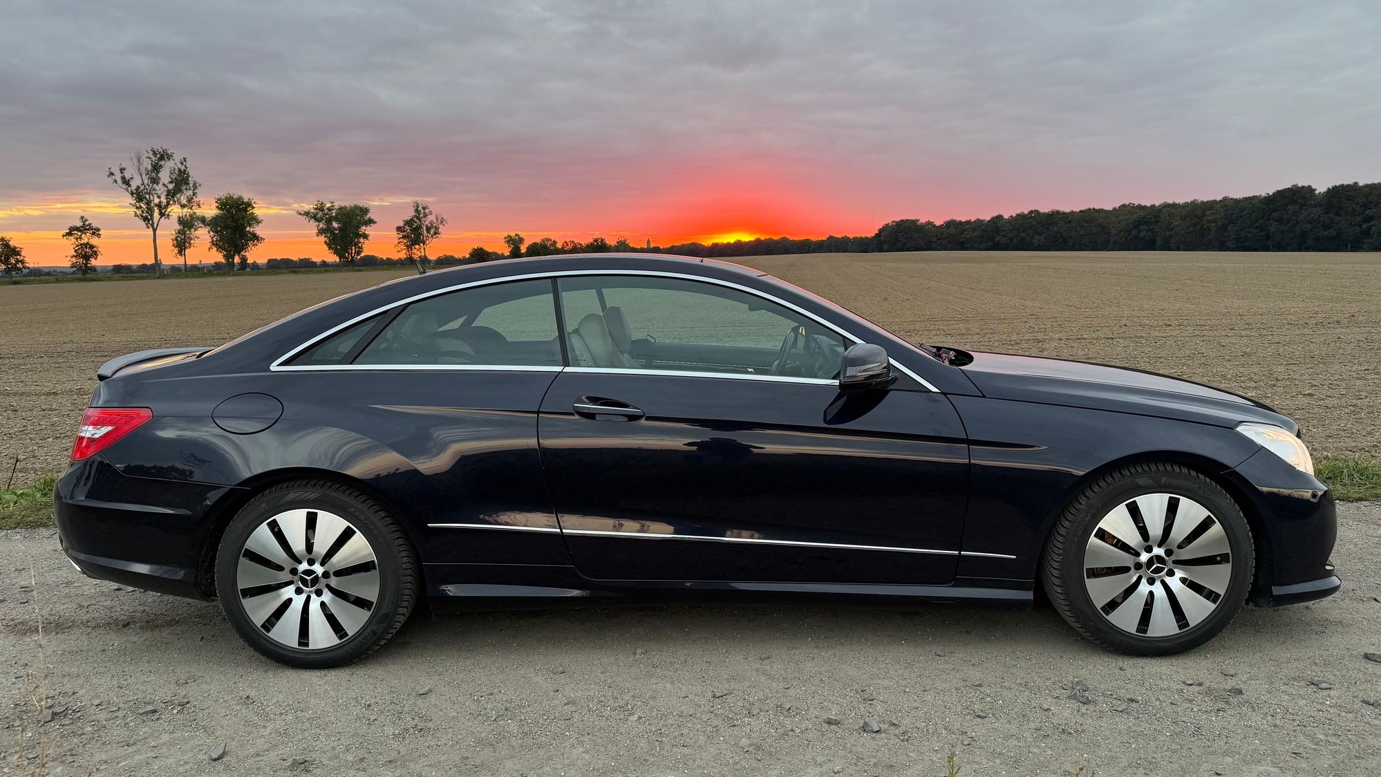

For the future, if anyone's interested, this is how the E500 with AMG Package and Dynamic Handling Control looks like on 17”. Nice, ugly, a matter of taste. objectively comfortable and enough effective for an old car, even with big engine.
I bought my E500 on 20-inch wheels, which ruined the shock absorbers, steering rack, and the rims themselves were cracked. Was lucky, that sunroof did not crack.
The E500 is heavy, so it will never be sporty, and it's exceptionally hard for a Merc. In sport mode, it's very precise, but it doesn't knock your teeth out. On 18, 19, even 20 nich - it will never be a Miata.
I also bought an original 786 AMG, but only to have complete genuine AMG Package, won’t ride them. Tire width max 245? It's 2026, and today even all-season tires from Michelin or Pirelli have better traction than some Pilot Sport 2, developed in 2008 - even if it was 275mm

Hi RichyK2000,
Rims on the photo are OEM, they come from GLC, part number: A2534010500, they're square 7.5x17 ET36 with Pirelli SF3. Rims are only stripped out of the paint and diamond cut on the face, painted gloss black inside. Caliper from my E500 fits enough. I was looking for full face wheels, but finally I took OEM.
This was my cold/winter set up, but as I tried them, I thought it's pointless for me to run 18' 786 (they're staggered, as you wrote) - once comfort is great (I'm riding offen on country roads with all windows down), and second - the level of grip is fantastic - is hard to squek even when I'm flooring. The only thing is, that the wear is higher when hot outside.
Pirelli is only in 235/45R17 (when I was choosing the size, I didn't have many kilometers behind me in the E500 and I was sticking to the book) so next time I'll take Brigdestone Turanza AS6 in 245/45R17 square.
I tried 4 sets of rims in 2025 (from 17 to 20) - won't be bad on 18", but for sure on the cobblestones 18 will be terrible compared to 17, 20" were not drivable. You just need to define your requirements and conditions, what is more important to you - trying to improve sluggish handling (in my opinion it will be hard in E500, it's damn heavy) or comfort.
