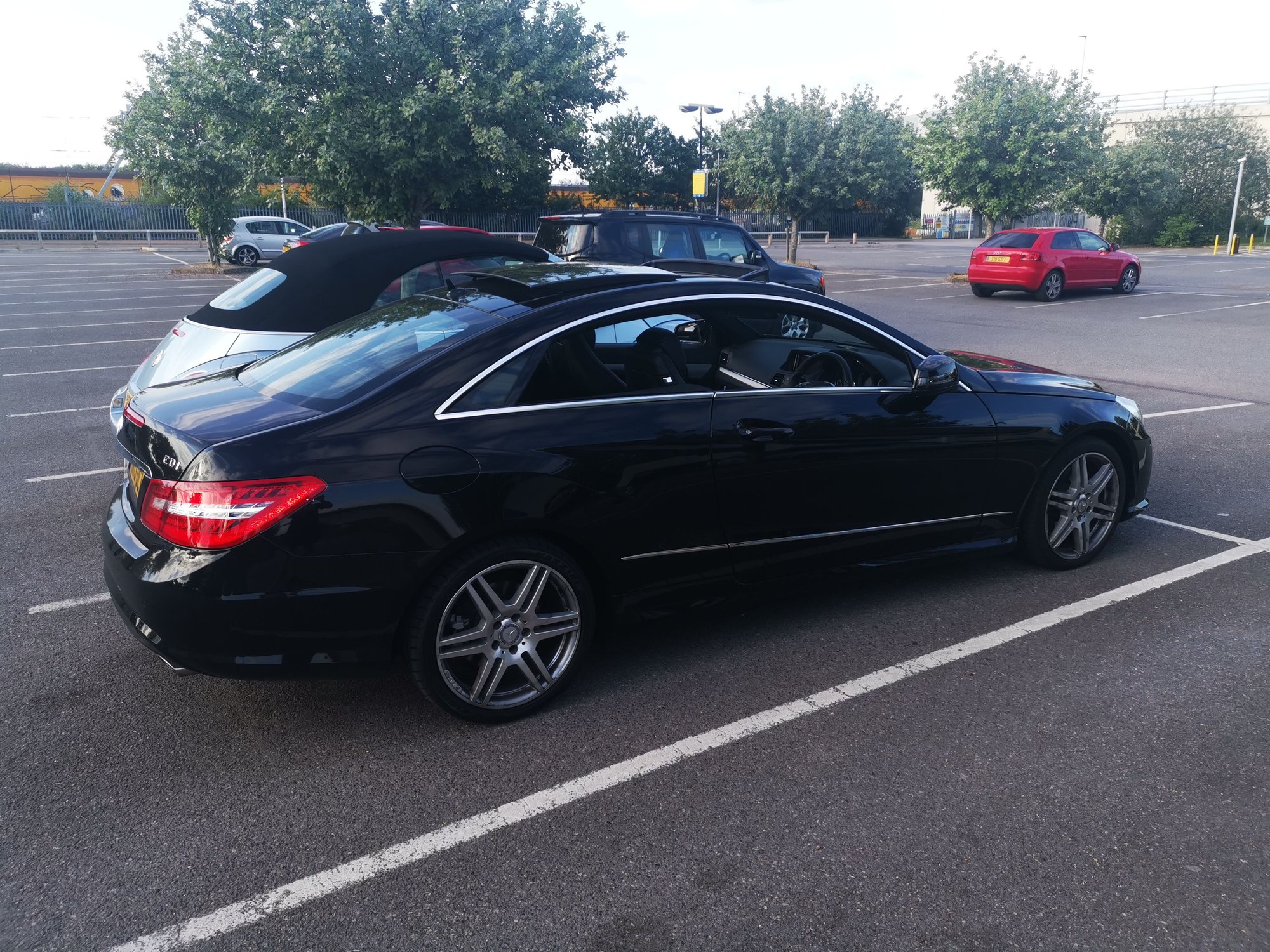

Welcome! Please post a photo of the M-B.
