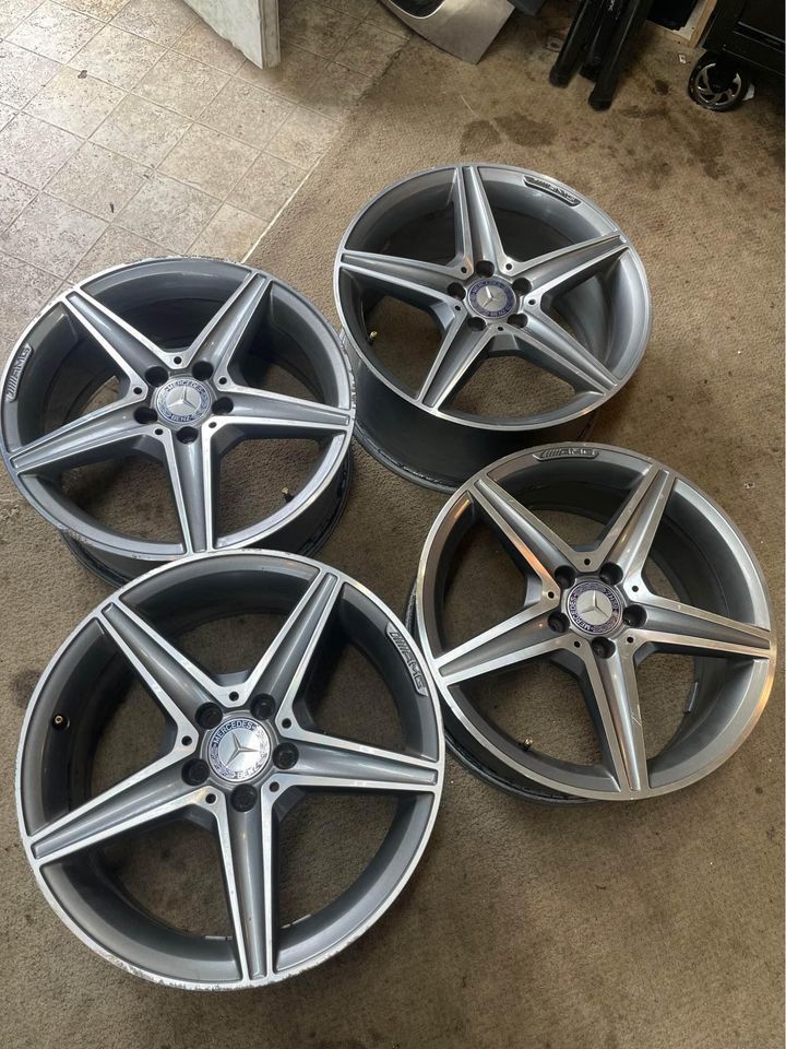

OK, how about these?
on a non lowered C207.
9J x 18H2 ET37
9.5J x 18H2 ET52
If I am starting to understand correctly, I think the rears will need a spacer?

The 9.5" rears will fit great without a spacer, and 275 tires. The 9" fronts are a little wide but should be fine with a 245 tire. Maybe even a 255... I haven't personally run a 9" wheel up front but others here have.

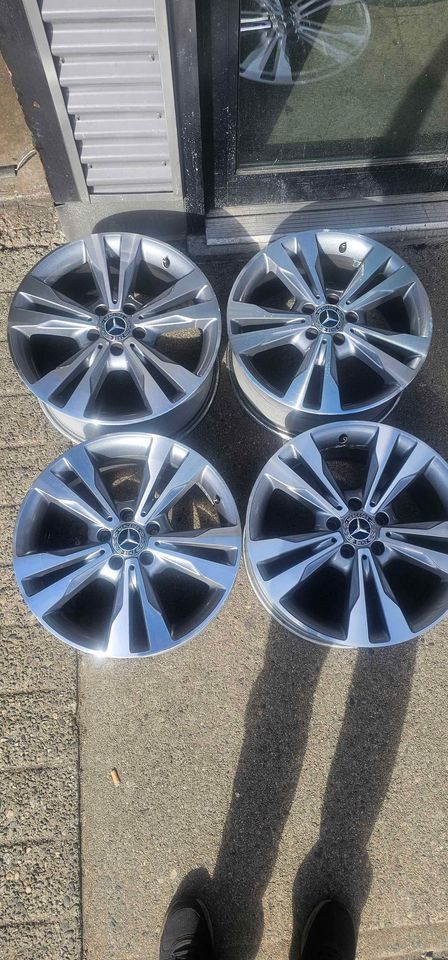

or these...
also 7.5 and 8.5
but these sets with smaller fronts cost just a bit more than fixing my curbed stock wheel.
so that's why considering them.
