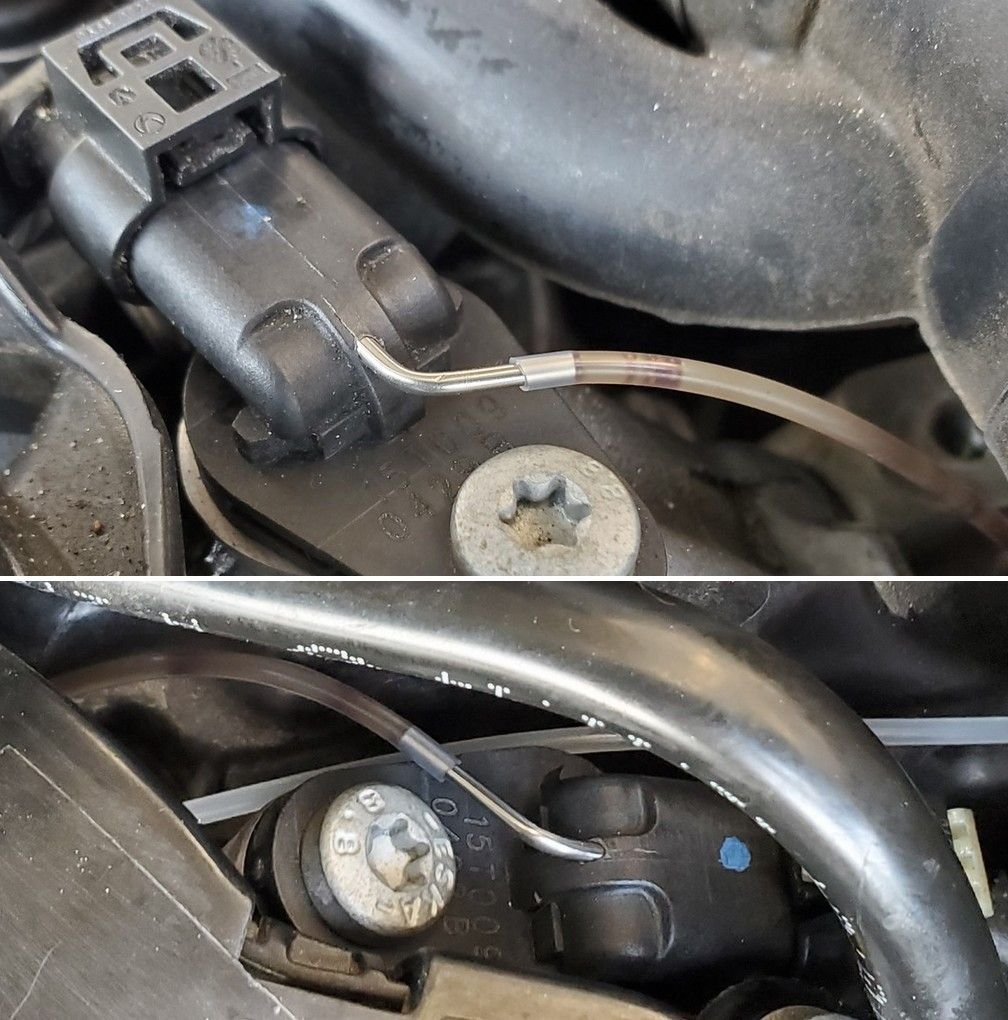

I have an M278 with the same issue. Oil hasn't reached my ECU yet, but some of the cam position sensors/actuator plugs were dripping wet >:|
Being a redenck n all, I'll be fixing it myself. No way I'm paying someone. So here's my thoughts on options:
Buy some sacrificial wire plugs to at least stop more oil getting in; Link Or buy new cam position sensors/actuators that don't leak. The newer ones aren't supposed to leak, so they say, but I bet it's still a gamble.
Open up the ECU and put some paper towels in there to absorb the oil, replace now and then. My guess is it isn't much oil at all but you'd know more than me. There's a spot, at least in my ECU, where you could stuff a wad of paper towels in there nicely so even when wet it won't touch the board. My ECU sits with the board on top and the "cover" pretty much looks like an oil sump, so as long as you can get the incoming oil to divert to the pan, I'd imagine I could hold a lot of oil. Not sure what your ECU looks like or how it's mounted, but where there's a will there's a way. Even if I had to seal the whole board with something, I'd do it.
Seal the ECU so oil can't get it. It can only seep in via the pins that pass through the plastic in the ECU and clearly they aren't sealed. What sealant to use, I don't know yet. I was thinking silicone or epoxy. How much room there there is inside the female plug for that I don't know, but if there's 1mm of space between the male and female plug then there's your limit, but I'd imagine there's more space than that. Since you already have oil in there it won't be so easy to get a good seal, plus it'll weep up n out the pins and may work its way under the sealant over time and break the seal? But maybe this would take years to do that so good enough?
If I were you I'd buy a replacement junkyard ECU and load your data onto it. That way you have a nice dry ECU to seal, and your data saved on a hard drive if you ever need it. Plus the old ECU, which you've now cleaned out, can now be a spare to keep in the trunk if you ever run into trouble. I bought a spare ECU from an online junkyard for $200, plus ~$80 in hardware to make the data Xfer. Totally worth it and I can explain how if you want to do that.
You could also drill a small hole in the sensors/actuators to let the oil out. Not sure how well this will work but imo it's better to let it drain out than have the plug completely filled with oil all the time. If you've ever pulled a plug on one you'll see the male plug has the seal and you don't really want to cut the seal to allow it to leak out because it would still need to fill up with oil to do that. A hole in the sensors/actuators would be at the very bottom, plus those sensors/actuators are consumable items, like spark plugs, your harness is not as you found out via the quote. I would also insert a wick into the hole to draw oil out and let it drip on the eng instead. Something like thin cotton string or strip of cotton fabric. I'd imagine that would both stop more oil from entering, but also pull oil out of the wires.
My plan, for my car, is to suck the oil out of the lines. Same drain hole in each plug, but I plan to run a tiny tube to each one and them to the vacuum pump. How well this will work I don't know, but it's a zillion times better than doing nothing.
Option two, which may be better: Pressurize the ECU. Force the oil back out and down the wires. This way it can run while the car is parked so you get much more time spent doing its job. Plus and you can use more pressure. How much will get past the ECU's pins I don't know, but probably not much so you may also want to pump air into the plug to push oil down the wires. If you don't have a hole in your leaky sensors/actuators then you'll want to unplug the ones that are leaking. The air you pump into the ECU needs to be dry and oil free, which isn't hard to do. You have to make a filter, store boughts don't work, but I can explain and it it's cheap. A small little compressor is like $100? Filter assy and hose maybe $50?
So while pressure is better, it's also more hassle and $. Since I don't think I have much oil I'll go the vacuum route, but fyi those are the options, imo.

In my previous post (#4) I did finally "suck" the oil out and it worked as expected. It didn't take long, less than an hour, before no more oil came out. I left the vac lines on it to continue sucking, because why not and now I don't have to change the sensors. Hard to gauge how much oil came out but I suppose 5-10 drops? I only had two leakers bad enough to bother with, which are in the pix below.
If it were me I'd do the vacuum mod and open the ECU for cleaning. I'd also put paper towels in the ECU, to collect any residual that finds it way and around again. I'd do the same with the ECU plug, to help suck out oil from the other wires that migrated into and from the female plug ends which will hold oil. The vacuum mod might pull oil from the other wires, but it'll just accumulate in the plug, which is what the paper towels are for. Probably not much in the other wires, but only way to find out. Oil will be hiding in the female side of each plug wire, so spray those out good, and do each time you're in there. If oil got into the ecu then I'd imagine it was forced in. If so, then I imagine same with the wires. I don't suppose you saw how much oil was in the plug? Whatever the case, oil was likely forced, or wicked, down some of the other wires. Just have to spray and paper towel it and see what happens, but I bet this is totally fixable. Sure you may need to check/clean once in a while, but that repair bill is much worse.
I know most people will just pay to have the harness replaced, but after seeing the price vary from 4-8K, I'd assume a few people would be open to my redneck fix.
