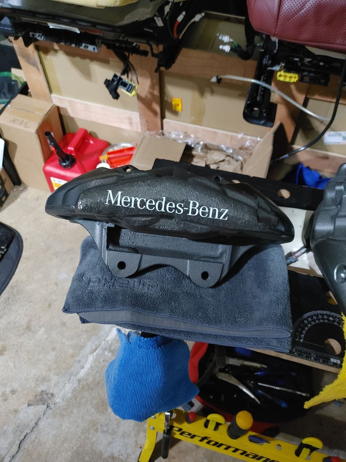

Mercedes c207
C207 brake upgrade
I just changed my front calipers yesterday what a difference!! I drive a Mercedes c207 and the w218 front Brembo calipers are direct bolt on. No need for any extra parts ..
Got any pics of your brakes?
