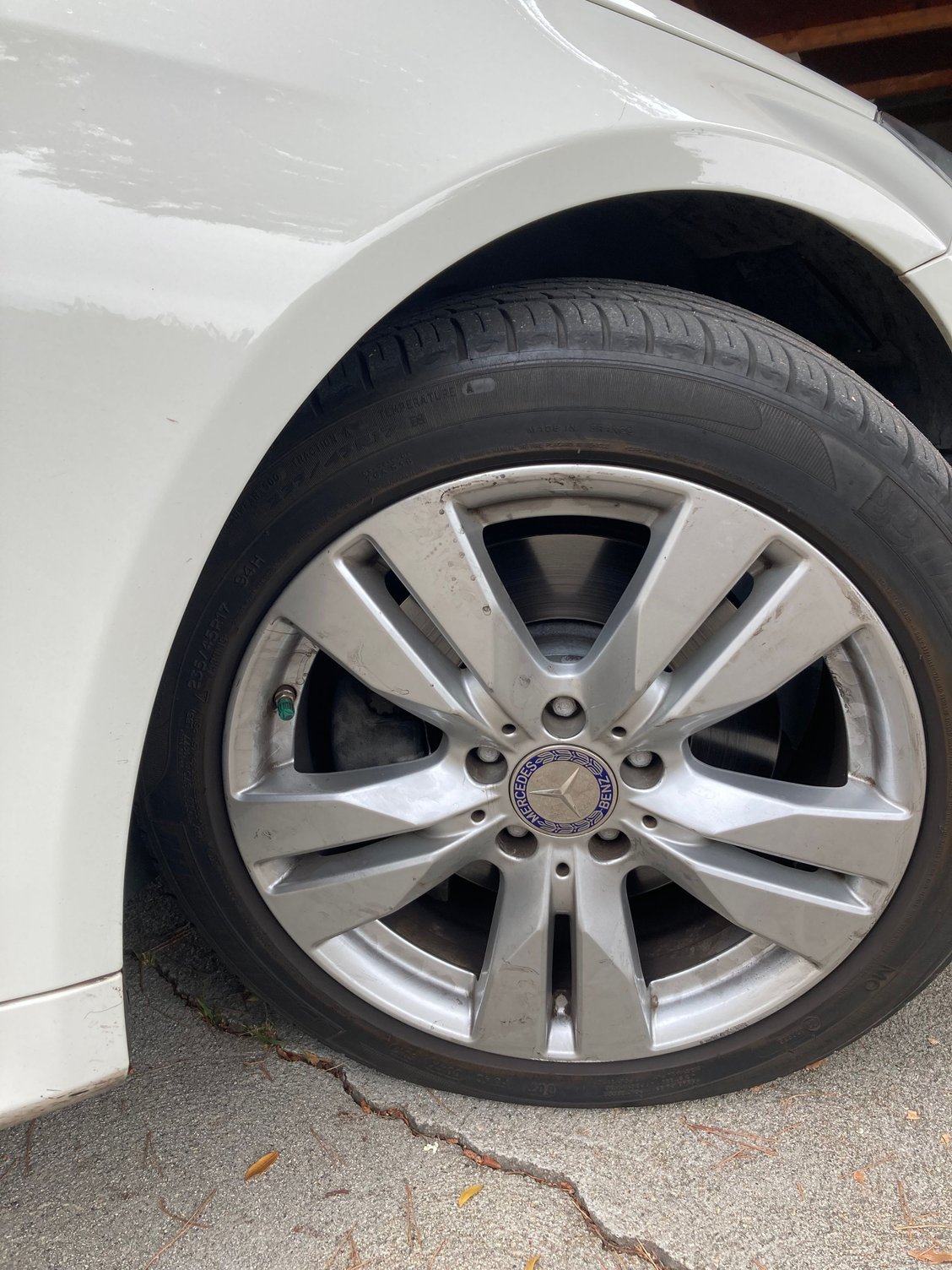

The front right tire is leaking about 2-4 lbs a day. Took it to a tire shop, according to the shop, based on the bubble test, the air is leaking from the inside of the rim. He said this is the first time he ever encountered such a leak.
He suggested to get a new rim. I am wondering if anybody ever encountered the same issue? Can this be fixed or a new rim is needed. Its the original 17" rim.

Aug 9, 2023 | 01:32 PM
one piece rim? pix plz

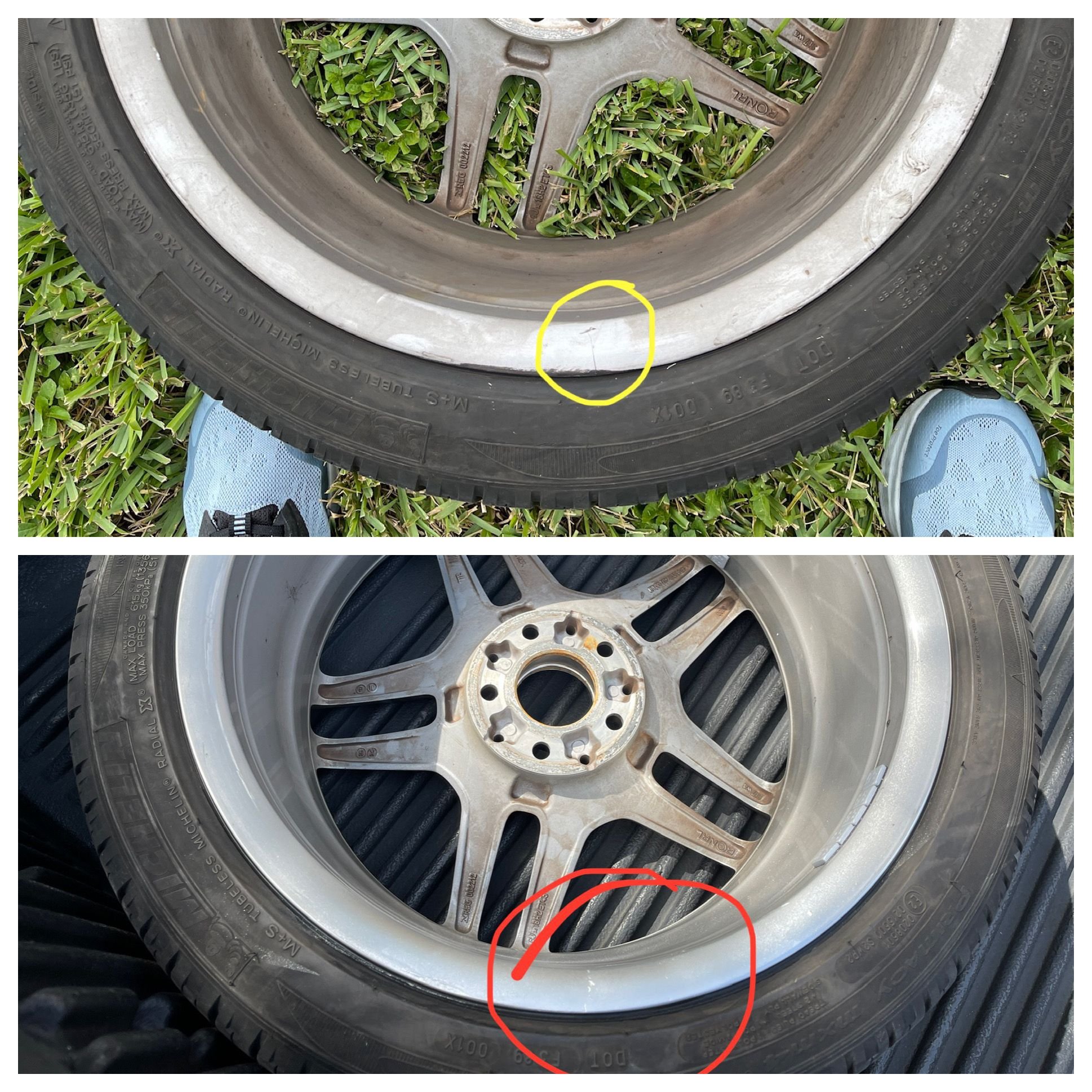

Thanks, we found a pinhole in the rim (inside), the tire store offered a used but grade B which I assume has a damage on the rim? Not sure, they said it’s more cosmetic imperfections than integrity of the rim, but I don’t have any idea. The used one is $325+tax, new one is couple hundred more, so May be new is a better idea.
or is a pin hole fixable?

Maybe fix pin hole with some sort of sealant that will stick and not fly off as it spins.
Heck wont cost much and maybe worth it.....
I would try...
Duct Tape! nah... some sort of... Maybe 2 part Epoxy?
Maybe metal tape?
FLEX SEAL??
ooooo Door window flashing that 1/16" thick black super duper sticky stuff....
just clip a little piece and cover pin hole and use roller to roll edges...

JB Weld? Cheapest fix but will it work?
A welding shop will do it for $200 including balancing the wheel. is it safe?
Junk yard grade B $350, tire shop said only cosmetic damage not structure?
New from dealer $533+$150core which is refundable if old core returned. Best choice and most expensive.

WElding would scre me as it is some sort of aluminum alloy and aluminum is a PIA to weld and not crack ..
I like the idea of FLEX SEAL - clean it up real good rubbing alcohol as last step and then stick a flex seal patch over crack.
Save up for the new MB wheel as that is good price for any part from Dealer...
