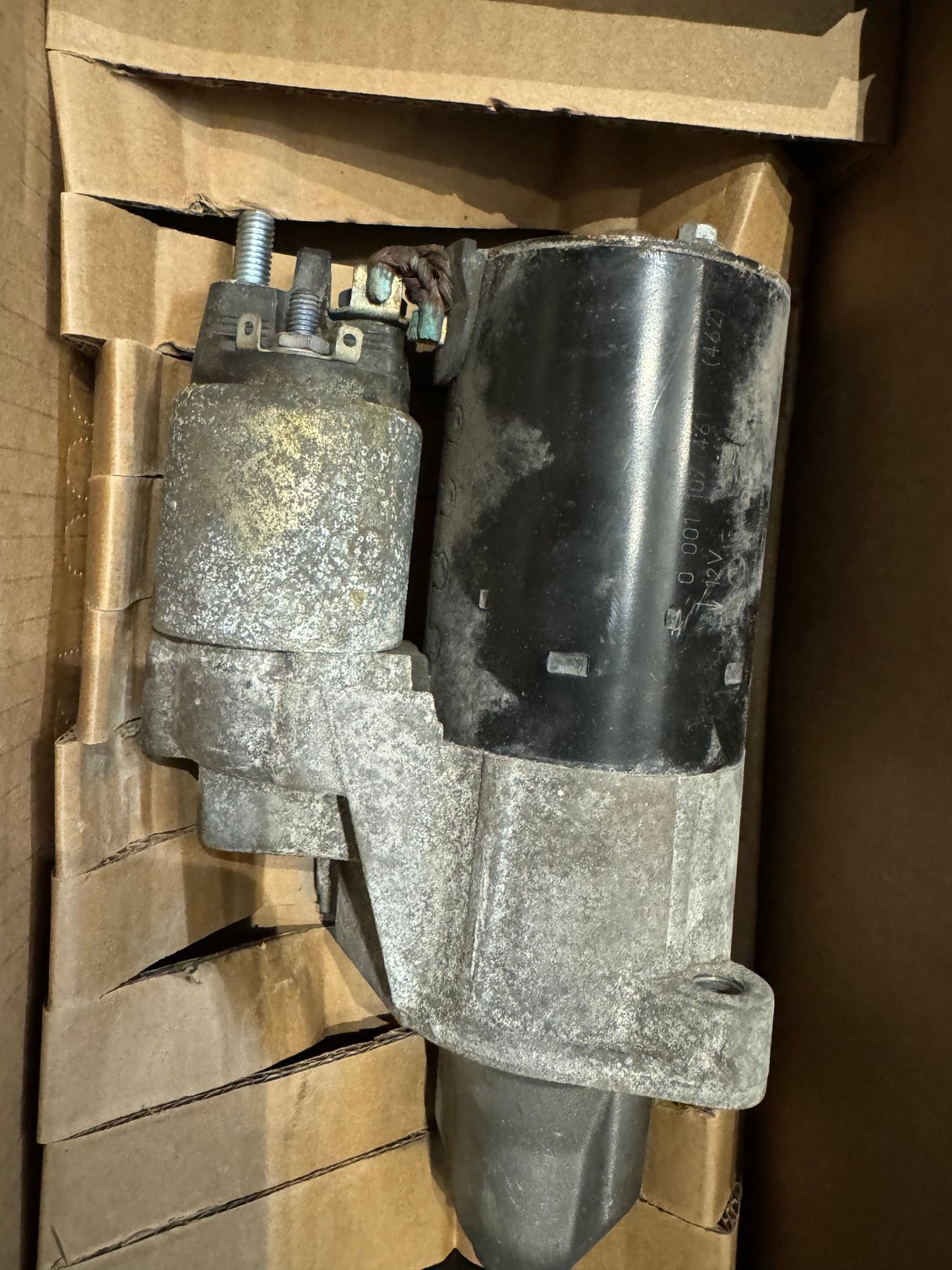

I got this as a replacement:
BOSCH - SR0811N
And a pic of the old starter is here:
