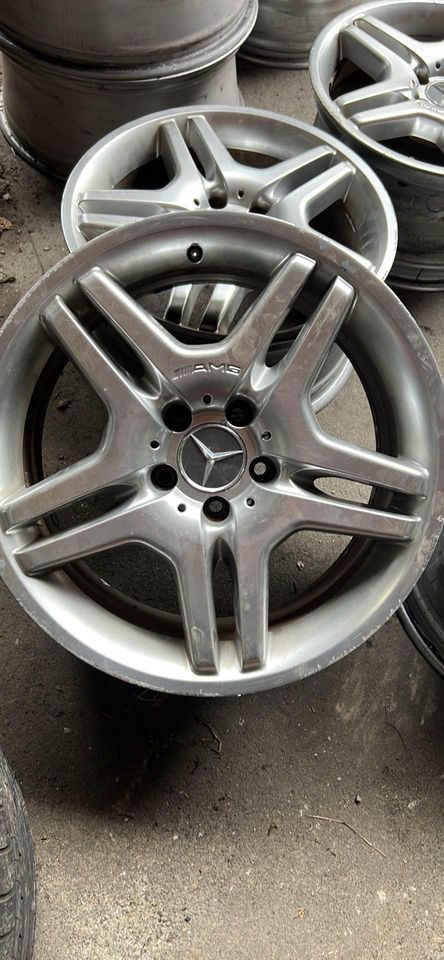

Used old S55 W220 twin spoke 5 stars
8.5 x 18 ET44 and 9 x 18 ET44
thinking 245/35/18 fronts and 265/30/18 rears

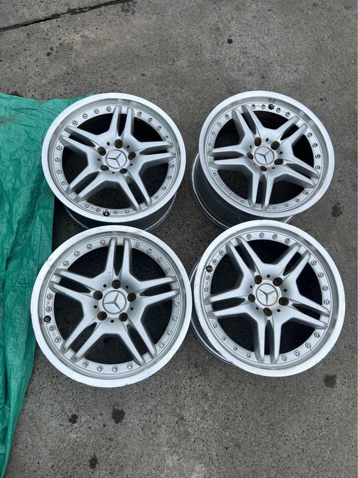

Used old E55 W211 twin spoke 5 stars replicas *like these cuz E55, paying homage lol
8 x 18 ET30 and 9 x 18 ET35
thinking 235/35/18 fronts and 265/30/18 rears

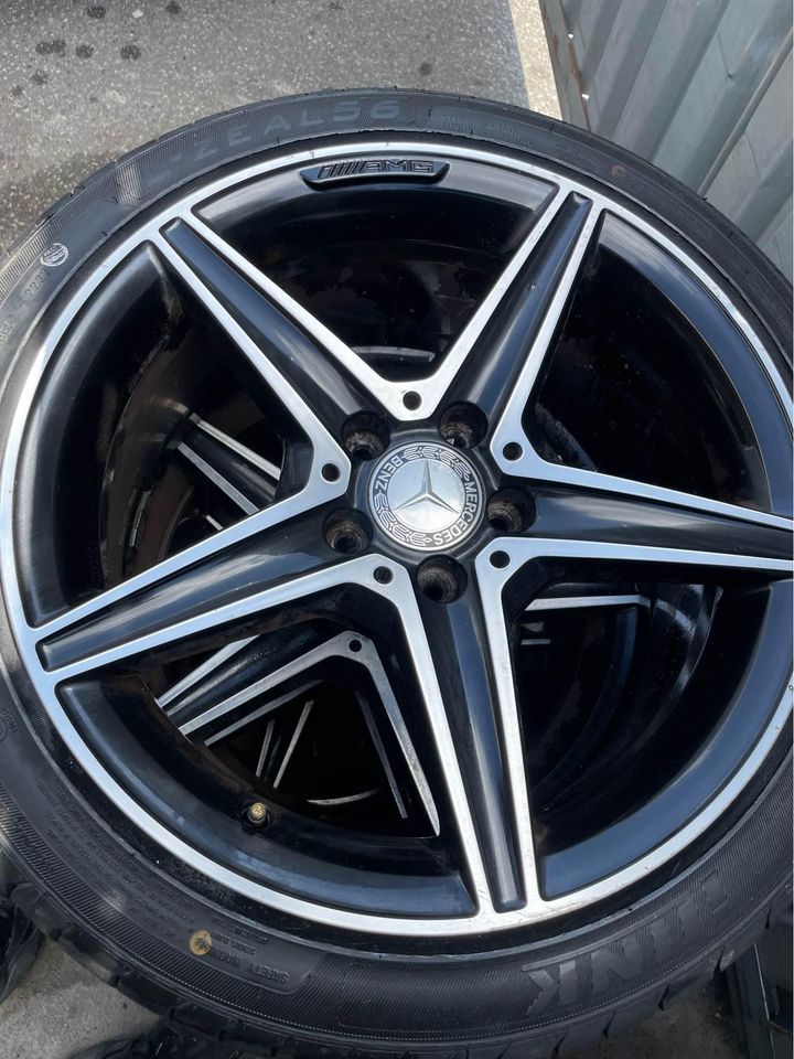

Used newer black 2 tone 5 stars *like these cuz they are newer and match my black C207, wondering about moving from staggered wheels to squared though? the tires will still be staggered.
This would be my first pick, for looks and cost. But want what FITS the best.
8.5 x 18 ET 49 squared

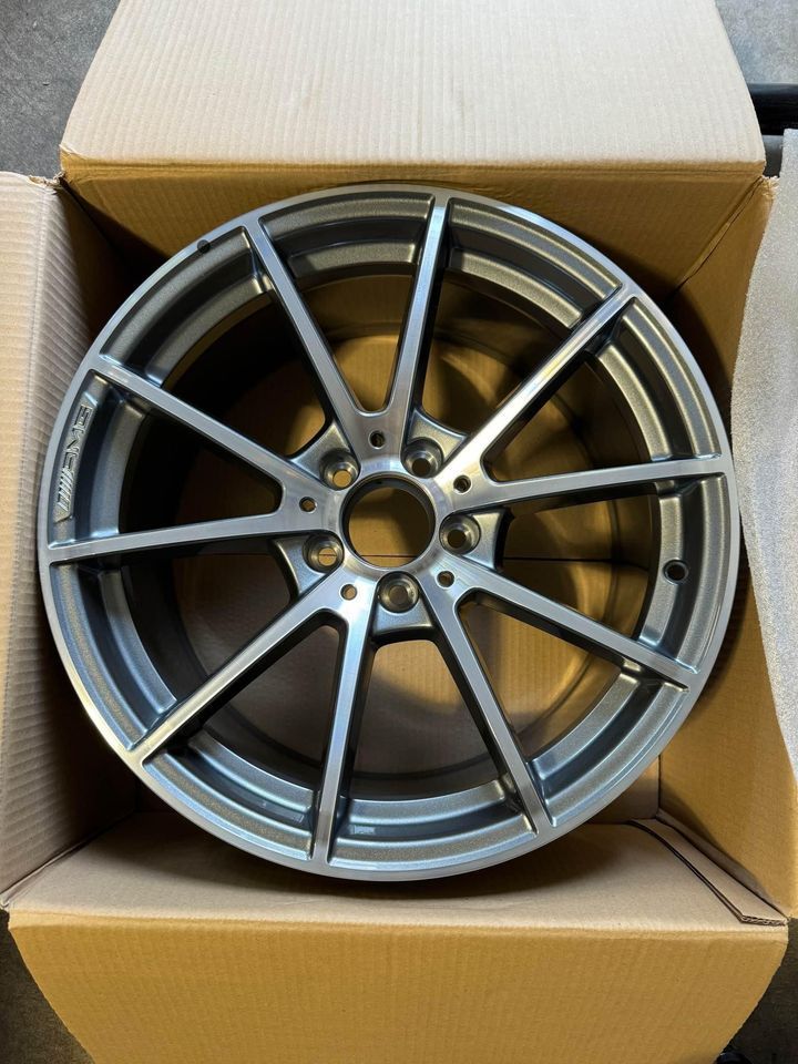

New C63 10 spokes *nice but also will cost me more.
8.5 x 18 ET38 and 9.5 x 18 ET56

The C63s.
I believe 245/40/18 fronts and 265/35/18 rears would be best for the 18s. Others can chime in on their thoughts for the ratio but standard 18s on these are 40 and 35.

although older, the E55 replicas are near top choice for me, because as I understand it, this set won't require spacers for a flush more aggressive fitment?
says fronts:
18 x 8 ET 30 with 245/40/18
will be 14mm further away from the strut than stock
and rim will poke out 14mm more
says rears:
18 x 9 ET 35 with 265/35/18
will be 6.6mm further away from the strut than stock
and rim will poke out 19.4mm more
sound right?! Thats what the online tools say, but as I'm still learning the ET 30 just sounds so low. I guess it should be OK, stock front is ET 44 so if someone used a 15mm spacer to make it flush it is effectively the same right?
