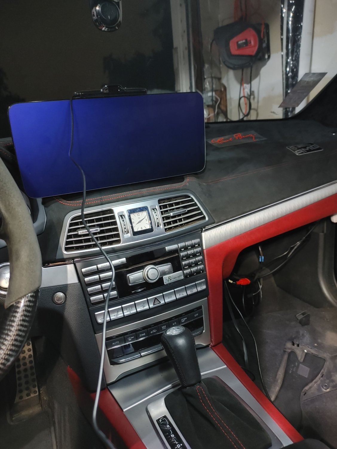

2) The COMMAND radio/nav system. The car has the harman/kardon system in it, if it matters. I'd love a radio that has Android Auto, but don't want to lose out on the OEM features like the backup camera, steering wheel controls, etc... and the radio head unit has several buttons connected to it like the sport mode, the rear sunshade and the heated/cooling seats. Is there no option to retain all that and 'upgrade' the radio system? How about the monitor?
Would this work: https://www.carputech.com/products/w...1650fda5&_ss=r
What OEM functions would I sacrifice - if any - with that?

Get the 10.25" android screen. You can switch back and forth between android and comand.
Factory rear cam is also compatible.
