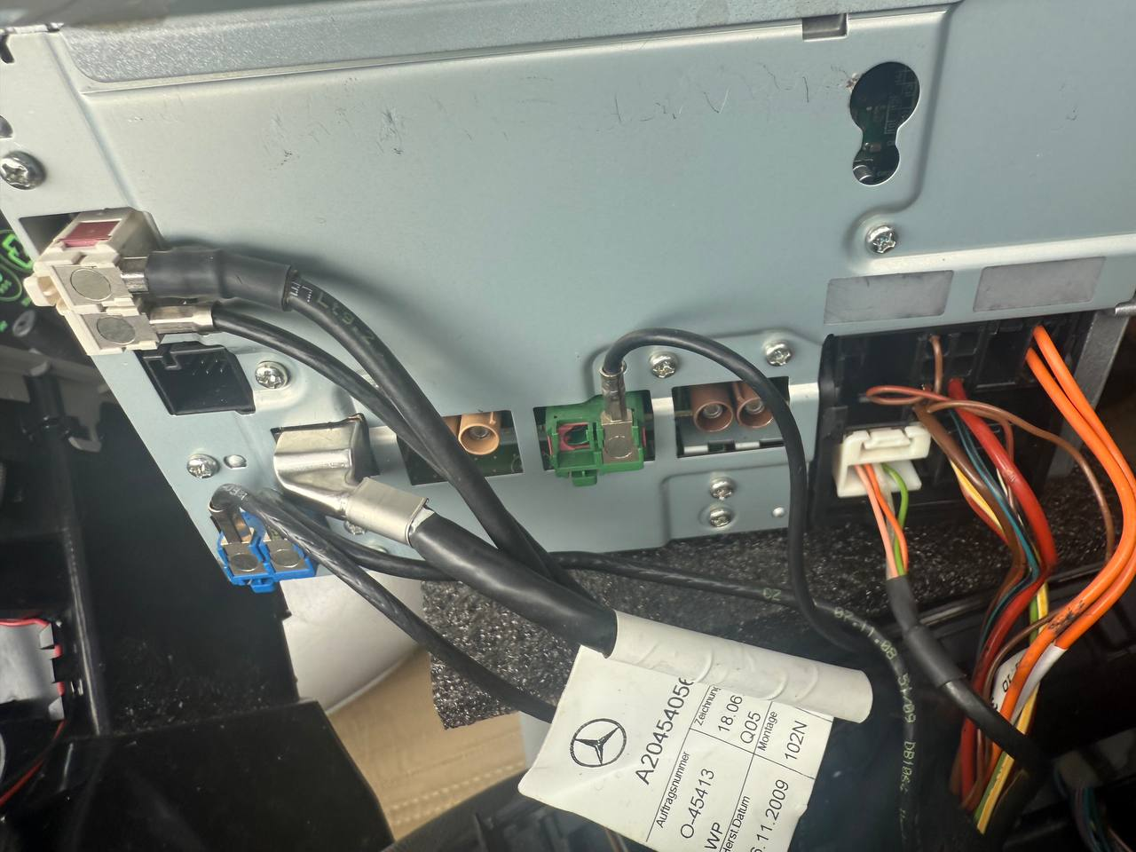

All the cables are connected except for this one that was connected to the old screen
These are the original head unit connections

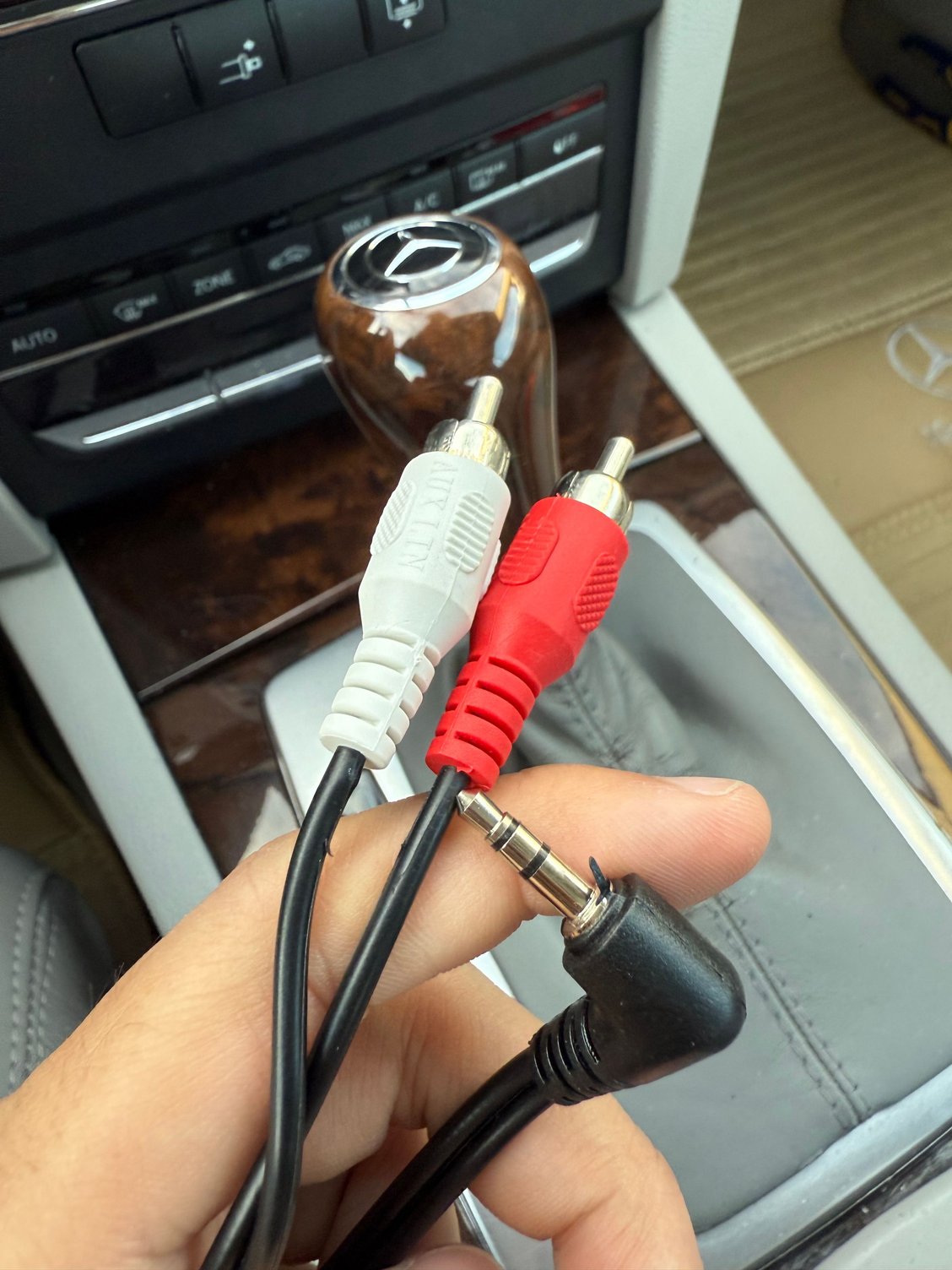

The new device comes with a audio out cable too, it's optional in case your car needs it. But I can't find where to connect it to

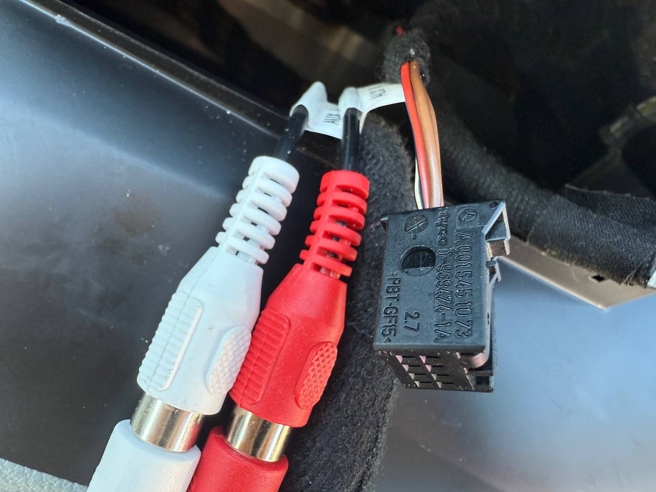

You need to connect the AUX cable to the MMI port in either the glove box or the center console. You need to use a specific mercedes MMI to 3.5mm stereo female connector then the android screen male 3.5mm cable connects there. You also need to be on AUX option in your command to get the sound working.
The audio cable you connected (red and white) are for something else. I think those are for a different input. Unless you will add something to the unit that you will need to sound rendered you do not need to use those. Look at your installation instructions. If the instruction is garbage youtube will be your best resource.

I will buy a MMI to 3.5mm stereo cable, the device comes with an adapter to male stereo that gets connected to the "red and white" cables. I have also located the MMI output in the glovebox.
I think it will be a little difficult to place the cables from the center console to the glovebox, but at least before I will try if it works or not.

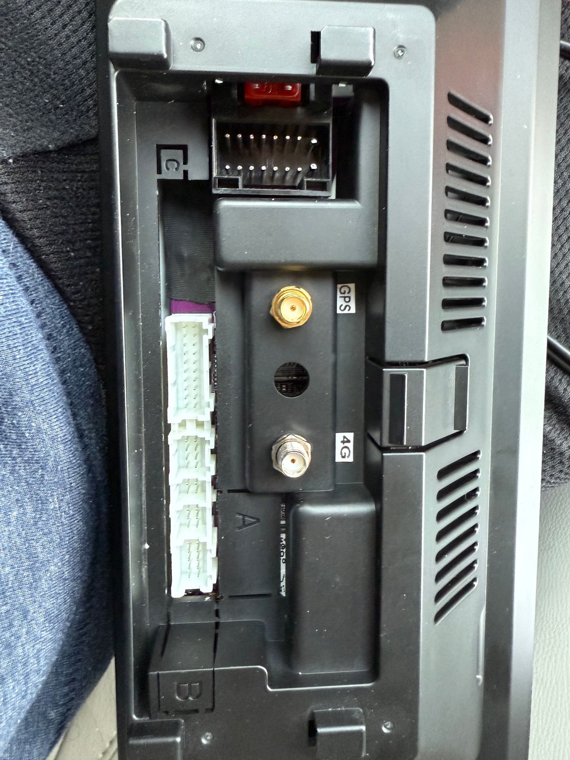

The Android screen does not have an stereo female besides the red and white one
This is the adapter I mentioned, This was my last option, I expected the audio working normally without doing this

Yes, but they suggest things that makes no sense, for example they sent me a picture showing a cable that could fix the issue but the android screen in the picture is not the same as mine, it does not have the same connections and even the power cable is different, so the cable they mentioned does not apply to my case. I'm still talking to them but I have no hope

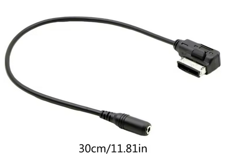

hmmm.....the back of your android unit is very different than those I have seen. I guess yours came from a different factory in China. If that is the only connectors on the harness then that male 3.5mm stereo jack goes to the MMI port (you need to have the 3.5mm to MMI connector like this....(verify your command version as this image is for the NTG4.0-4.5. I believe the later version is a 3.5mm to USB)

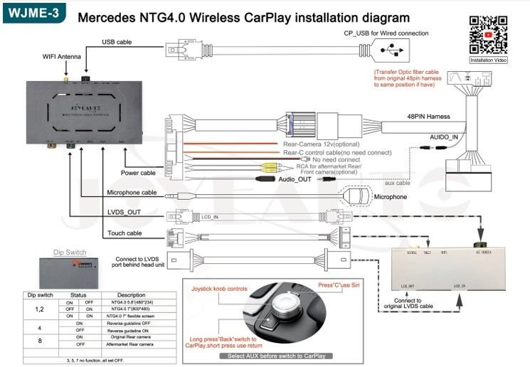

I have an NTG 4.5, so mine is a bit different. The company I purchased from also sells an interface for an NTG 4.0, which is what you have. I don't know if this will help, but here are the directions to connect their interface to an NTG 4.0.
