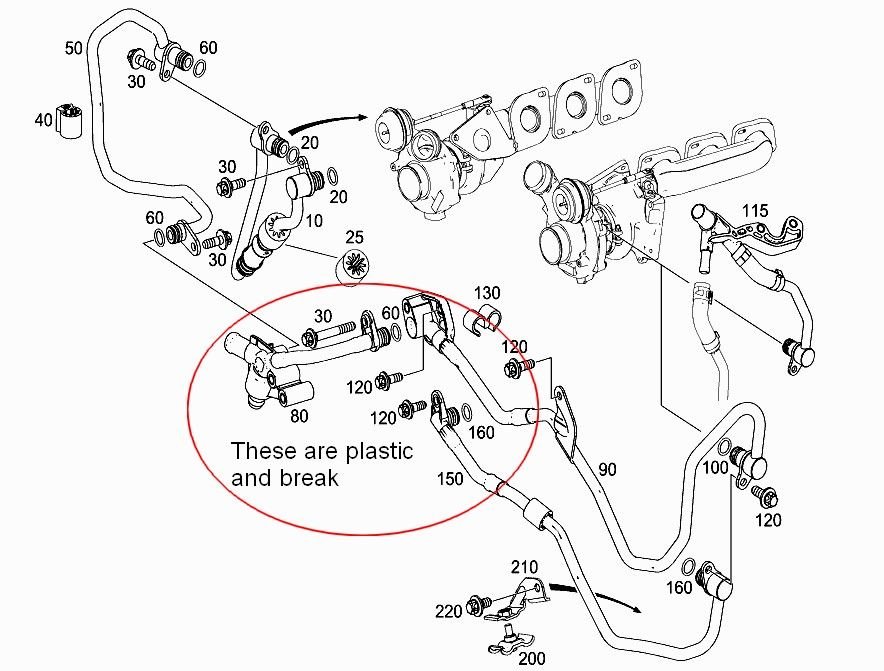

Check the coolant lines to the turbos, they leak. There are three of them made from plastic. Lots of youtube videos showing their replacement. Look up m278 turbo coolant lines replacement. The ones made from rubber typically dont need replacement.

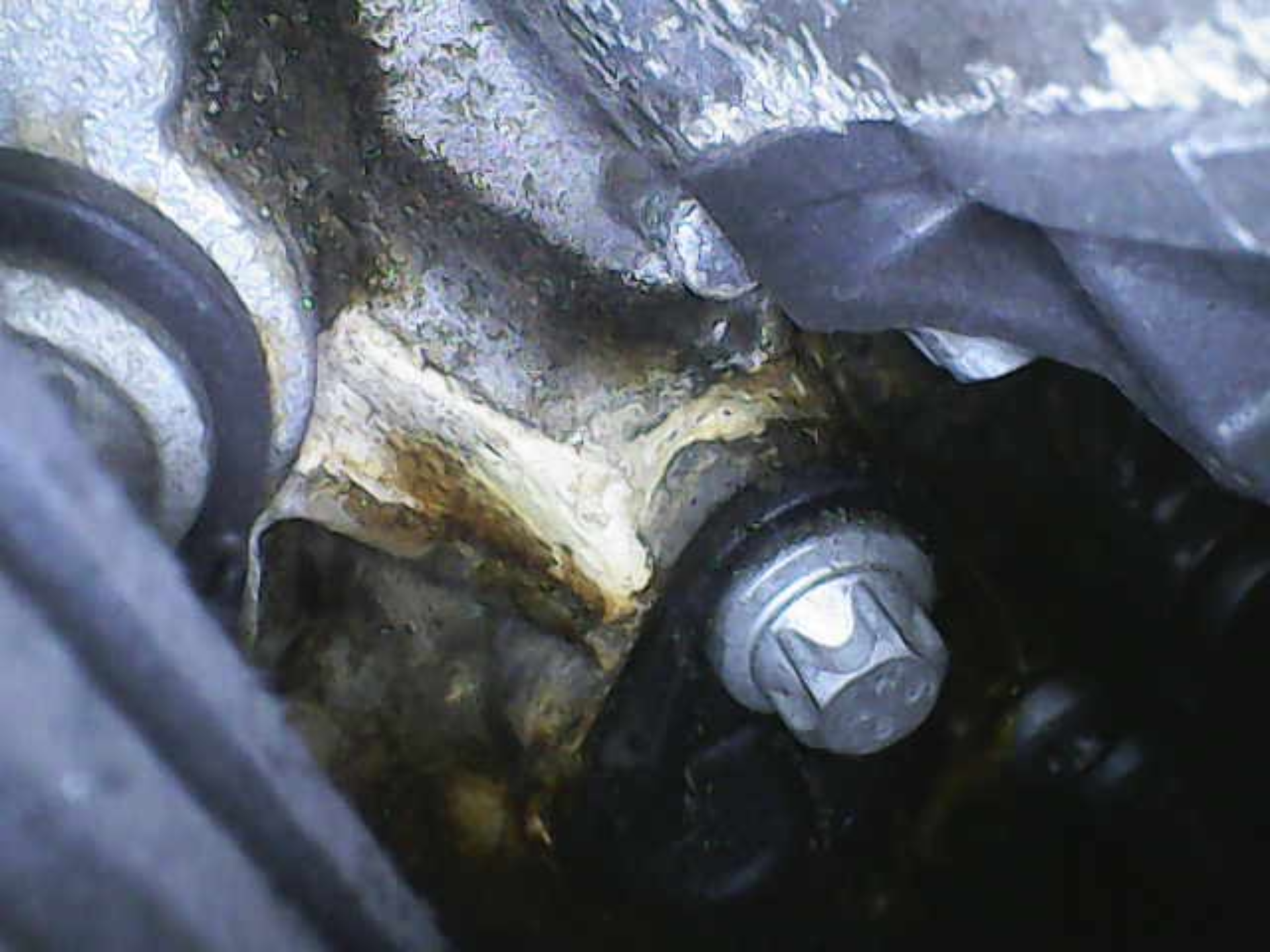

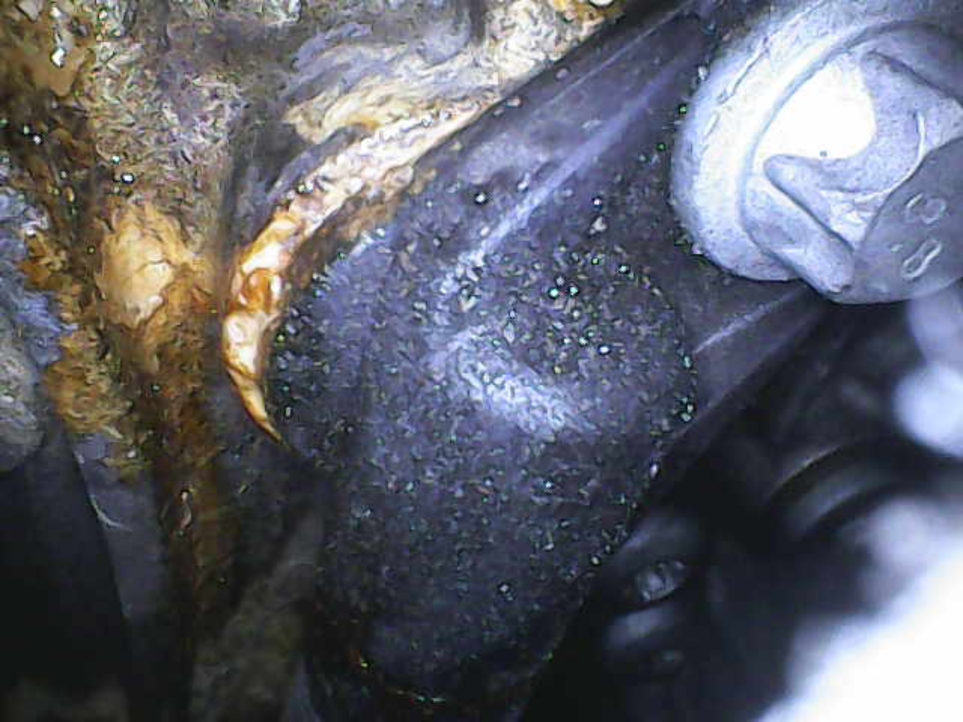

Update: I was able to grab a couple of pics around the water pump. It looks like at least two turbo coolant lines may be leaking.

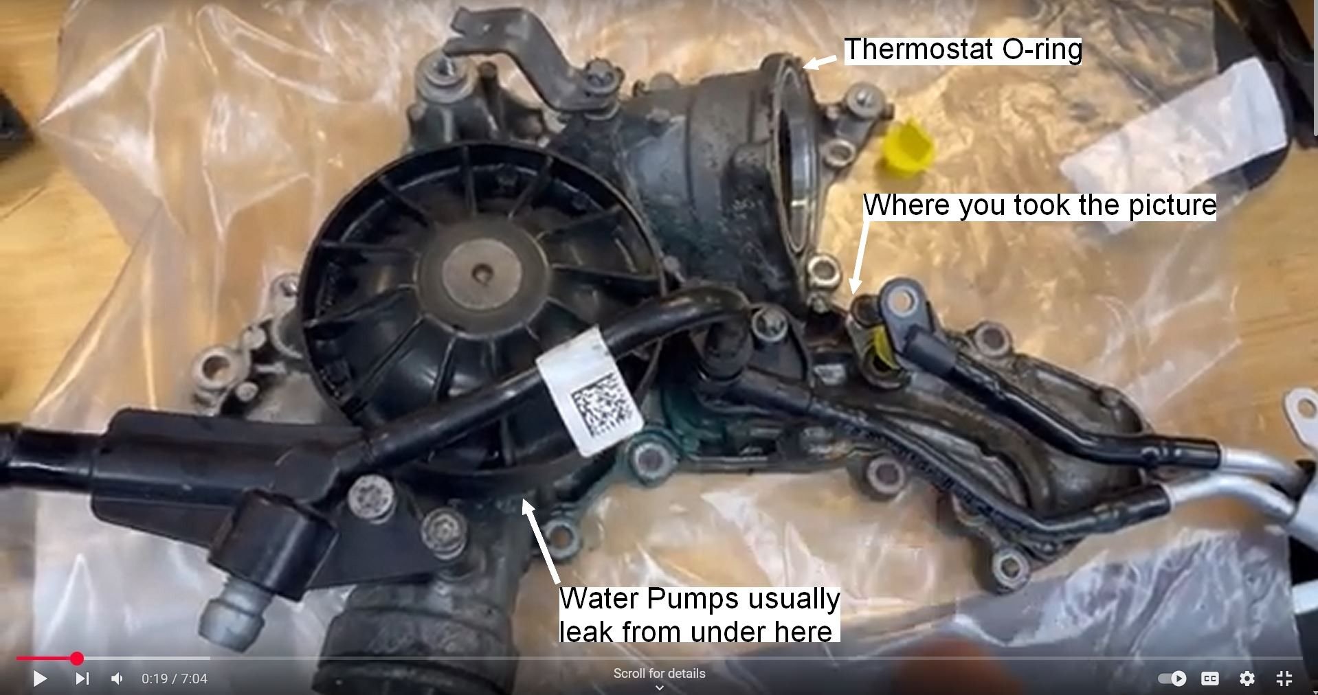

There are two O-rings behind those black plastic parts (small attached pix). And the part with the O-rings can break off, basically letting the water bypass the O-rings. If I had to guess, I'd lean toward that being your issue based on your pix, and assuming that's where most of the white gunk is.
There are O-rings on the Thermostat too, one main one (in pix) and two little ones but I seriously doubt they ever leak. I'd assume if the Stat leaked then it would have gunk on its bottom edge but it looks ok in your pix.
If the water pump leaks the water comes out the bottom, behind the pulley. I suppose it's possible it could leak from there and get slung over to where the gunk is in your pix, but it would also make a big mess at the bottom of the pump on down. Then there's the water pump gasket behind it, but it's been a long time since I've seen one of those leak.

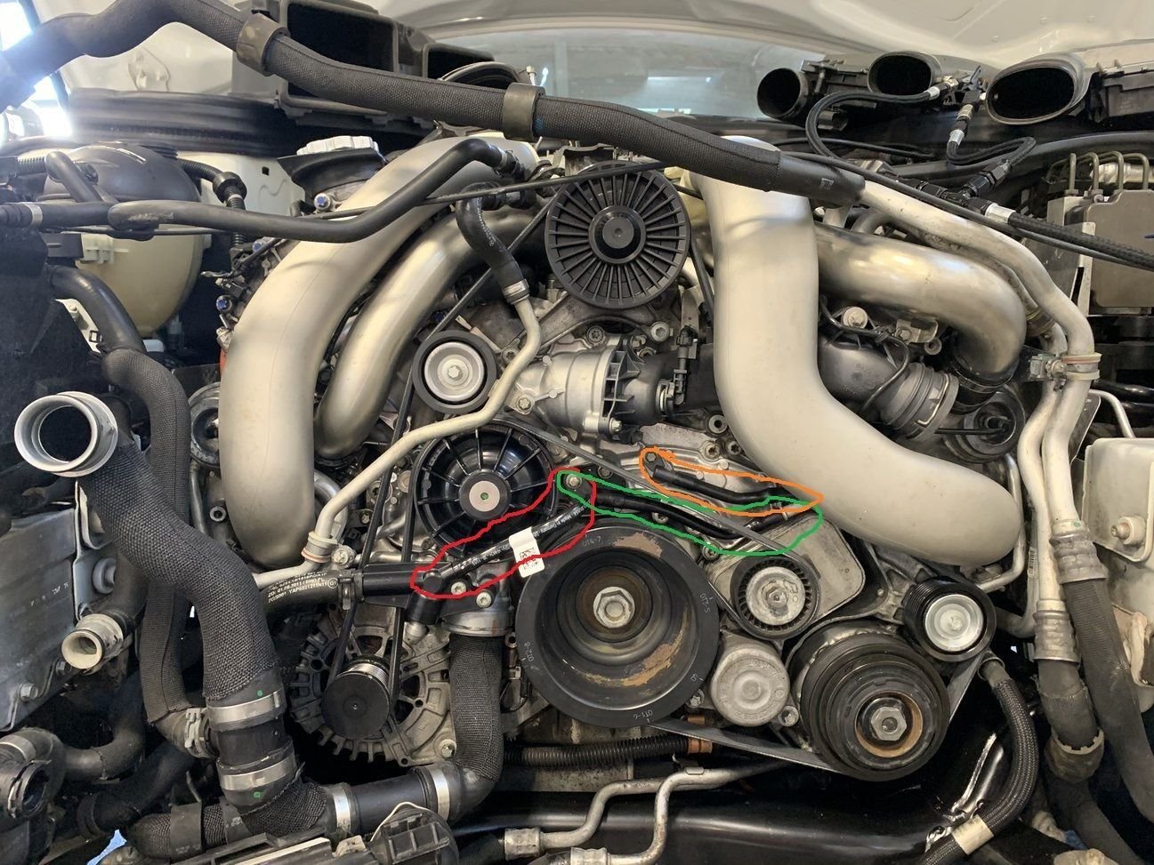

The big pix is the water pump with the turbo lines, the two problem ones and the other with the QR code label is the oddball you need to replace too. The right turbo lines and thermostat are not in the pix. Not sure if your lines are the same as the pix, but they should be more or less the same. They changed the design a little over time, yet never considered making the plastic parts out of metal.
