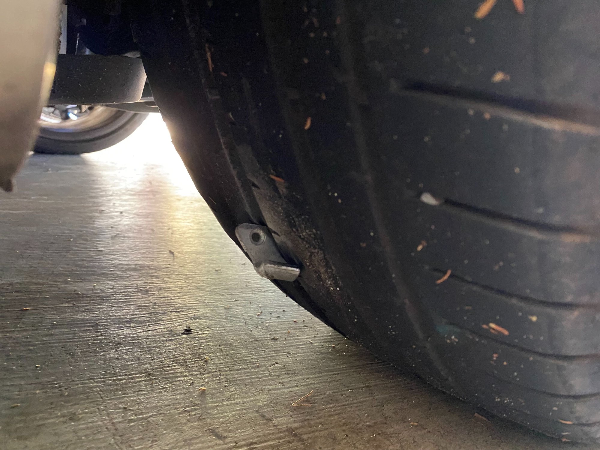

You won’t believe what I’m sure the source of the noise was from! Had to replace the original rear runflats due to the event in the photo. Decided to switch to non-runflats and ever since have never heard the sound again. I’m left wondering whether tyre bead/wheel rim were rubbing on each other? Hoping the sounds doesn’t come back, but right now it’s seems I have
the solution.

Wow! I despise runflats, have them now on my EQE. On my previous E coupe I replaced them with conventional tires and the difference was amazing. Though it seems odd that after all this time that piece of metal didn't work its way out. Good luck either way.

Wow, I never would had expected that, glad you caught it before it did any damage, good for you OP!

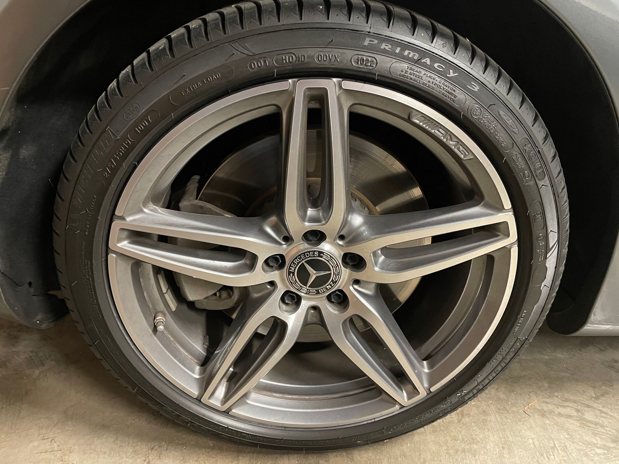

Great job OP! I just picked up a C238 of my own and I love it yet I feel the run-flats hold it back. Lucky/Unlucky for me (kind of both) the selling dealer installed 4 all-new Michelin Primacy 3 ZF (run-flat) on the car. While I appreciate the tires being brand new, I would much rather have conventional tires. If given the opportunity to swap for new conventional tires for less than a few hundred bucks, I would take it!

Might be able to sell the run-flats and recoupe some cost to put on new non run-flats. I mean, the run-flats assuming is MOE (Mercedes-Original Extended), check the tire sidewall for this info should be worth a pretty dime.
Ah! Looks like they all are MOE. Had no idea what that was until now. (see attached)
Any idea how much they might be worth with all their tread left? How would you go about selling them?

Price varies by region but throw it on this forum's market place and go from there : )
