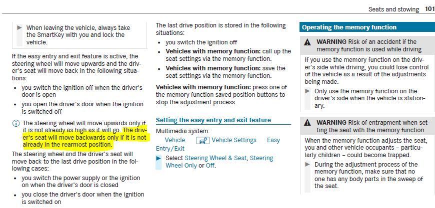

Try setting the seat to move less than furthest rear position.
The dealership tried to get away with some kind like this explanation, like the seat is already too far and quote "seat is out of the range of the easy entry/exit system". The truth is following: my seat's driving position is very far and low. When I turn off the car and open the door, the easy entry/exit system LIFTS the back of my seat (as well as the steering wheel) and I get out more easily. When I get into the car and close the door, easy entry/exit system lowers the steering wheel AND lowers the back of the seat to my driving position.
Before, when I was getting into the car, closed door, the steering wheel went back to driving position and the seat DID NOT. And yes, the setting of easy entry/exit was set up for both: steering wheel and the seat. Obviously there was a software issue.
Just take it to dealership and show them and leave the car. Why digging into the problem that is already paid to be taken care of by manufacturer/seller? The seat HAS TO be brought back to the memory setting by easy entry/exit system. Period.

So.... for those who may not have known a DIY reset to different position could resolve the problem without having to schedule a visit to the dealer this is why I posted manual page. Exact same problem dates back to the 211 this is why MB discontinued the feature for a while. Now then, dealer most likely reset the feature using Xentry (MB diagnostics) what does the narrative on your invoice document. If, in fact, they updated the software then so be it.
