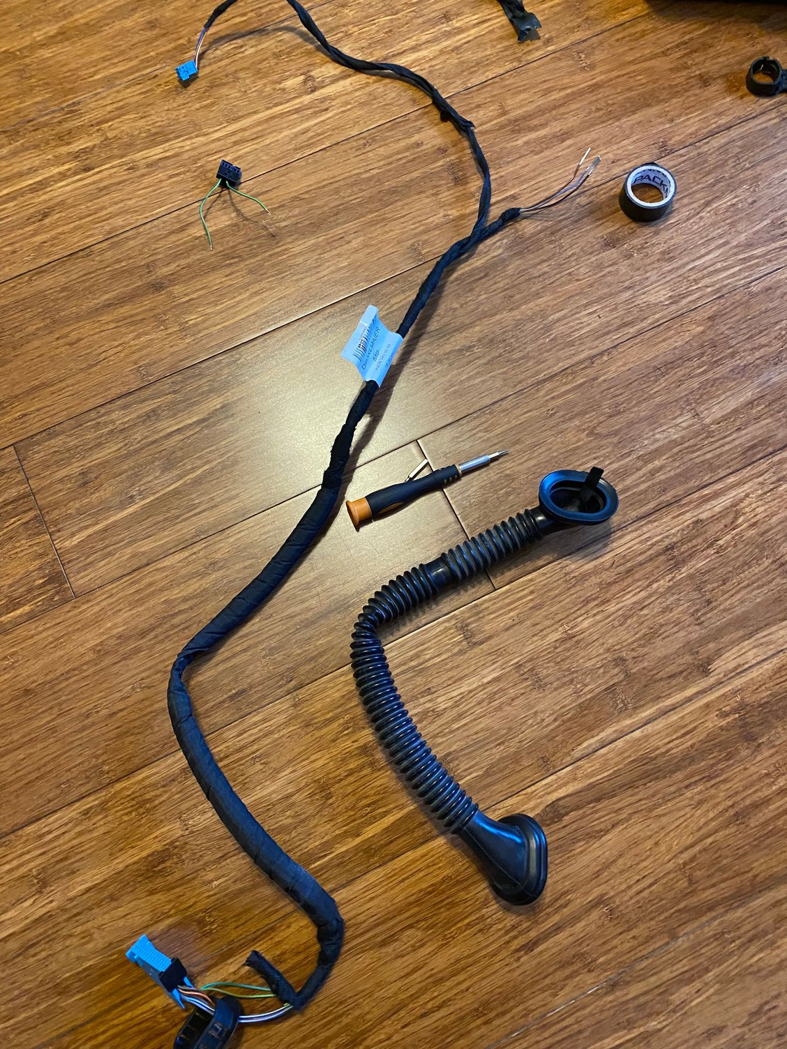

Hello Dave! This is a response sometime after your original post, however I had the same issue on my car with the effect not working (light coming on solid instead of like a curtain).
I initially thought there was an issue with the inner light assembly, but I plugged it in on the other side and the curtain effect worked.

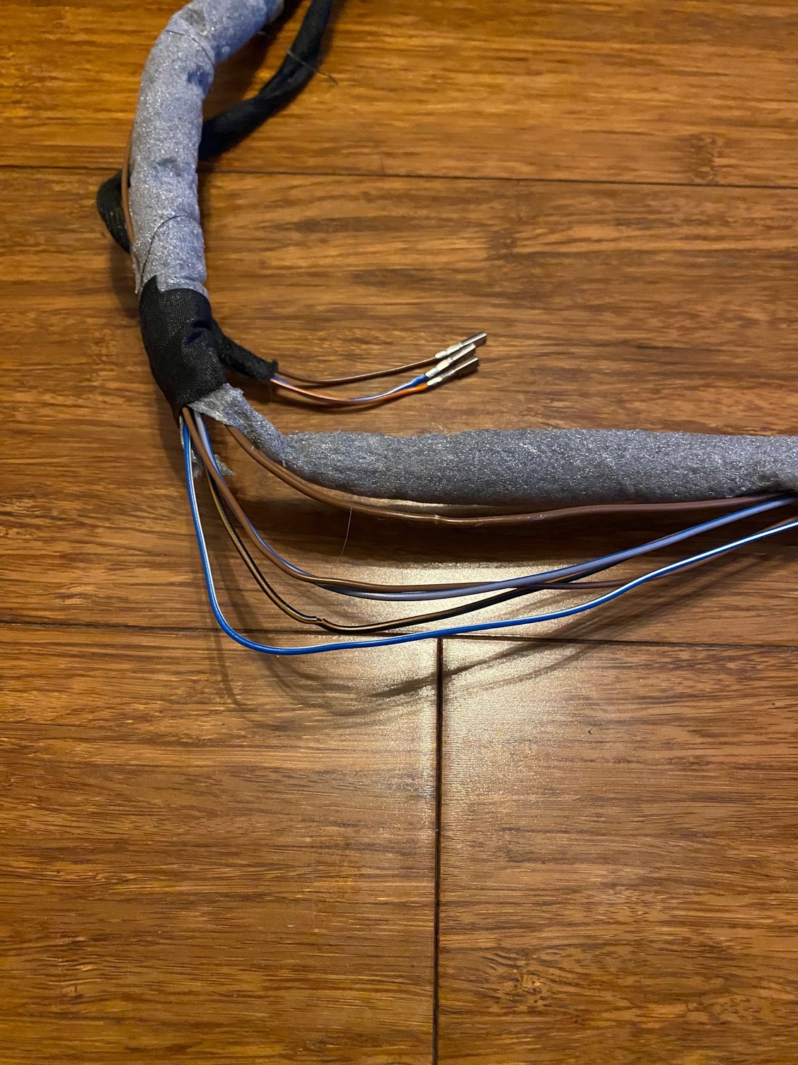

So, I proceeded to get my multimeter out and test continuity across the wires to the light. There are two green wires (green with orange stripe, and green with blue stripe) that were broken. The break was in the wire harness at the bend in the hose between the boot lid (“trunk”, in American English). With age, it appears to have collapsed so when you close the boot it pinches on the wires and has broken them.

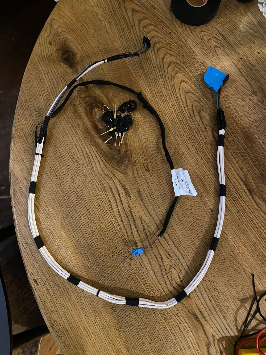

I rewired the entire harness with same gauge wire (but much thicker insulator) as when I pulled it apart more of the wires broke at the bend. I also had an error code in Xentry for some time about the partition switch having an open circuit or shorted to ground so this explained it all. I used old-school solder joints with heat shrink on each wire and verified all the connections were correct with a multimeter before reinstalling.
In the meantime I’m torn on whether to order and replace the harness to restore to factory, or to keep my repaired one and route it within the trunk instead of the factory hose to avoid it breaking again in X year’s time. Another option is modifying the hose with a thicker middle piece at the bend to accomodate my repair (and reduce chance of that breaking).
Despite above, I’ve reinstalled the empty hose to ensure the boot and boot lid remain water tight.
Hope this is helpful for you and others to fix this issue.
PS: Another important consideration is the harness on the other side, as it would be likely to start failing at the same time if there is a pinch point forming. That harness includes the latch, camera, and light (if the wires to the latch break you’d be locked out of the trunk, unless you have Xentry and can actuate the rear seats or you start the roof open routine to raise the rear window and rear top panel).

Good for you on the DIY fix!
