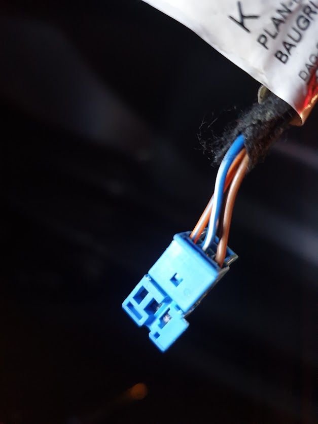

the connector with the altered position of the cables.
Modded button to fit the connector in opposite way
works!

Finally, i got the problem solved.
I purchased the car on April and the button never worked. I removed the button, it seemed ok to me, but i ordered a new one on MB dealer in Valencia (spain).
The new button arrived, and it didnt work neither, no light, no work, then i investigate what the switch was doing and i found it simply make contact with 2 of the three pins.
In the cable, there are three cables, blue (+12v), yellow (+12v) and brown (return), but misteriously, the button switches the two 12v pins, qhat makes no sense for me. i make contact the brown with the yellow and the separator opens and close. Y modded the switch and change the pins order and now the button works, it lights and work. Its very weird, but someone in any way, has changed the pins of the connector who is attached to the button.
Anyway, now it works. happy ending. Thanks to all

You're a genius - well done ! My connecter has a block connector so looks a little different - and it's inside this tiny block connector that I had the "corrosion" - so it was difficult to clean. Well done for figuring out the connections !
