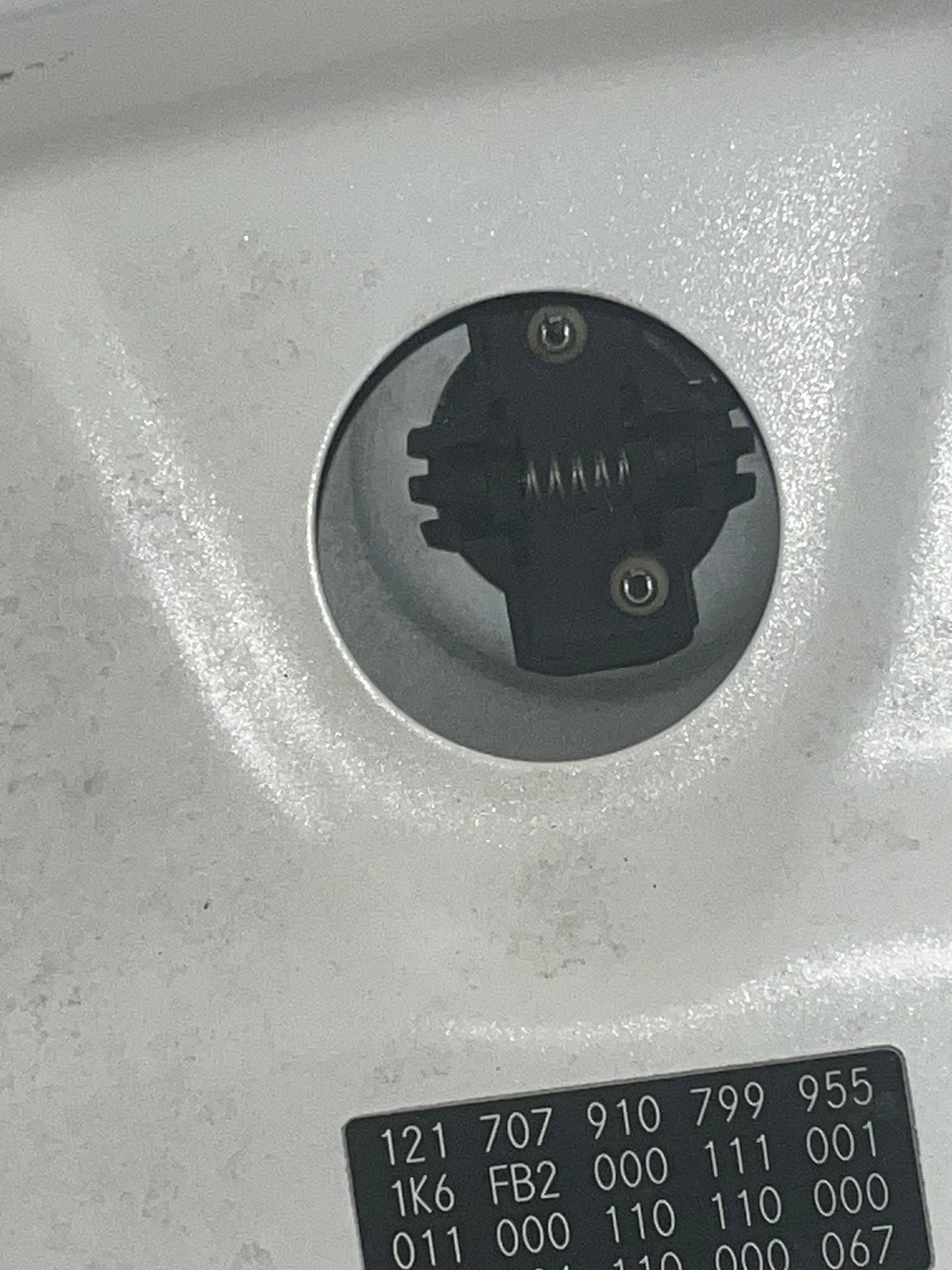

Did you originally have a flat logo with a hole underneath or no hole, I would like to do the same mod on my EQE350 2024 but I am sure once I remove my flat logo there will be no hole to install the new logo, I don't want to drill the hood, just wondering if anyone else has done this mod without drilling their hood.

no drilling required

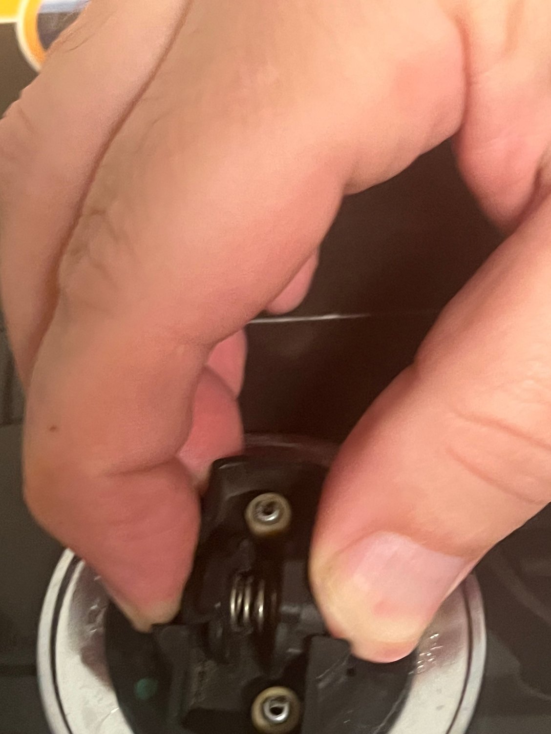

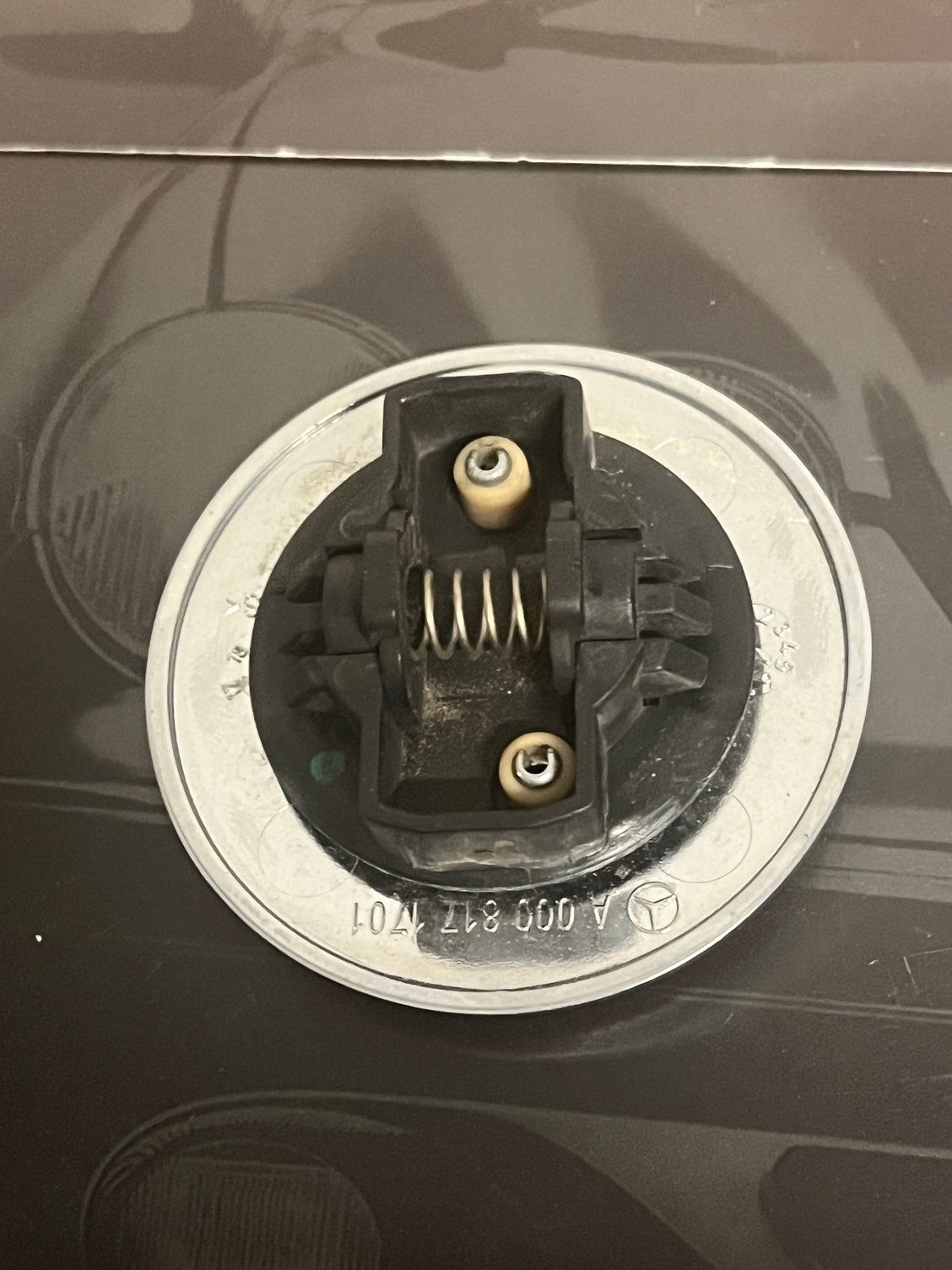

you just squeeze the plastic together to release the latch and when you reinstall it just presses in place
With the badge removed it is easy to compress the latch.
A close up of the badge after removing it
Opening in the hood to access the badge. I used needle nose pliers to remove it
