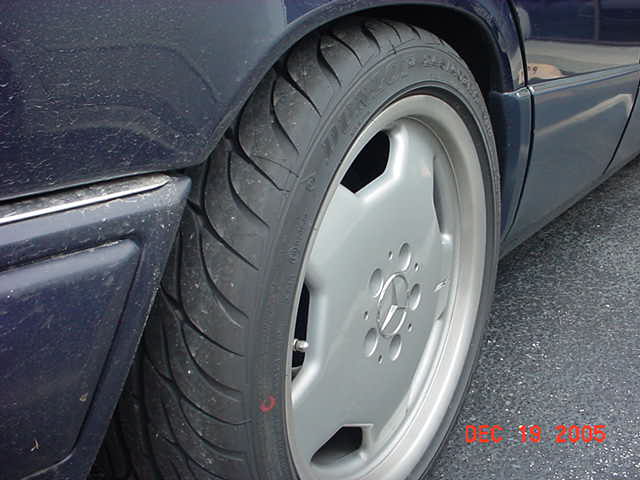

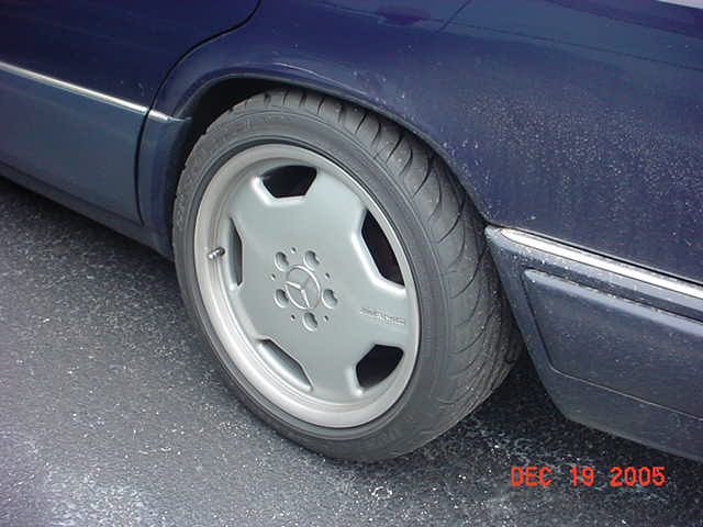

I droped mine, the back did rub some so I rolled the quarter panels... everything "OK USA". will post pics soon.

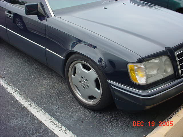

Old Dec 19, 2005 | 04:04 PM
E320BENZ's Avatar
Joined: Sep 2004
Posts: 247
before.... and after

are those all afters? If i do decide to keep the car, then ill probbaly put on some 18's. what suspension did you go for? sport? did you put any sway bars? and did you roll the fenders yourself?
Old Dec 20, 2005 | 01:57 PM
E320BENZ's Avatar
Joined: Sep 2004
Posts: 247
All afters.... rolled only the rear, E500 sway bar in the front eibach sway bar on rear, H&R sport springs, bilstein sport shocks, all new bushings, K&N filter, flow master muffler, removed cat. and front muffler,.... sounds like a SL55 AMG it's silly....
