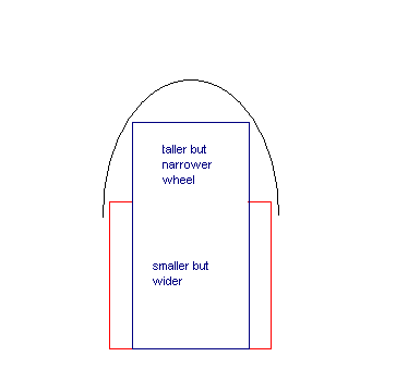

I know it dosen't make sense to you but you have to go with a smaller width and more offset to clear the top of the inner fender. I can write an essay about why you would do this but i'll make it simple. The bigger the wheel the less clearance you have on the top of the fender and since the wheels is bigger it will angle more into the inner fender. Also a 8.5 width wheel personaly won't look that good with a 225 wide tire.
the lower the height of the wheel the wider you can go because you don't really have to worry about the inner fender and just roll the outer fender lip. You can go with 17x10 but not 20x10 since that size won't tuck under the wheel well but 20x8 will with the right offset.
There are two ways you can go with buying the right wheels.
1. Fit the tire to the wheel you want to go with. First buy the wheels then find the best fitment of tire you need.
2. Find the tire you want to fit and see how it fits then get the wheel with the right offset to fit that tire. This method i use when i order custom wheels.
Let me draw you a diagram so you can get what i'm saying...

Wait, are you telling me that if I stick to 17", with the right offset, that I could go 10" wide?!?!?

you can go with whatever size rim you want, as long as you shrink the sidewall to keep the same overall diameter...

Yeah you can ride 17x10 if you get the right backspace. There is no way i would put anything above 18" without the wheel tucking under the fender because that just dosen't look right.
Dude, If you think like that that means riding on 30 series tires is a good idea..right?

Haven't you wondered why the car is not lowered??....You can fit the widest wheels on earth but that dosen't mean they look right and unless you put some kind of of spring clamp or something it's going to rub when hitting a big bump.
You can ride like this if you want but look how high the car is.
