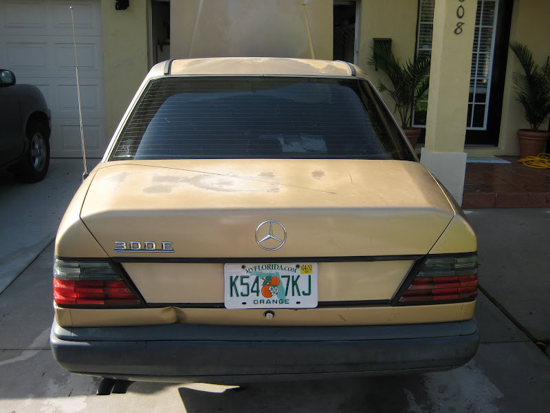

Quick question Ps2cho, You're 260E is the Third car I've seen with a bend/dent in that area of the trunk. Just curious if you know how it happened
OT, but another twilight zone dent in the same spot...

You won't believe this but I found a pic of my old '86 (my second 300E) low and behold: There's some conspiracy here...
LOL!
