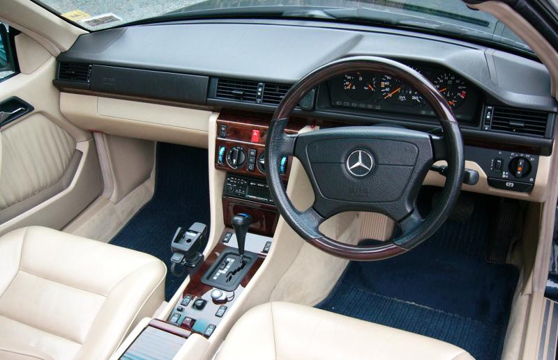

Can you please get me a part number!
I am trying to replace the one originally fitted to my car by the factory but the MB part number in the system is wrong - yes wrong. You get a grey wheel that wont accept the airbag and shocking quality. The wheel you have is the correct wheel for all Sportline 124 Cabriolets for the Aus, NZL and European markets at least. See picture of mine attached.
Has yours been recovered? Does it have the deep grained leather you can see on mine in the spoke area that hasn't worn.
Can you please get me the part number if at all possible. I am going to stump up the necessaries for a brand new one - again!

Based on what I see in your picture, it looks like you have a 2000 C class wheel, well at least its a 2000 C class airbag. That might explain why your having fitament issues. Starting in model year 1998, the internal design of the steering wheel/airbag changed, so for example you can not put a 95 airbag on a 98 wheel, externally they look like they will mate, but the internals differ.
