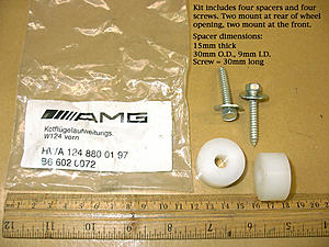

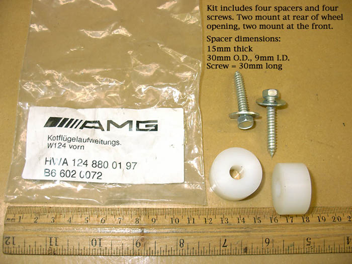

Use the spacers on the front mate
Old May 6, 2011 | 08:59 AM
RBYCC's Avatar
Joined: May 2005
Posts: 2,494
Likes: 17
From: REHOBOTH BEACH DE
88-300CE TWIN TURBO, 99-C43, 05-G55K, 71-280SL, 94-E320 CAB, 08 CLK63 BLACK SERIES
Originally Posted by Shoomakan
I think the fronts are more of a problem. I've got 9.5's in the rear and with a 35 offset I have no rubbing issues.
The fronts are 8.5 with an offset of 31 and they're killing me. And I've rolled my fenders.
A few more mods are required as per the pdf. along with the spacers that Dash has mentioned..
I fabricated the spacers from teflon round stock..cut to thickness and drilled the center screw hole..
