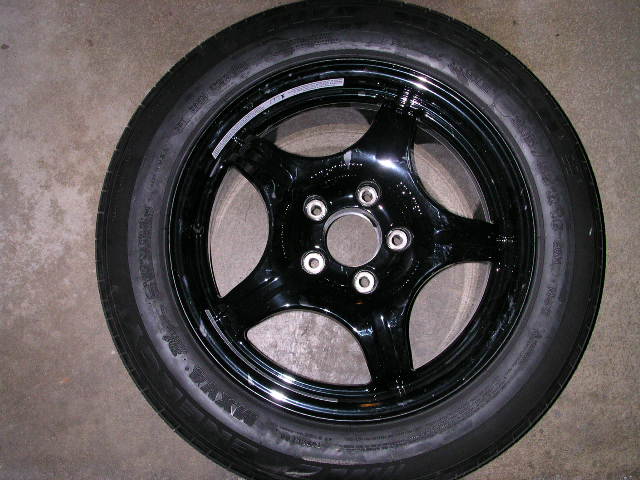

Hi,
I just saw my spare tire this afternoon, and found the wheel is different.
I was thinking about it might be stolen... but, I might be wrong. :p
Please help me to confirm it is the original spare tire.
Thanks,
Ben

Yes, that is the correct wheel. It is a light weight wheel that is not intended to be used at high speeds or for a long distance.

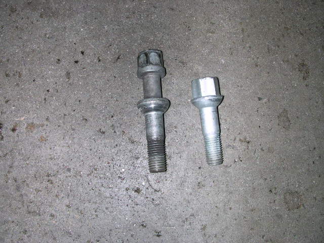

Just to clarify: the stock lug bolts, at least on the older models with 12MM lug bolts and alloy wheels (which includes all of us W210 owners), will NOT work with the factory spare as they are far too long for it's much thinner steel mounting plate. Not only will it be impossible to mount the spare securely, it will also probably damage the car because the bolts will extend too far inside the hubs. That's why the tool kit comes with a set of much shorter lug bolts to be used only for the spare.

My spare looks like picture in this post. That wheel is an alloy wheel that is painted black. The lug bolts that I have are very long so that the head is flush with the standard wheel but have the ball flange a couple of centimeters down on the shaft of the lug. These lugs actually work just like the new short ones that are standard for the W211s.

I used both lug bolts from W210 and W203 to insatll the spare tire.
Both run without problem.
Only W210 lug bolts look funny, standing outside with a head.
