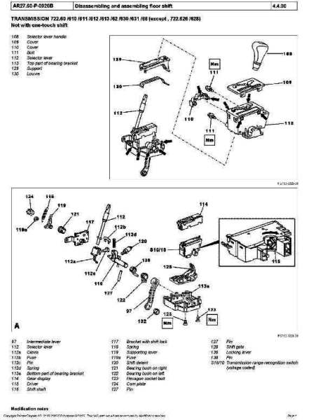

I've attached the exploded diagram of the floor shift....anyone know which bushing is the issue?
Attached Thumbnails Gear selector vibration/rattle-disassemble-floor-shift_page_1.jpg

Can't see from the diagram, but I just had my gear lever bushing replaced 3 days ago. It's a cheap and quick job, and it's removed that metallic 'click' that happens when you shift to D.
