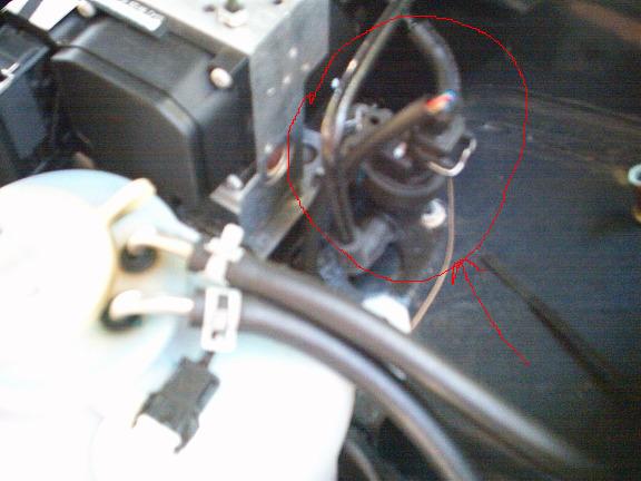

What is this and should it be ticking?
Driver's side near the window washer fluid reservoir.
THX
Bob

Ahhhhhhhh, it's a bomb, run, run away!!!!!!!!
Well, that was worthless, now wasn't it? I'm sorry.
Could it be something to do with your ABS braking system?

Mine ticks as well, exact same thing.

Mine ticks occasionally too...but I always thought it was the silver ETS/ASR module just inboard of what you circled. Guess not.
I tried to cup my ears and closer feel for what was actually making the ticking and the sensor seems a better guess....

Answer
posted on another site:
RE: What is this and should it be ticking?
That is a purge valve and yes it ticks or pulses not all the time only when needed and during a obd 2 self test.It is used to vent the excess vapors ect. in the fuel system.
Sam
this is what i was told by the MB dealer.
but my car makes the ticking noise constantly.
it makes the noise at the same pace all the time, especially when the car is on but in park.
its just getting worn and it works in a louder state, get a new one and you shouldn't be able to hear it. depending on the mileage of your car it may be leaking vacuum too... check it out
