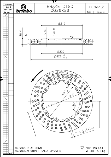

upon closer inspection, looks like your rear rotors are on backwards. Brembo rotors incorporate directional vains, to expell hot gases away from the rotors. Did you install the rears yourself or have someone do it. Your fronts are correct. Notice how the pattern direction of the fronts differ from the rears. your rears should mimic the fronts. Its a very comon mistake. I look for the manual on-line which should have indicated to you the direction. Not trying to bust your *****, but after 17 years of racing I have learned all these lessons the hard way. So just try to help out a fellow MB owner. Give me a sec to download the manual.

Here you go, straight from Mike & the guys at Brembo.
Brembo Grand Turismo Kits
MERCEDES E-Class Rear (W210) 1996 -> 2002
Kit Part Number: 2C1.6009A (drilled rotors)
you know, you are correct. I was looking at the pictures earlier tonight and I realized that. It's no biggie, I'll have it fixed but it sucks it was put on backwards...

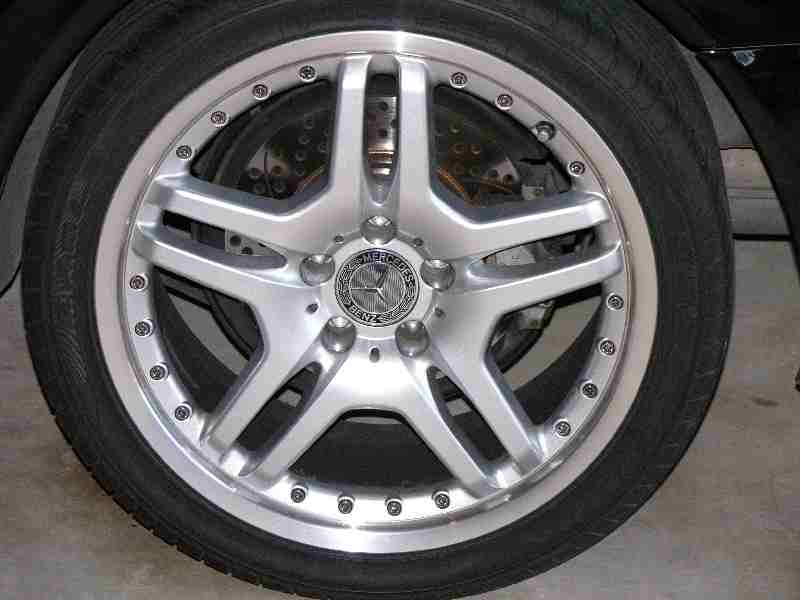

Guys sorry to hijack this thread, can you tell me whether my drilled rotors are on correct. I have attached a pic of my drivers side rear, my fronts are in the same direction. I have noticed that since I put them on with new stock pads they have been noisy as hell and squeek alot.
I don't think AMG employed directional rotors like Brembo...a bit weird but that's a sad fact.
Thanks Whitey so are my rotors on in the right direction?
Old Feb 5, 2006 | 10:05 PM
Whitey's Avatar
Joined: Apr 2003
Posts: 4,169
From: HK (but constantly travelling)
98 W210 Advantgarde
Which side of the car is that pic? Oh, wait, u dont have AMG brakes...sorry...
Old Feb 6, 2006 | 02:27 AM
Ben'z's Avatar
Joined: Dec 2004
Posts: 1,076
From: LA/OC
E320
I think it is rear driver (left) side, and the direction is not correct.
Thanks Benz.
The pic is of my rear drivers side brakes. I have stock W210 brakes with brembo drilled rotors. I am still confused. I see pics of the 03+ E55 with AMG brakes and the rotors are the same direction as mine hence I am still confused. Just to clarify my rotors should be the opposite direction as the AMG ones correct?
If you check Greg' thread of a similar setup, he has the rotors installed in the same direction as mine currently.
Thanks Benz.
If they are indeed Brembo OEM replacements, then yes they are backwards. As far as the AMG units go it varies from application to application. I have seen directional and uni-directional AMG rotors. You cant just go by the cross-drilled holes. You have to look down into the side of the rotor to see the vanes. If the vanes are stright through it is a uni-directional rotor. But if the vains are curved they need to be installed such a manner that the vanes are pulling the hot gases away from the caliper. As you can see the curve of the vanes in the above Brembo diagram. I'll attach a couple of AMG pics from AMG issued cars showing the varying application.
Thanks Benz.
https://mbworld.org/forums/showthrea...hlight=drilled
When I replaced Brembo rotors, I got a paper came with the rotor telling me the direction, which is like ArcticBenz's post:
https://mbworld.org/forums/showpost....98&postcount=7
I was told AMG rotors has not direction to reduce the cost.
I hope it help!
I hope it help!
Thanks I did get a paper and gave it to the mechanic who did my brakes. I don't think he followed it correctly. I did not even nortice since I am mechanically challenged. Unfortunately I do not have the paper anymore.
