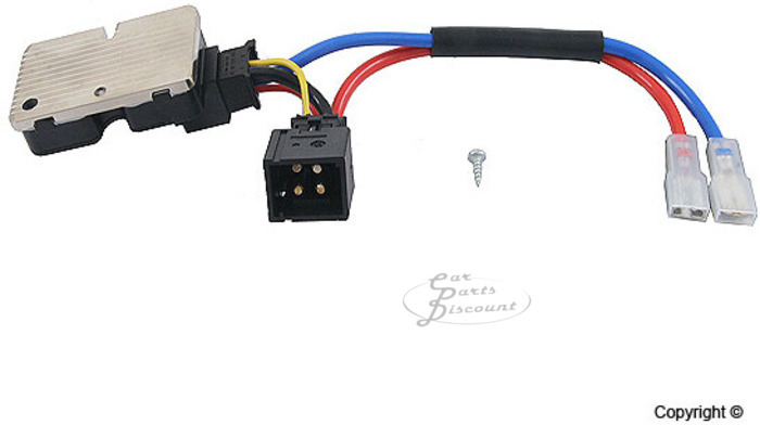

After looking and searching for the right part for me, I chose the cut and solder method to save almost $170.
I purchased the # 1408218351 for $69.95, at http://www.importecwarehouse.com as opposed to the "Plug-n-Play" one (#3.701.420) I found at http://www.kae-automotive.de/KAE_Gmb...estellung.html for 189.00 € ($238.89 at todays currency conversion). I figure I can splice a few wires for $169.94! I also ordered the 2 cabin air filters for $25.90, so a total of $95.90 with FREE SHIPPING!
I found another 1408218451 at http://www.autohausaz.com/search/pro...ber=1408218451
for $134.89, which is a BEHR.
(I hope the one I got is not a French or Chinese made imitation! I will advise...)
Please note! This is for my 1997 E320. As a note says on the Importec site, there is another one for yr 2000 + models for $119, seen on their front page, or at http://www.importecwarehouse.com/Mer...2108211551.htm
and says "PLEASE NOTE: THIS IS A NEW STYLE (for models 2000 onnwards) BLOWER REGULATOR WITH A MALE CONNECTOR PLUG, IF YOU HAVE THE OLD STYLE, PRE 2000 BLOWER REGULATOR WITH A FEMALE CONNECTOR PLUG, YOU WILL ALSO REQUIRE A NEW STYLE 2108206842 BLOWER MOTOR & 2108352740 COVER, IF IT HAS NOT BEEN UPDATED ALREADY."

Replacing a Three Wire Blower Regulator With a Four Wire Unit
1996 W210 Mercedes 300E Diesel VIN 210020 2A197603
Removed the old faulty blower regulator which uses three wires from the harness and replaced it with a new four wire unit. - see this PDF for the full story. The small red wire goes to 12V. Involves some machine work on the old heatsink.

However, a former local wrench in the Atlanta area described adapting the blower motor regulator from a W140 (S-Class) to the early W210 (The later W210 has a totally redesigned part and only a new regulator is required if your part fails). Here is my interpretation of the adaptation:
First of all lets see where the part is located. Look under the passenger side footwell and look up. This is what you will see:
http://www.bimmerboard.com/members/i...l/IMG_0900.JPG
Remove two phillips head screws and the cover can be pulled off toward the seat. With that cover off you will see the blower motor cover:
http://www.bimmerboard.com/members/i...l/IMG_0871.JPG
Remove the five Torx screws(T-20 i believe) and you will expose the blower motor and harness near the corner to your right nearest you:
http://www.bimmerboard.com/members/i...l/IMG_0895.JPG
Disconnect the harness by pulling apart. There was no locking mechanism that I could find. After releasing the harness, remove four torx screws(Same size as the cover) and the blower assembly will drop down. If you look up the void left by dropping the blower you will see your A/C filters. Check their condition and replace them if they look dirty at all. I had replaced mine recently and they still looked new:
http://www.bimmerboard.com/members/i...l/IMG_0891.JPG
Take you blower assembly to your work table and you will see the blower motor regulator attached to the blower motor with two torx screws of the same size as all the others you removed earlier. Here is a picture of the old and new regulators. I purchased mine from http://www.autohausaz.com/
http://www.bimmerboard.com/members/i...l/IMG_0874.JPG
Remove the two torx screws and cut your OLD harness right next to the OLD regulator. You will be cutting four wires: a thick black one, a thick blue one, and two thinner yellow and red ones:
http://www.bimmerboard.com/members/i...l/IMG_0881.JPG
I stripped most of the black sheath covering the three wires on the OLD harness to give myself room to strip the insulation off of the three wires I will need to splice.
Next take your new harness and regulator. You can go ahead and connect the blue wire with the spade connector to the blower motor. You will need to remove the blue wire coming from the OLD harness from the motor to do this. Throw the old blue wire away. The OLD red wire attached to the blower motor will stay. This is what it will look like:
http://www.bimmerboard.com/members/i...l/IMG_0883.JPG
Now cut the four wires going into the NEW harness connector(Cut the wires as far away from the new regulator as possible). Note that the blue one goes straight to the blower motor so it will not be cut. You will need to cut right next to the connector box in order to leave enough wire to splice to the OLD harness. When you cut the four wires, you can discard the thick red wire. The other three wires will be spliced to the three wires (black,yellow and red) from the OLD harness. Here's how i spliced and soddered mine:
http://www.bimmerboard.com/members/i...l/IMG_0886.JPG
I then taped each wire with electrical tape, put a very thin coat of the included dielectric grease to the new regulator, and mounted the new regulator with the two new torx screws supplied with the new harness:
http://www.bimmerboard.com/members/i...l/IMG_0888.JPG
I then installed it under the dash in reverse order and started the car up. Woo hoo! It worked. Lots of $$$ saved.

There is a replacement Regulator that Bosch (German made) makes that has both harnesses, the short one that you need to splice and it also comes with a long one that is a "plug-N-Play harness. Just un-clip the short harness at the regulator and plug in the longer harness, plug the red and the blue wires to the motor and plug the box shaped plug into the system.
Now the regulator that went bad seems to have been replaced with a regulator made in France at some time. The new regulator is larger than the French one by almost twice the size. It fits and all the wires are correct. Just to make sure that all the wires got plugged in right, I compared the two side by side with the bottom that I marked "B" using a silver marker. I don't know if one can plug it in wrong but I didn't want to take the chance.
It's been a few days and it appears to be working well. Best of all, no splicing! Install is about 20 minutes without splicing. Bosch part number is 9 140 010 512 BTW, I am not affiliated with Bosch in any way, BUT I sure do like the way they think! Part runs about $150 depending on where you get it.
