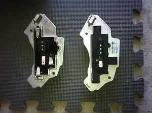

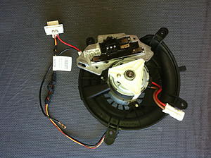

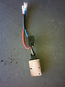

Exclamation THIS TECHNIQUE WILL NOT WORK ON 1999 PRE-FACELIFT E430
If you have a 1999 E430 (pre-facelift) that has the "newer" fan motor (plastic frame) -
THIS TECHNIQUE WILL NOT WORK !!!
DO NOT ORDER THE PART !!! I DID, AND WASTED $165.00 USD
(based on all of the responses here on this thread)
I ordered the SAME part everyone is raving about - without seeing if it would have worked on MY E430..... Guess what?
IT DOES NOT FIT - NOR CAN I FIGURE OUT HOW TO MAKE IT WORK !!!!!
Here's what I have:
front view
rear view
Here's what I ORDERED - BASED ON ALL OF THE GLOWING FEEDBACK ON THIS THREAD...... the S-Class Blower Motor Regulator
front view
rear view

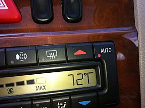

My Climate Control Unit is missing part of the "F" on the far right side of the screen
My AC starts when I star the car - the AC runs for about 45 seconds to 2 minutes, then totally stops - no cool, no fan activity - nadda !!!!
The AC system starts and stops with no rhyme or reason - sometimes, when I signal for a "left turn" - the system will start up and run for a minute and a half, the it dies again - nice ice cold air when it does run - it's just right now i PHX - this is NOT FUN !!!!!!
I have posted my problem on a separate post here on this W210 forum with lots of views, but only one response.....

Your blower motor and regulator are the newer style. If the resistor was your issue, all you needed was a replacement resistor, probably at around the same cost. As far as your climate control unit goes, I'm going to go out on a limb and say that the board inside probably has some loose/cracked solder joints, corrosion, or some other defect causing it to behave erratically.
Edit: I didn't read the last bit in your previous post. I'm totally stumped. Perhaps someone has some wiring diagrams for the climate control system? That'd be extremely beneficial. I'll look tonight to see if I still have them.

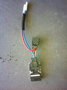

Just went ahead and repaired my friend's blower using this method. I can't stress how important it is to make a good, solid connection, and protecting it properly. Shrink tube is almost a must. My friend's previous attempt caused electrical tape on the ground wire to melt slightly, as he cut away a lot of the copper.
Early W210 Blower Motor Regulator Replacement DIY Here...-2011-07-24_10-35-12_420.jpg

Here's what I finally found out when I tok my wife's 1999 E430 in to an Indie mechanic:
There was an UPDATED fan in 1999, along with an UPDATED Blower Motor Regulator - that looks a lot lke the blower motor regulator with the zinc fins that I originally got -
The one on the RIGHT is the UPDATED BLOWER MOTOR REGULATOR.... (the one I was supposed to have in the first place
The one on the LEFT - is that one that came with the car (purchased used in December of 2010)
Once I installed the correct blower motor regulator (the one on the RIGHT) the fan worked fine......
Problem solved..... for MY situation
Best
kevin
