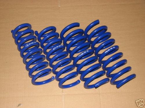

I have received contact from Ken at Lorinser USA and they DO have the lowering springs for 4Matic. However, they only have the springs, not the shocks. I asked him about a picture of the springs and if I had to modify the front suspension. Apparently, the front suspension on a Euro-spec 4Matic is different than a US-spec 4Matic; hence, the modification.
For those that aren't familiar with the springs on a 4Matic, I've attached a picture. The front is a little shorter to accomodate the front axle via a bracket. The fact still remains: no shocks for the front. Second picture attached is a set of Brabus 30mm lowering springs for 4Matic. The modification comes in when trying to keep the spring perched on that grey platform at the bottom of the spring in between the bracket and spring.
I'm a bit befuddled as to how to resolve this problem. I'll know tomorrow as to whether or not I want to drop the money on this set of springs. Will update as needed.
