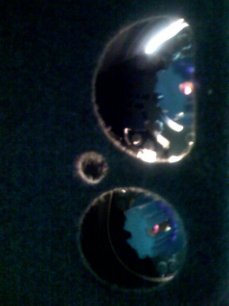

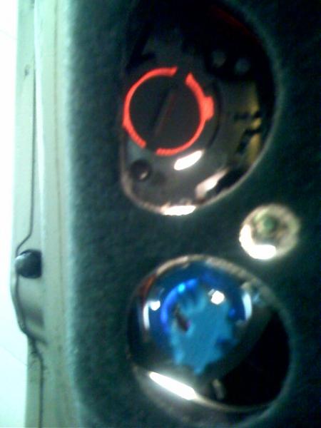

Whenever I'm driving with my fog lights on (two clicks) I've been told i had an obnoxious brake light that never went on or off, just shone brightly. After inspecting I noticed that the left inner brakelight/reverse has two bulb sockets with two bulbs. Yet the right side only has a bulb in the reverse light and what seems to be a plastic placeholder in it's place. I searched around and found some similar threads but I don't think they address this same exact issue.
Here's pics to explain...Sorry for the quality i was messing around with my new phone.
BTW: I'm in reverse in case you were wondering.

rear fog light is one side *only*. this is by design. no worries. you know how
to turn this bulb on, yes? look at your headlight switch. turn 2 click, then pull 1
click to turn on front fogs (plural).....and pull 1 click again for rear fog (singular)
