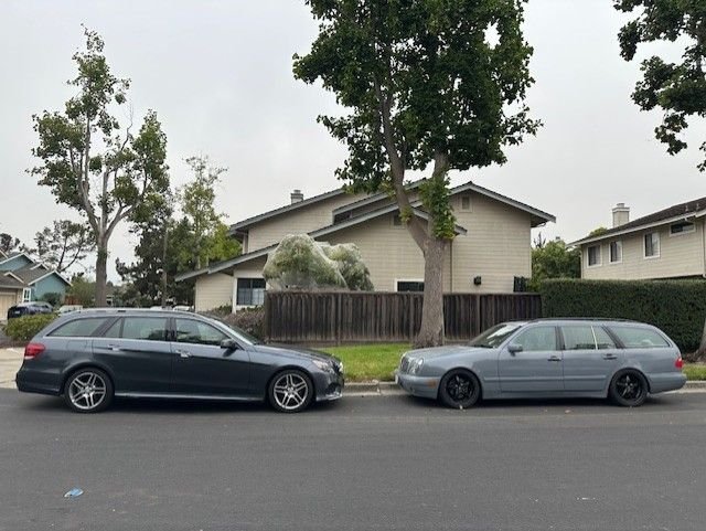

Well, after 20 years of ownership and 382K on the odometer, it is time to retire the W210. Her engine and transmission (rebuilt at 200K) are strong and healthy, but the rest of her need work (second set of accumulators are done and need to be replaced, tires are worn out, rear subrame bushing needs to be replaced, AC needs to be overhauled, exhaust leak, won't pass smog for a variety of reasons). I am in the process of selling it back to the state. If anyone is in the Bay Area and would like to update the look of their car for free, here's your chance (headlight swap... they point a little lower and don't adjust... wheels... curb-damaged and tires are shot). Let me know.
