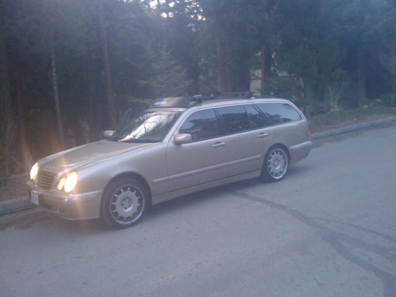

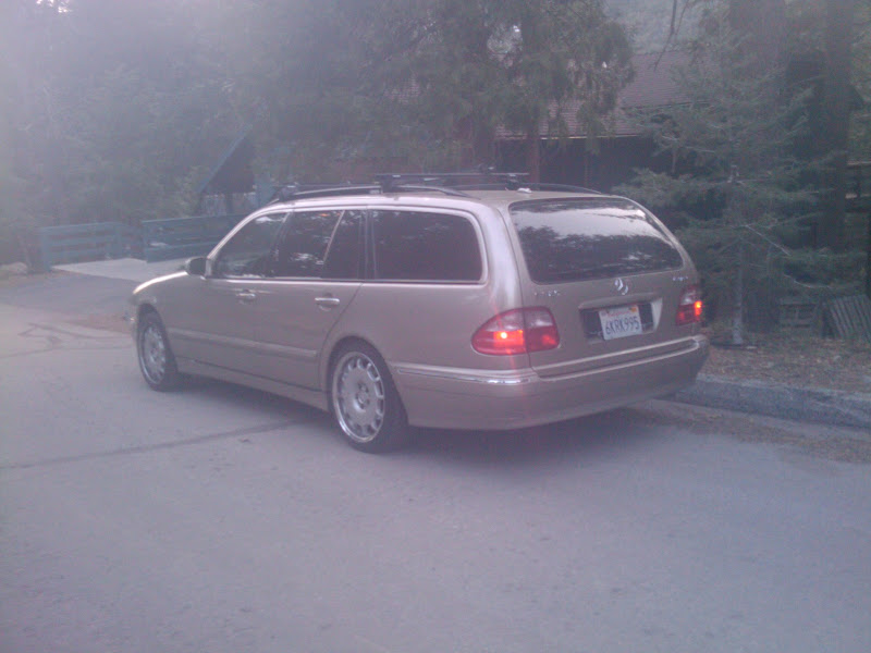

Old 03-30-2010, 08:23 PM
Ungarisch's Avatar
Join Date: Mar 2010
Location: Hollywood, CA
Posts: 291
Received 49 Likes on 35 Posts
Tectitgrau S210
Guys, I'm in the same boat, I need to lower the front so it sits even with the rear, I'll be cutting the springs in the front within the next week or 2 as soon as I can find a proper spring compressor.
heres how it looks now, I HATE the reverse rake, the trunk is empty...
