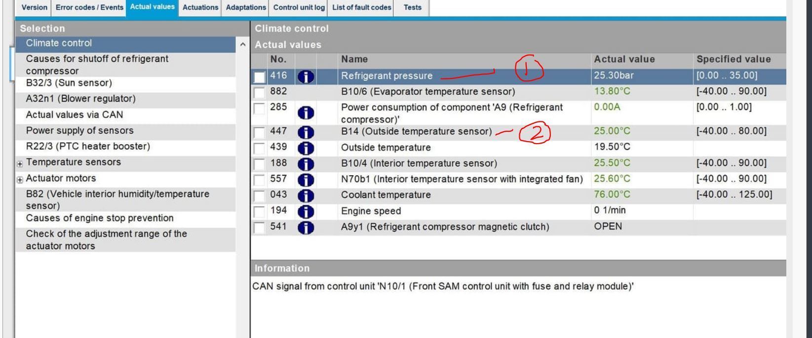

Hey all!
I have a E250CDI (212.082) Blue Efficiency 4Matic 2013 that all of a sudden started running the radiator fan on Full. This happens everytime but only when the engine is running.
Fuse 22 in front SAM is OK.
Xentry NO codes
Xentry Pressure ACC is within Green parameters
Xentry it is possible to Control the fan speed manually 0 - 90%
As the fan i running high it is affecting the consumption as well
I have read all the "fan on full" threads and nothing is matching up to my problem, If anyone can point me in a direction where to look i would be forever grateful.

Assuming nothing been done to the HVAC system and it is healthy and this trouble appears suddenly.....................
99% culprit is a defective refrigerant pressure sensor reading fake high. Fake high ref-press reading will make ECM speed up the fan to avoid over pressure of HVAC system.
In order to prove it, very simple :
Cool down engine and engine bay at least 12 hours, to make it back to ambient temperature including engine coolant temp.

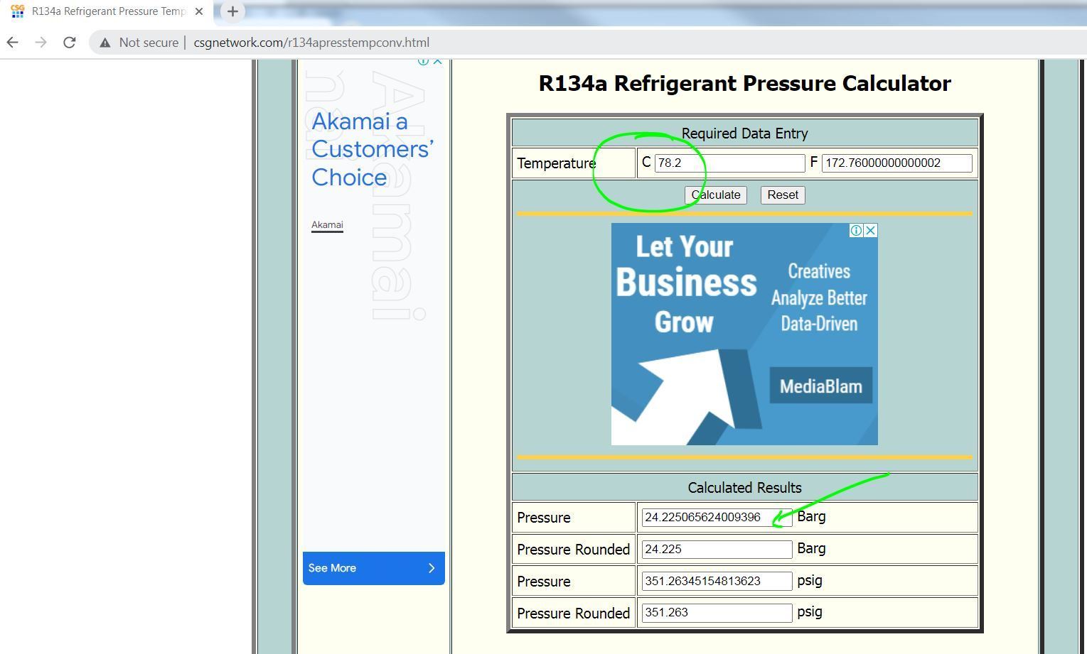

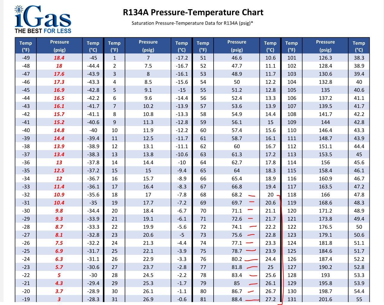

And use this chart below to compare the R134A pressure reading at your Xentry #1 in red , based on the ambient temperature, which you can use the one in your bumper the B14 #2 in red.
Difference of 1 to 1.5 BAR between MB sensor to the chart is acceptable.
Convert the PSI to BAR, divided by 14.5.

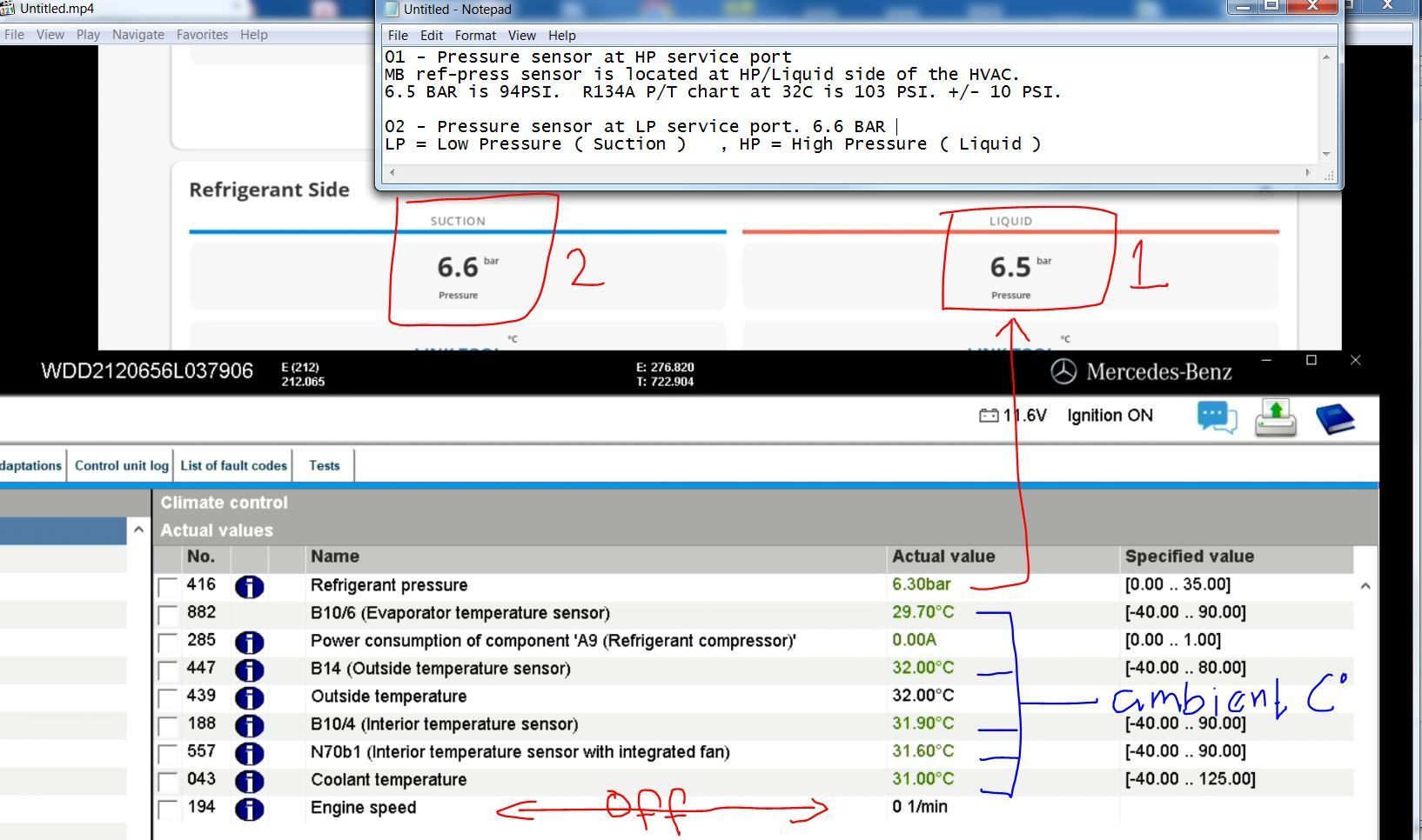

I give you an example of an engine and engine bay at ambient temperature, see the R134A pressure at the LIQUID ( High ) side and the Xentry one.

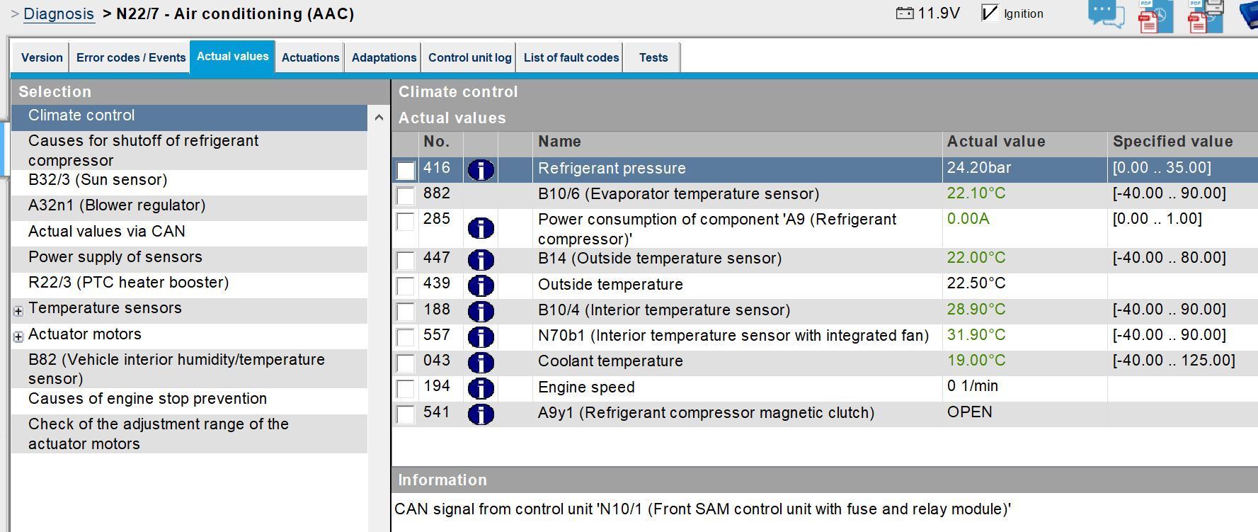

This seem way too high, am i right?
(engine off for 12hrs)
Old Jul 19, 2024 | 05:45 AM
S-Prihadi's Avatar
Joined: May 2018
Posts: 6,600
Likes: 6,547
From: Jakarta-Indonesia
YES, that is way too high if after 12 hours engine shut down. It is then 100% guaranteed your Ref-Press sensor gone bad.
Its common to fail at the age it is now, it lives in a very stress state/location.
Your R134A is like being at 78C...... ambient temp

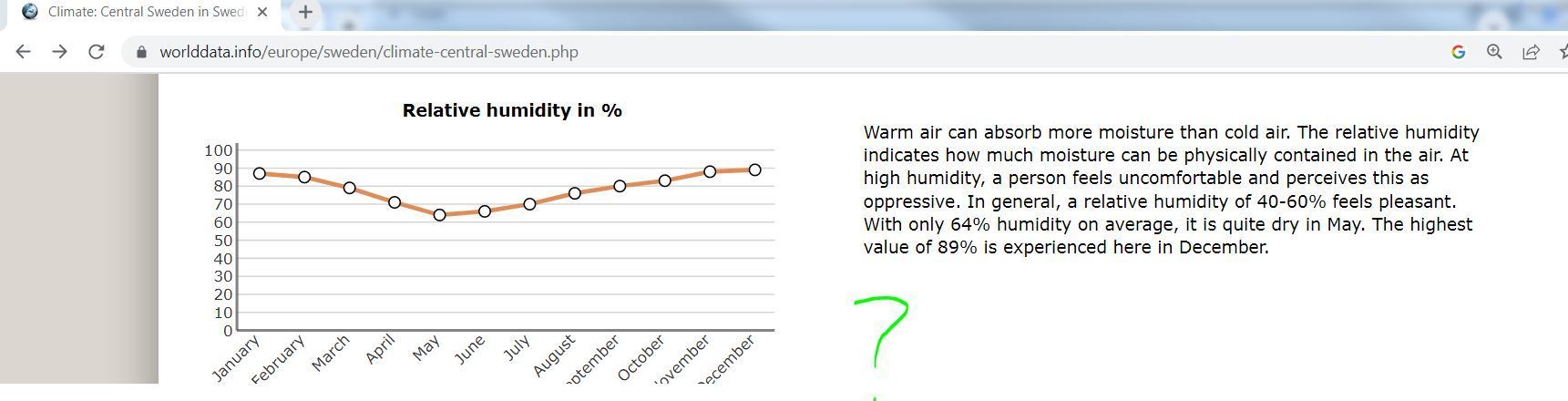

Is your humidity this wet in Sweden ? If so, Dang.... this is like in my tropical country.
https://www.worlddata.info/europe/sw...ral-sweden.php
One word of advice, make sure the vacuuming process is minimum 2 hours or better if the so called HVAC Pro, has stand alone micron sensor like me to see proper result at HVAC system and not
at shop RRR machine manifold.
Those RRR machines are piece of sh-iet for their vacuum pump size and super long small 9/16" hose is bad.

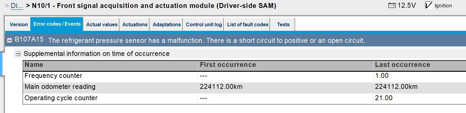

Still not replaced yet, I got a hint from the sensor yesterday though.
No CEL but i ran Xentry and found this stored.
Old Aug 1, 2024 | 05:20 PM
CaliBenzDriver's Avatar
Joined: Apr 2019
Posts: 11,923
Likes: 6,776
From: Silicon Valley
W212 MY'14 M276-3.5NA @75kMi
transient fault
Armed with that solid info...
go visually inspect the look of sensor connection to harness.
Is it Oxidized By Moisture through connector ??
Seal connector with RTV silicone ASAP .

Stored code for the ref-press sensor can happen when and if you disconnect the said sensor connector while engine computer was not totally DEEP sleep yet.
It is a STORED DTC right ? Not CURRENT.
DEEP sleep of our typical W212 gasoline modules version will be 6 hours after car use.
If car been un-used 24_ hours and you open the door, modules will wake up to, but will go to deep sleep much faster like less than 15 minutes.
