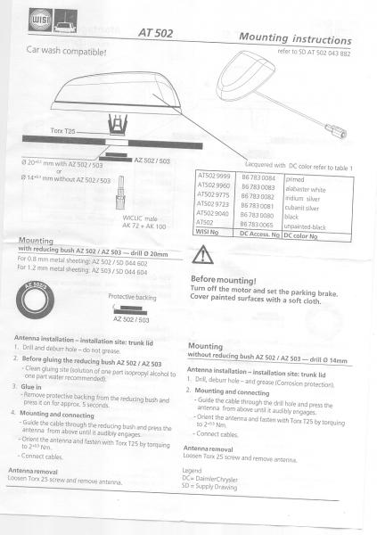

The cleanest installation would be the antenna used on W211 for the first few years. I'd mount it in center rear of roof just far enough forward to clear the liftgate, i.e. just behind the phone/nav antenna if you have that. These are (perhaps "were") available prepainted in several OE colors and there's a primed version ready for painting your color.
In case you can't read the part numbers on the attachment, they are in the form B6 783 008x
